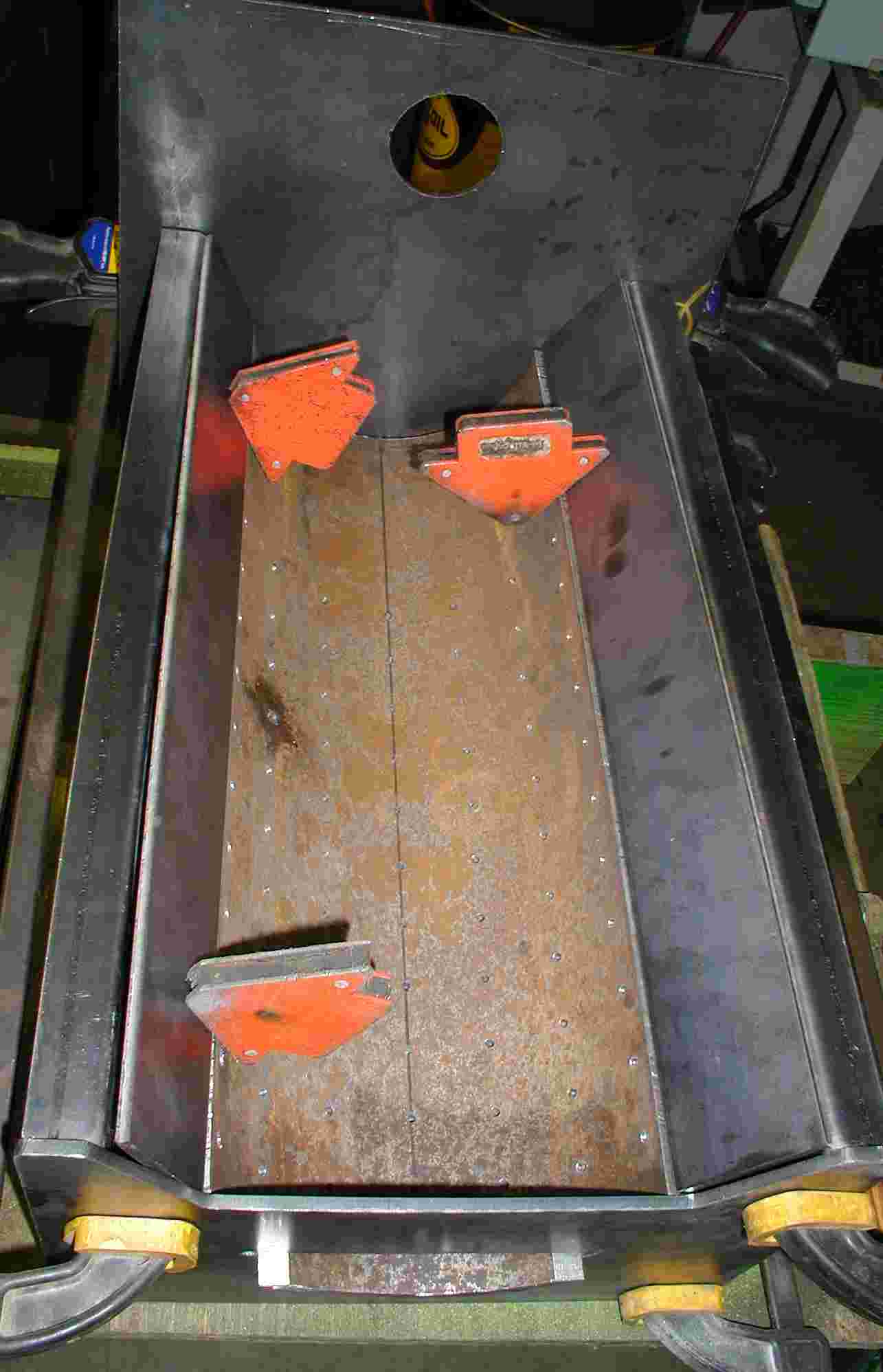

I started one two weeks ago. Been planning for a year, but had other projects in the way. So here is the progress so-far. The trough is cut from 8.5" diameter 3/8" thick pipe. 3/16" diameter holes drilled for air inlet.

Here is the housing for the burnpot assembly. This channels the forced air inlet properly, and supports the stoker auger shafts.

And a shot of the two mocked up together.
