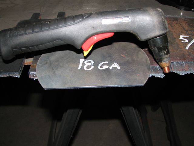

/ Copying Table? #6
My Hypertherm plasma is made for drag cutting.....and made to guide along next to a template...be it cardboard, plywood...or metal.
This one is a Powermax30....cuts up to 1/2".
Jim

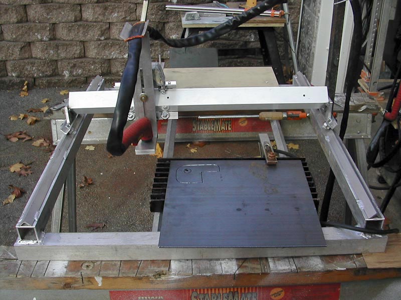

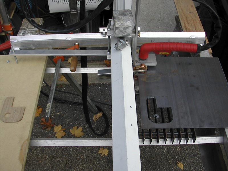

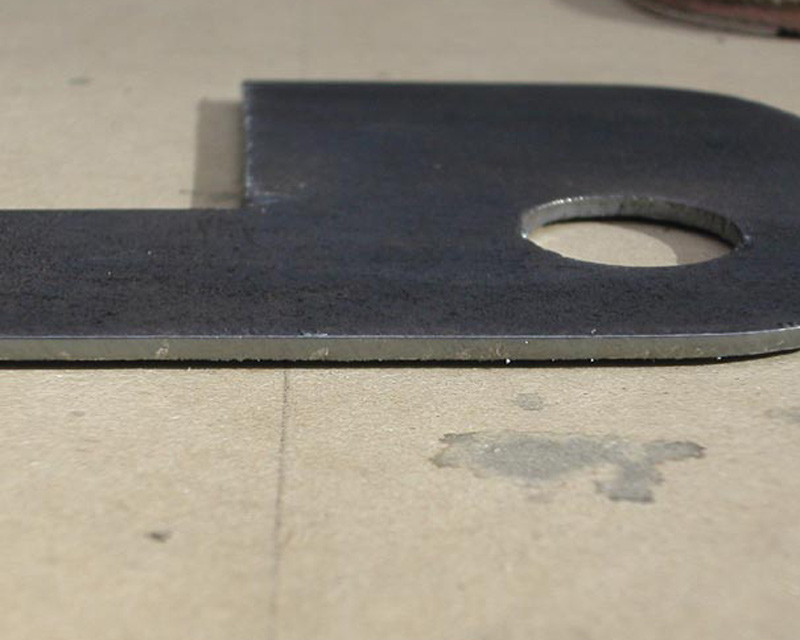

/ Copying Table? #8
This is what I made . I just make a template out of plywood and the syltus follows the shape and the parts come out very clean. It is great for smaller parts and multiple pieces.

/ Copying Table? #11
Did you make the X Y table/holder thing? Do you have plans?
/ Copying Table? #12
I made the whole thing from scratch. The size was based on what I had for materials so there are no plans. It was my first welding project for the spool gun.
The carriers were made from the bearings I got from in-line skate wheels. Surplus Center has them for 2.99 a pair which is .50 cents for each bearing.
