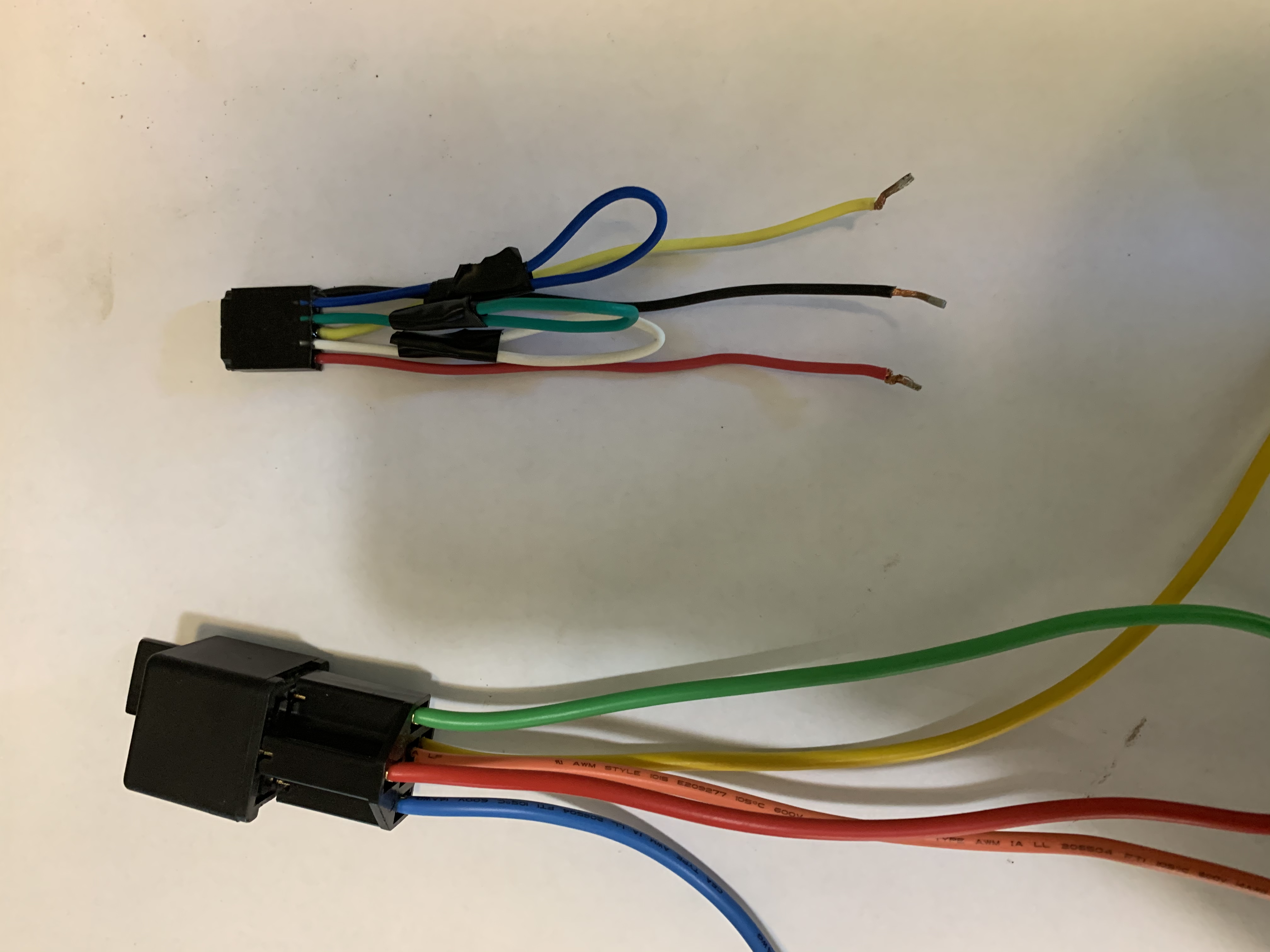

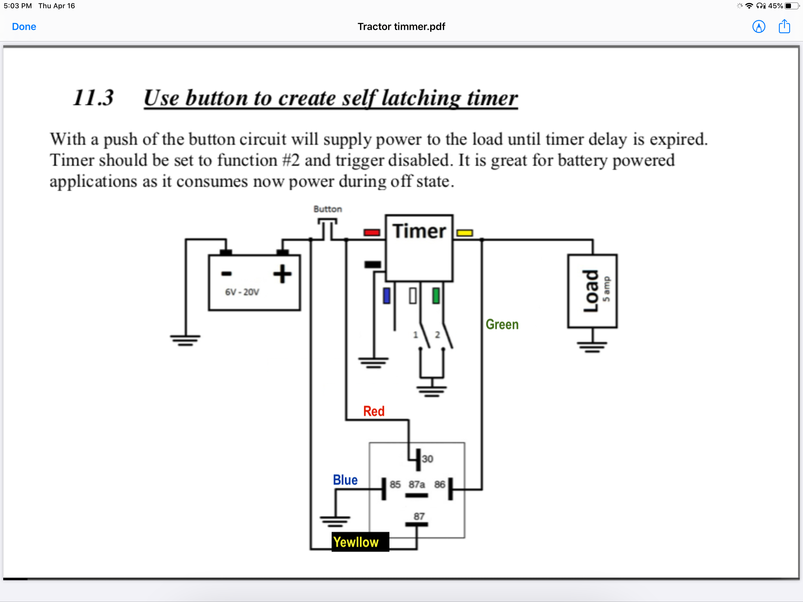

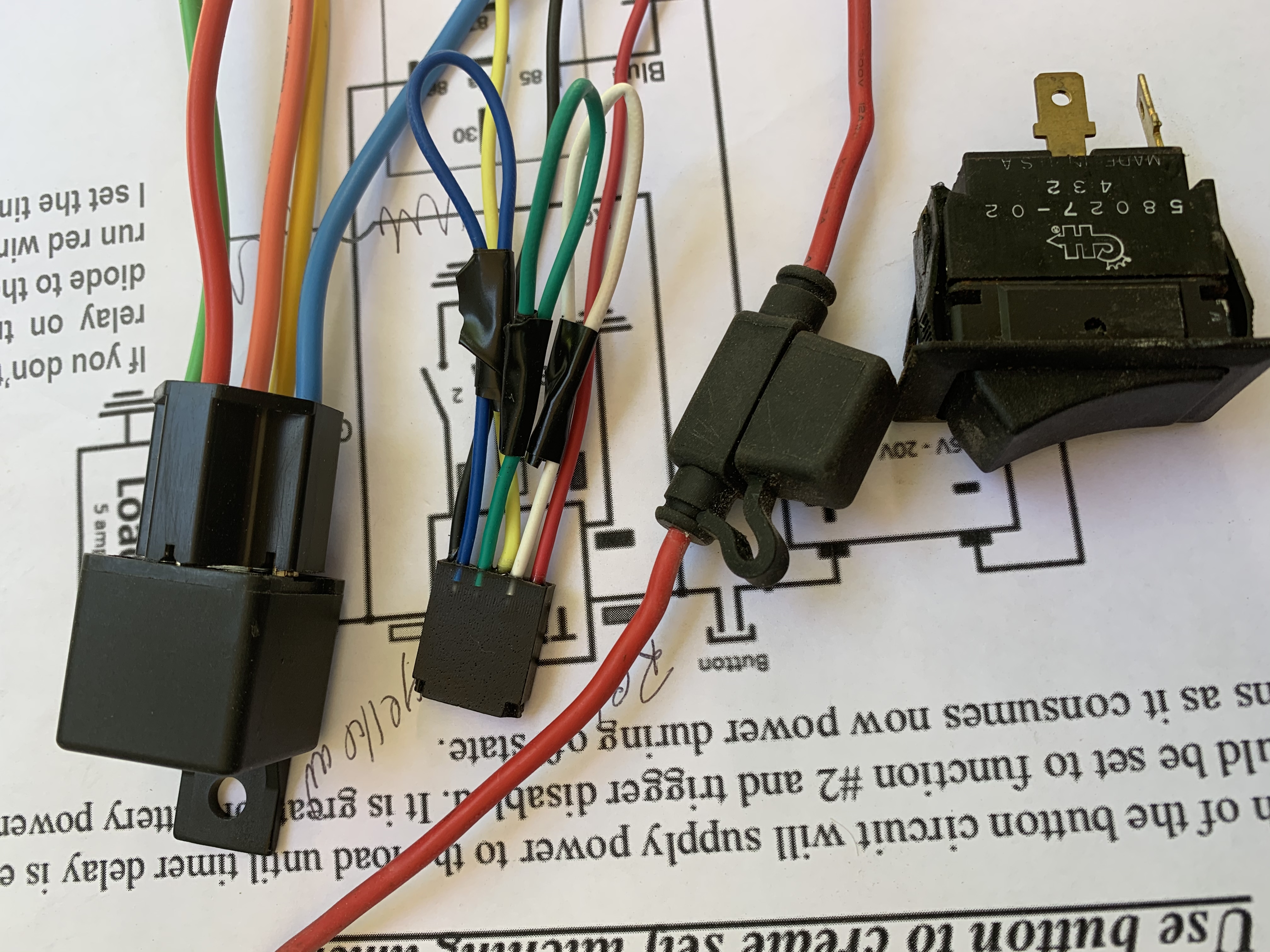

Well guys i have been bitching about having to set on my tractor with it idling from 3 to 5 min to cool the turbo down after using it hard. My son got tird of hearing me complaining and built me a timer.
Bought The timer from Documentation , this is a programable timer and good for 5A and that is all that was need on my XG3135 tractor, i used a relay and taped the timer to the relay when i installed. You can use a button switch or a spring loaded rocker switch to activate the timer. I have tested the timer and found out that any safety switch like the seat switch will cancel the timer, how i got past this is i get off the tractor go around the tractor to the ignition switch side mash the rocker switch then turn off the ignition key and timer will run the engine for the time you program in the timer.
On the timer i did not used the blue, white and green. On the relay i did not-use the orange.
Forgot to mention that i used a 5A fuse where i came off the ignition switch for power.
I see the link i posted does not work just do a search for the Timer shop on Amazon
