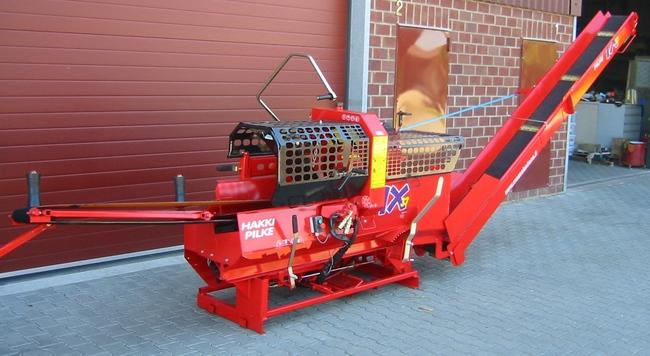

I have a Hakki Pilke 1x37 with a conveyor, the belt has a piece of angle iron every 3-4 feet with out it you will have tho keep the conveyor fairly flat.
   / Conveyor for Split Logs #10
Here is a pic to give you an idea.

dR00L1Ng, Slobbering and Green w/ Envy I am as well....How cool is that baby! :thumbsup: Take some movies and UTube it when you get going my friend, congrats, AND THANX for the input!
   / Conveyor for Split Logs #12
They are very cool!! I have only had the opportunity to run a couple cords through it so far but it's make wood cutting "fun".
Here is a you tube link, not mine but the same one!!
[ame=http://www.youtube.com/watch?v=7V7e8h_tQgk]Hakki Pilke 1X37 BDLMachines.com Firewood processor Brennholz Säge spaltautomat zaagkloofmachine - YouTube[/ame]
