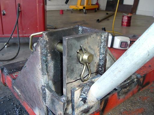

Update. The new and improved hog is all done and tested except for paint. I have three cans of chevy orange engine enamel for the job.
Here is the finished lower 3ph attachment point. I used the 7$ bimetal hole saw on the end of a hand drill to drill 4 of these holes. They aren't perfectly aligned but they don't need to be. The 15/16" hole saw left a 1" hole since it isn't exactly a precision instrument.
This picture also shows the lower attacment point of the top link structure. Note that I had to assure clearance for the cotter.

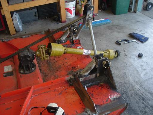

Here it is getting test fit and finishing welds. The galvanized bars are 1.25" diameter G8 bolts that are used for luminaires. The TL structure can be much weaker in my revised design hog. I didn't get it totally straight but I was going freehand and alignment isn't critical here either.

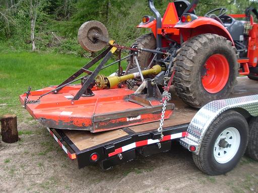

Here it is in transport mode on the tractor/trailer and at the property where the grass was nearing knee high. I stained my trailer deck too. Really lik the difference.

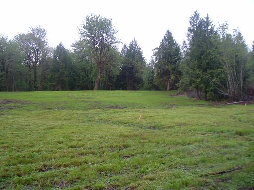

It worked.
I noticed a little more slop in the hog since it is now freer to move side to side a bit on the pins. The PTO shaft has u-joints so I can't see that being a problem. I mowed my entire wetland and grass area in about 4 hours before the rains came. The mower is now resting in the container onsite. Plan is to go out there tomorrow to box blade some of the lowland and then paint the mower.
Here's an after shot of the field.
Thanks for reading. I'll probably post again after paint.
