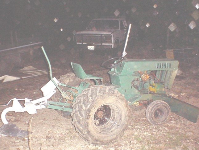

Anyone converted a manual 3ph to hydraulic or added one to a tractor that came without.
   / Converting manual 3ph to hydraulic #2
This whole tractor has been a low budget job...$400 for everything!!
I wanted to mount the cylinder under the axle with an "L" arrangement but that didn't happen.I need to make a top link that'l go around the cylinder yet...mind you..it ain't done and it sure ain't purdy...

Plenty.. Including one that used one of those 12v hyd power units to power a small lift cyl the that turned a rockshaft using a piece of pipe as a seat for the shaft. The rockshaft lifted two fixed upper arms. then they had lift links to lower arms that were fastned to a lower bracket.
I've also seen a similar setup to that on a garden tractor, using a bottle jack as the lick.. and the handle stuck out between the seat and fender for the user to manuall pump the bottle jack up.. an extension was added tot he drop valve so that it could also be reached convieniently.. That one was the neatest looking one.

Thanks Soundguy, saw one on a new consctruction tractor, just had a cylinder laid on side under floor board.
Here's a shot of the manual.
Also a shot of manual blade linckage.
#9
And just an idea of how small the tires are.
   / Converting manual 3ph to hydraulic #10
Cleatus I had one of those that hte handlewas beaten out of so I used a convertibles hydraulic roof pump and an out board motor cylinder. I had one customer mountasmallhydraulic highspeed worm drive motor in his andle with asprocket and chain. bvoth setups worked pretty good on the little tractors. What kind of tires are theose Ditch Witch?
