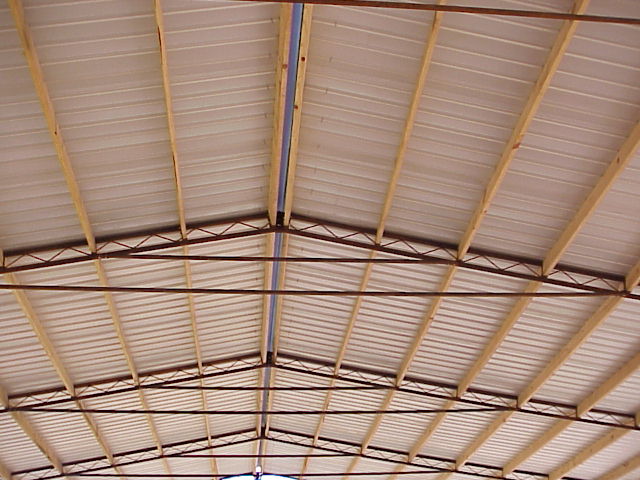

Pic of trusses that were set with boom pole and tractor

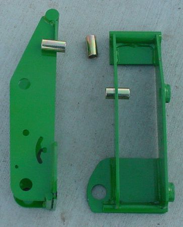

   / Converting J.D. 70 loader to Quick Attach?
#37
Hardware needed on tractor side.

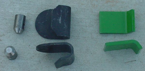

#38
Hardware required on attachment side, plus here's where I'll need a good welder..
   / Converting J.D. 70 loader to Quick Attach? #39
Gunfighter, Thanks for the compliment. Have you checked to see what a local welding shop or machine shop would charge to build the parts for you. I know we are a long way apart but I feel like those parts around here could be fabbed for less than what you paid for yours and they would be made to fit. Heck, I would build you a set cheaper than $240. There can't be much over $50 worth of material in those things. Anyway, I would be concerned about having to use longer pins. Those being an inch and a half wider than yours means you will need longer pins. Longer pins might bend when really stressed even with the bushings welded in place. It will work I'm sure, but could be a headache if one or both pins were to bend or break.
