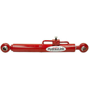

You have a hydraulic cylinder, both sides full with hydraulic oil. Both ports are then connected to each other with a valve in the middle. If the valve is closed, the cylinder is locked. If the valve is open, the cylinder will either extend or retract depending on what you need. Then you close the valve to lock the cylinder and your top link is adjusted where you need it to be.
Hey, cool!
I have the cylinder to do the job but missing the valve so I'll just add a quality ball valve between the ports.
Should be much easier than turning the darn barrel screw every time as well as being cleaner.
(have more ruined clothing caused by leaning over or reaching under that tractor)
/ Conversion of toplink #48
Hey, cool!
That cylinder is designed slightly different that a conventional cylinder. On a conventional cylinder, one side of the piston has a different volume than the rod side.
On the Hydraulink, I think they build like a steering cylinder, where the rod come out of both sides of the piston, therefore the volume will be the same on both sides.
Or since the entire top link is longer than the actual cylinder, they might use the threaded side as reservoir. For this Hydraulink to work, there must be no air inside the cylinder.
