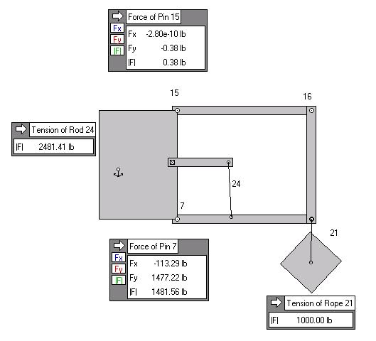

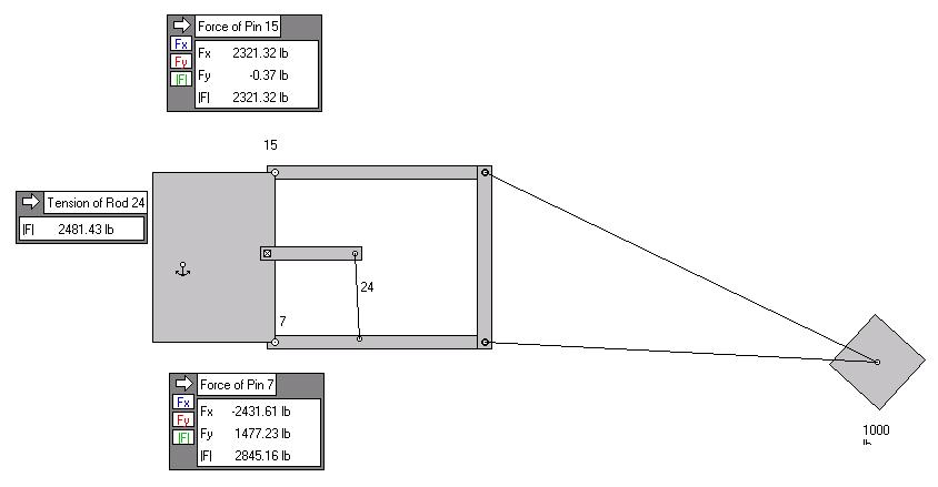

Since you keep goin' on on // linkages... here's what would happen. The tractor would break something trying to lift a remote load, or tip back. Sure the effort the tractor sees doesn't change but the moment induced by the links do! Their is a limit to the lift, even w/ // four bar links.
If anyone cares to supply actual data, such as pin-to-pin lengths and weights, I could simulate pin forces. From that I could build a model of the lower link to see where it'll reach it's failure point.
These are with a 1000 lb weight with 31" top and bottom link, 25" rear link. Somewhere about a 50" setback.

The sum of the moments can be taken from any point you wish and doesn't have to be the rear axle. If the moments don't sum to zero, things are rotating. But choosing the rear axle can eliminate one of the unknown moments.
The parralellogram mechanism that spyder brought in will and does work. He sited several examples in the real world. The lifting forces would remain the same but the tension and compression forces in the members increase with distance.

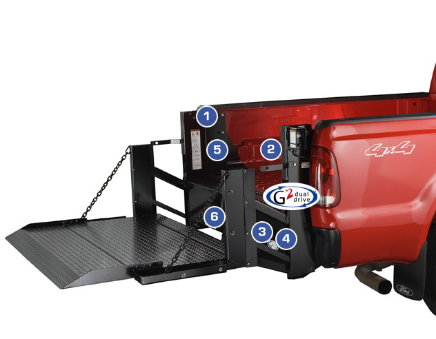

Here's one real world example of a parrallelogram linkage; a "Tommy Gate" lift that can be found on the back of pickups and trucks. It takes the same effort to lift the load anywhere on the platform. The lift effort does vary as you go through the lift distance though.
Why is this arrangement not used in 3PH? One reason could be because the current arrangement gets the implement further off the ground, such as for transport reasons.
