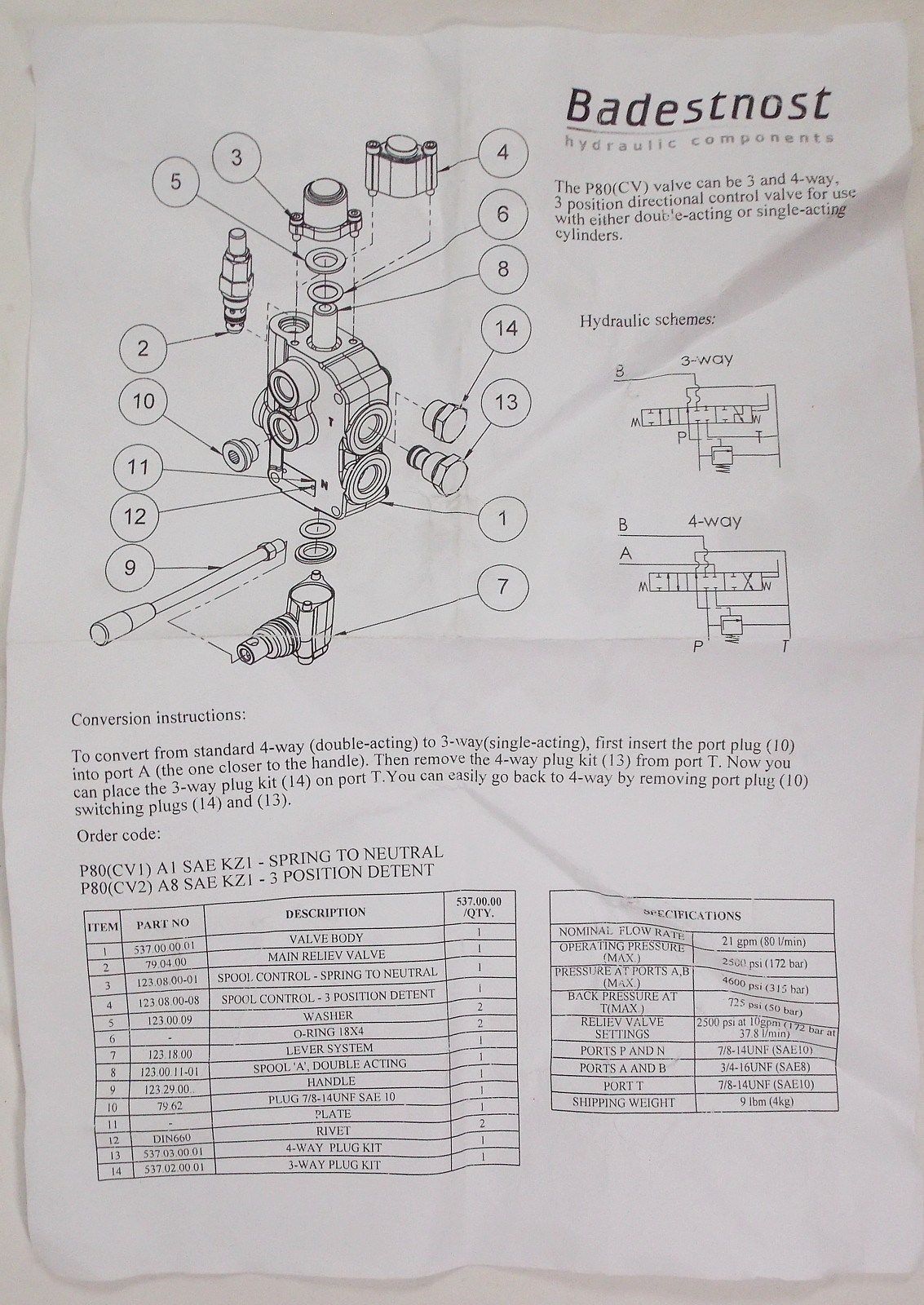

I have purchased a single spool Chief P80 (cv1) (3 way or 4 way) to add tilt control for 2 double acting cylinders I am adding to the bucket. (Building my own) The control instructions have me confused about which port to use for the tank return line. See attached "instruction" sheet. ?????
Having read some I assume that (1) I need a closed center while in neutral. This control has 5 ports. P for pressure? 2 work ports. T for tank which is plugged. Then a "N" port. Either T or N needs to be plugged. Stock, the T port is plugged.
Question 1- do I use port T or port N for the tank return? I can not make sense of the schematic/ instruction sheet.

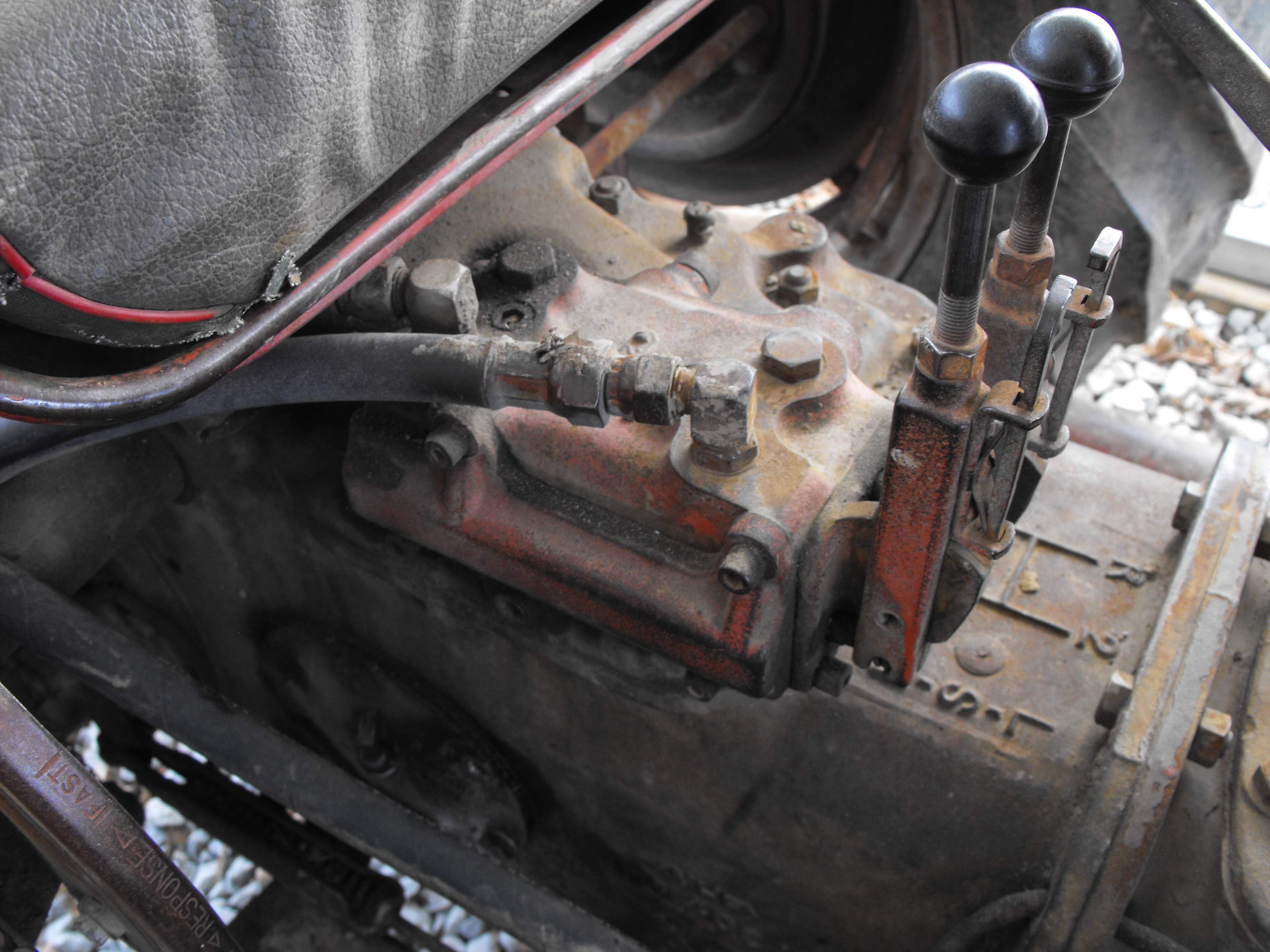

Question 2- I have read where there is a plug on the left side of the Massey hyd cover plate which can be used for a hydraulic return line. I have purchased two manuals and neither say anything about this or the 2 spool control ( apparently an add on though original).

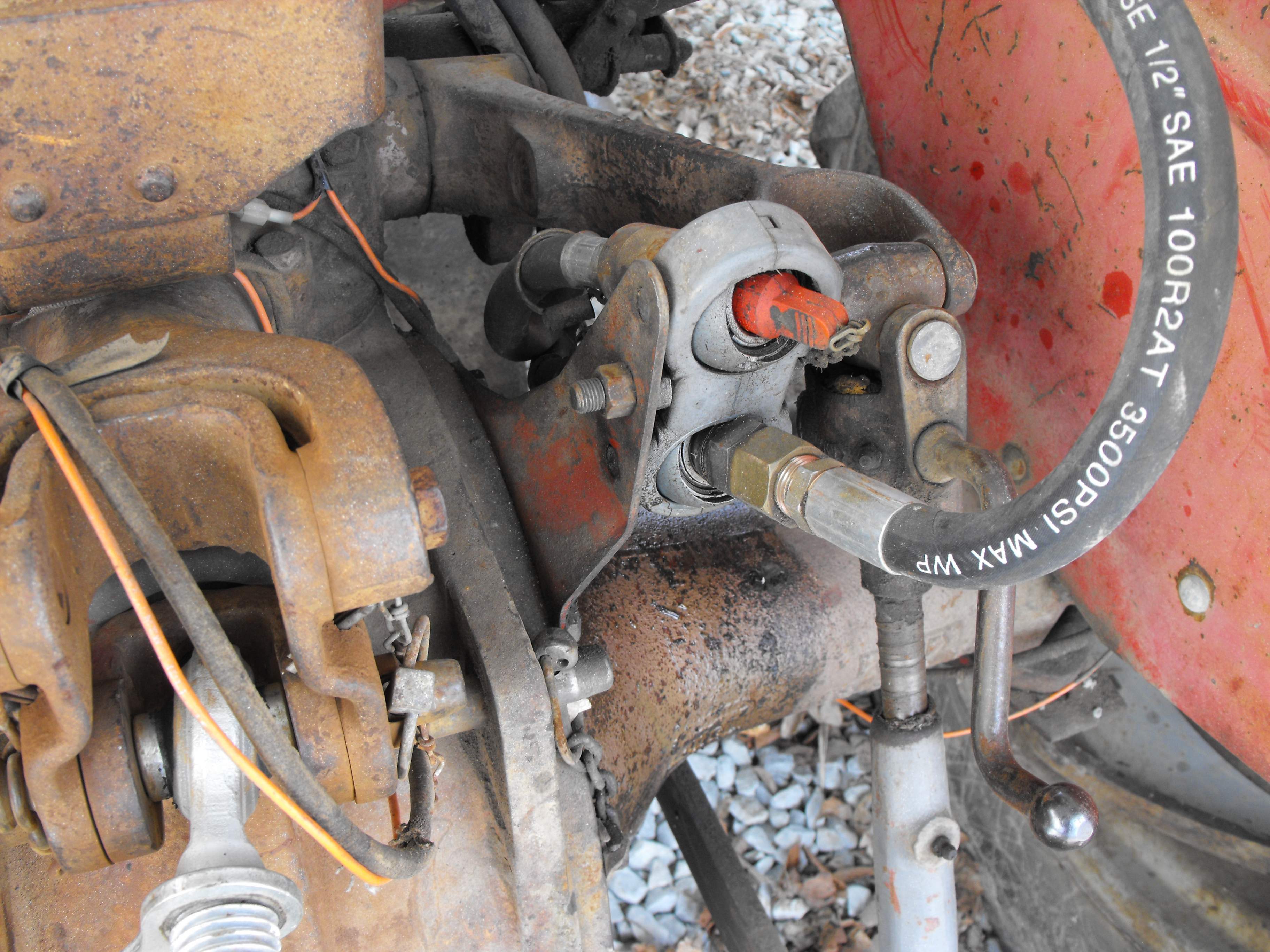

I have attached a picture of the back of my tractor. I am using both quick disconnects for one double acting cylinder on my bucket. The quick disconnects look the same.

You were correct that I do not have pressure on both rear hose at the same time. While I have used both, I did not pay attention to what way I was moving the control arm. Again, it seems that one pair reversible in parallel would operate double action cylinders leaving the other pair for single action lift cylinders. But this is pure speculation and I have hunted for an operational diagram and spec sheet for a long time. They seem non existent.

I agree that you do not have any switch valves, I discovered that on agcopartsbooks.com.
The two ports on the left hand side are plugged because that is the valve that operates the three point hitch. All oil flow is done internally, Oil from the pump comes up a tube called the standpipe into the lift cover. From there it enters the auxiliary valve, with the left lever pulled toward the seat and the right lever centered the oil flows to the control valve which controls the three point hitch. using the position lever on the right hand side of the seat, the three point can be raised or lowered or held at any position automaticly.
With the left hand lever centered, the position lever in the constant pumping position, oil is then directed from the pump to the auxiliary valve and when the right hand lever is pulled or pushed it directs oil to one of the quick disconnects. When using a double acting cylinder oil is forced on one side of the piston and the oil from the other side returns to tank via the opposite quickdisconnect and auxiliary valve. When the hand lever is moved the other direction the flow is opposite. I think you said you were a journeyman electrician in the start of the thread, The hydraulic valve is almost the same as a single pole double throw switch. the pressure line (oil from the pump) is the power wire and each quick disconnect is the load. The only difference is when power is applied to one hose the other hose becomes the neutral wire. sorta?? I am by no means trying to insult you but I get the feeling you are confused. You could purchase a 3000 psi hydraulic gage and also purchase a Pioneer male tip and install the pressure gage to it. It then can be inserted into your quick disconnects so you can see when you have pressure or no pressure relative to the valve positions, forward or back.
as for the expandable valve, good question, the right hand side has a cover plate and there must be some ports available under it to allow both pressurized oil and return flow. I suppose someone with a machine shop could build a different side plate with tapped holes so you could connect the valve you bought to it. I never thought about that.

I bought a Chief directional control to use as a 4 way closed center to control 2 double action cylinders. I posted the "instruction" sheet with the schematic. It is interesting to note that I found others who had the same "confusion" and no one ever answered the questions posed.
Look at the schematic for the 4 way operation. In the center neutral position it is closed. Flow (P) bypasses and returns to the tank.(T) In the other positions work ports A and B are also diagrammed and again return is routed to T as tank. That is the correct operation for my purposes.
Now look at the directional control valve body and you have ports P- A- B- T-and N. Nowhere is on the schematic is it shown that the Tank return port is plugged and nowhere is port "N" depicted. Thus, I posted my "confusion" hoping to find someone familiar with this Bulgarian spool and the handful of plugs they provide. I provided the function sought . No luck getting an answer. So I simply used the plugs and drew my own schematic by using compressed air to trace the control spool functions relative to the ports while operating the control lever. Not exactly rocket science but a pain. Port N can be used for tandem operation or your so called "power beyond." "P' enters and is bypassed to the pressure control valve and continues internally to T. For my purposes all I had to do was remove the plug from T and plug N. It now functions exactly as the schematic shows. It is impressive how this control can be used but the "instructions" are incomplete and wholly worthless. A schematic is one thing. Knowing the flow paths through the valve body or manifold is another. I don't connect anything until I know and the only way to tell if it will function if that info is not provided. If they are going to sell these, they should diagram everything. I looked at some Prince products and they provide it.
I used the same air method on the tractor auxiliary double spool. Of course I had to remove it. But it needs cleaned, checked, and painted. As I stated, I had a very different piece of equipment. For those that have this aux control spool and want to add another spool with it, you can...just like I thought in the beginning although not where I thought I could tap into pump flow. Yet there is a external port for pump pressure. So as a courtesy I will provide the info.
I have no idea whether this can be done with other old Massey models. I have a Massey Harris 50 made in 1957. I am the second owner. The hour meter stopped at 45,000+hours. The loader was made by Freeman here in Peru Indiana and was purchased with the tractor. It started every time this winter even in 40 below wind chill weather. While its not pretty, this old work horse just keeps going just like I plan to. The loader bucket is shot and I am fabricating a new one. Overall, the tractor has been very well maintained.
All internal valve body passages were traced from the standpipe using compressed air:
1. The left or three point spool is single acting.
2. The right is double acting. I stated that I had pressure at both rear hoses and had used both. This spool has likely been used with single acting lift cylinders for more than 50 years and has never blown a relief valve that I know of. Tracing the internals reveals how this operates and is perfectly fine for either single or double action cylinders. See pics and other info below.
3. I began by removing the side cover and as I thought, I found pump and return ports.
The center and 2 inside ports go directly to the pump. However, the center is affected by the spool but interestingly also supplies pressure to the pump cover.
4. While I had stated that I had pressure from the rear hose quick connect, I didn't but was close. On the rear of the control there is a port chamber controlled by spring loaded valve which can be adjusted to prevent or allow double action flow.
5. This pissing match came about from my belief that I could add a spool and pick up straight pump flow when I did not pose that question. Here it is. Return can be routed to the lift cover or the aux spools. This leads me right back to the original intent and question. Use a closed center 4 way 3 position directional and it will work.
While I will most likely fabricate a side cover rather than use this old one , I haven't decided. The side cover I thick and old seasoned cast iron so there is t also the possibility of drilling and tapping into the side for easier access and compatible fittings. I bench tested this and know it works.
