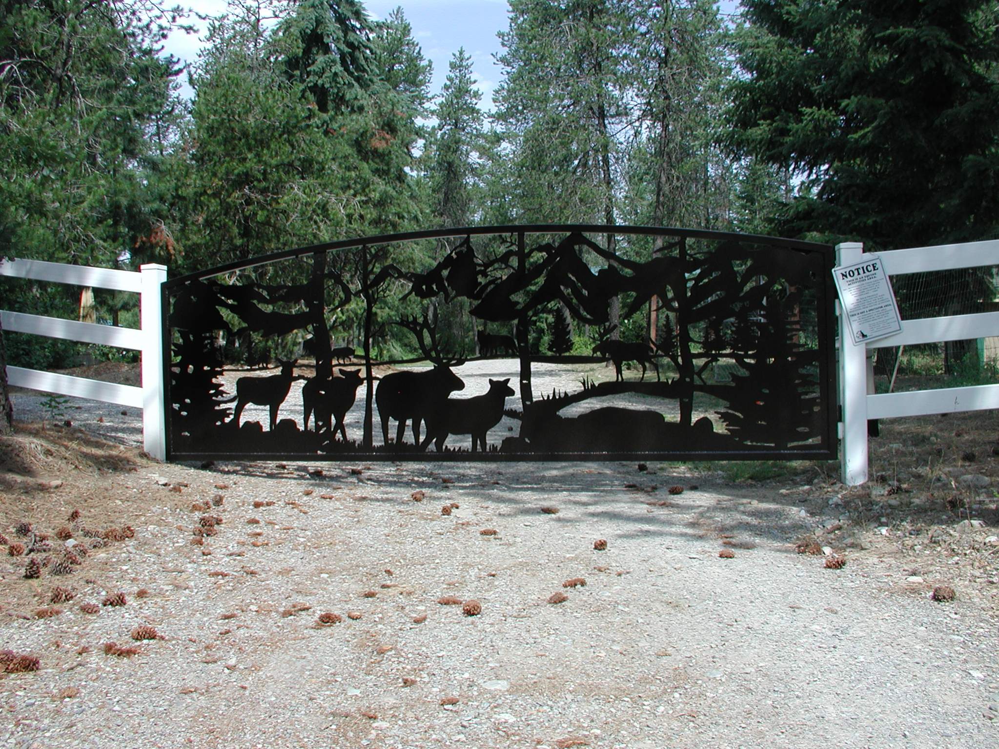

Plasma cam has been around for a long time. I ended up with a system by Dynatorch. It not cheap by any means....like in the $20,000 range. When i priced out plasma cam years and years ago i think they were in the $5k range with a 4x4 table. My system is 4x8 table. The system and software and plasma cutter set you back some real scratch. Learning to convert a picture to art ready to cut takes a LONG time. And learning how to color and prepair the finished product takes forever. im still not good at putting on a good "prety" finish. i usually just end up powder coating my stuff. About the largest thing ive made is a gate P7261326.jpg
i could not have made this on the plasma cam, but if all you want is to make signs, etc the Plasma Cam will work fine. Any machine needs a good quality cutting head plasma system. Some will use hand torches, mine wont.
