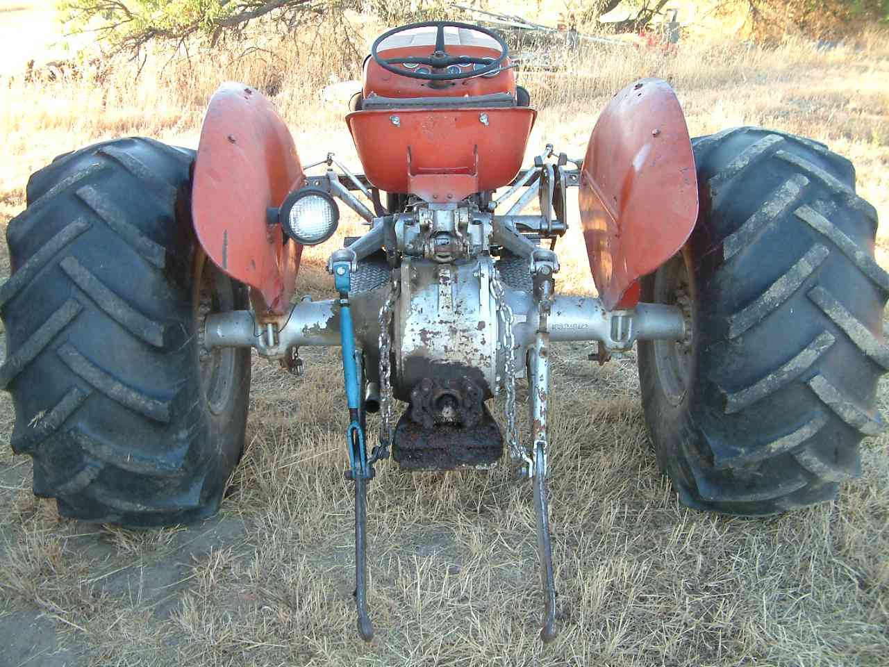

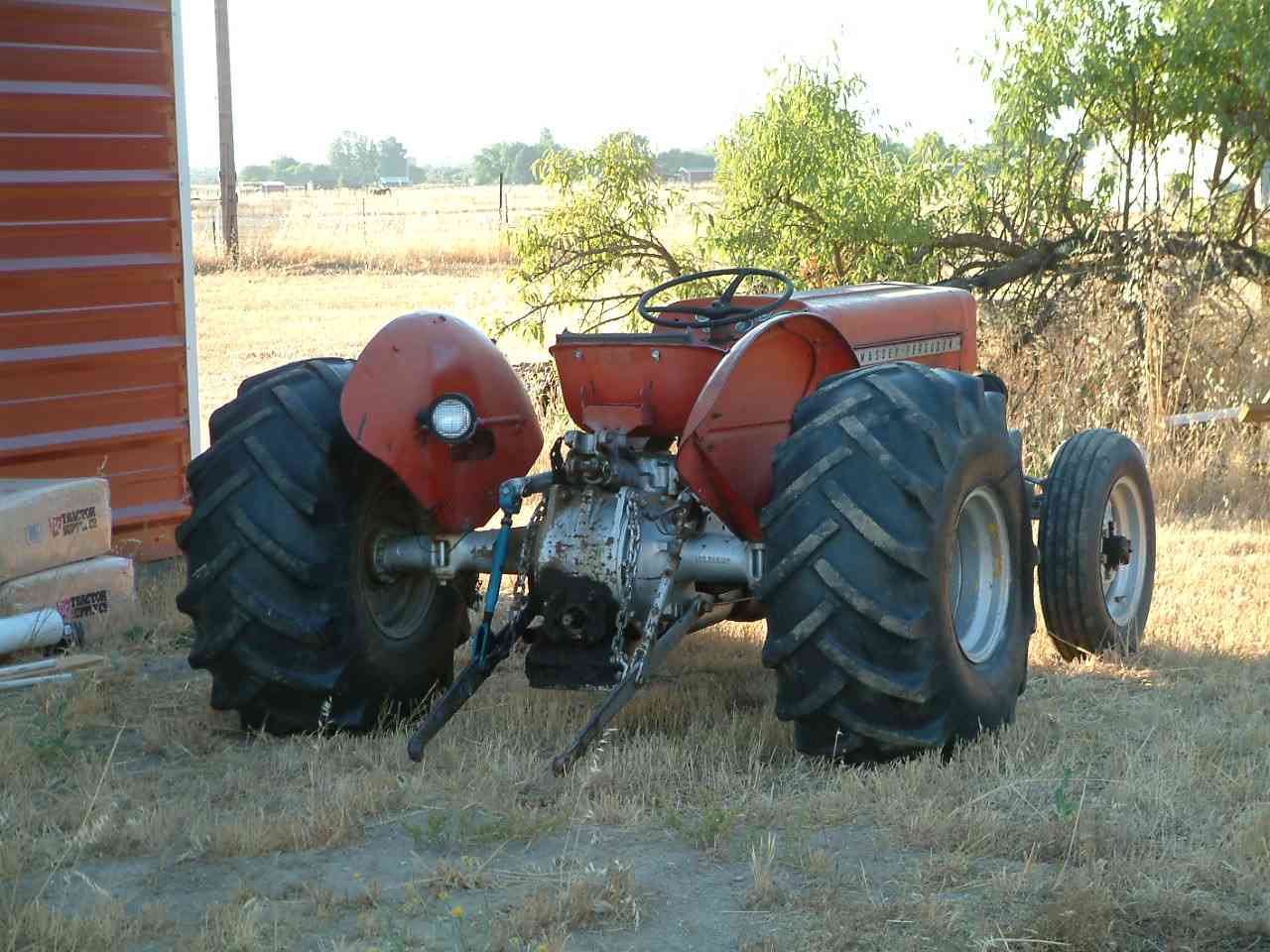

Don't know how mucky your muck land is, but my MF-135 has 18.5-16 rear tires that might be the ticket. This 135 is an orchard tractor, hence the low-profile rears, which are pretty worn, but are OK for discing work.

It is not that bad. I heared 150 years before it is bottom of lake. Right now it is totally nature drained. 10-15 feet top soil left. Thanks for your helping. Here is a picture might be telling a a lot.
