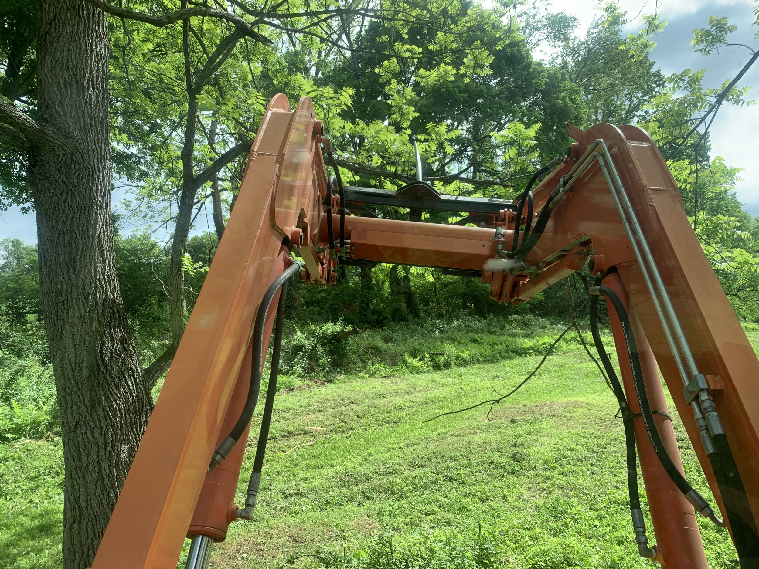

Cut 35 acres today. Loader came in handy, even with a bale spear, to knock off branches.

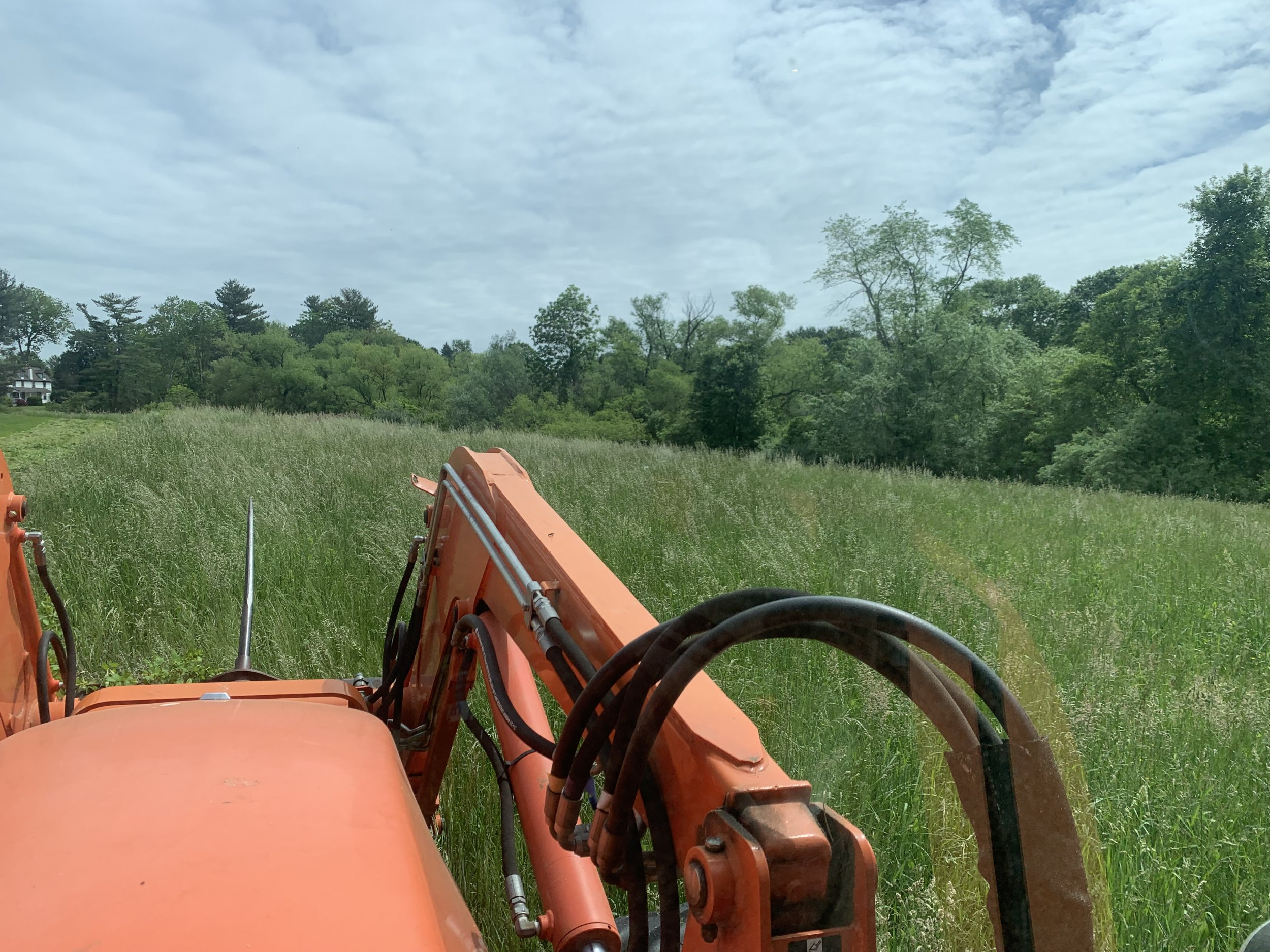

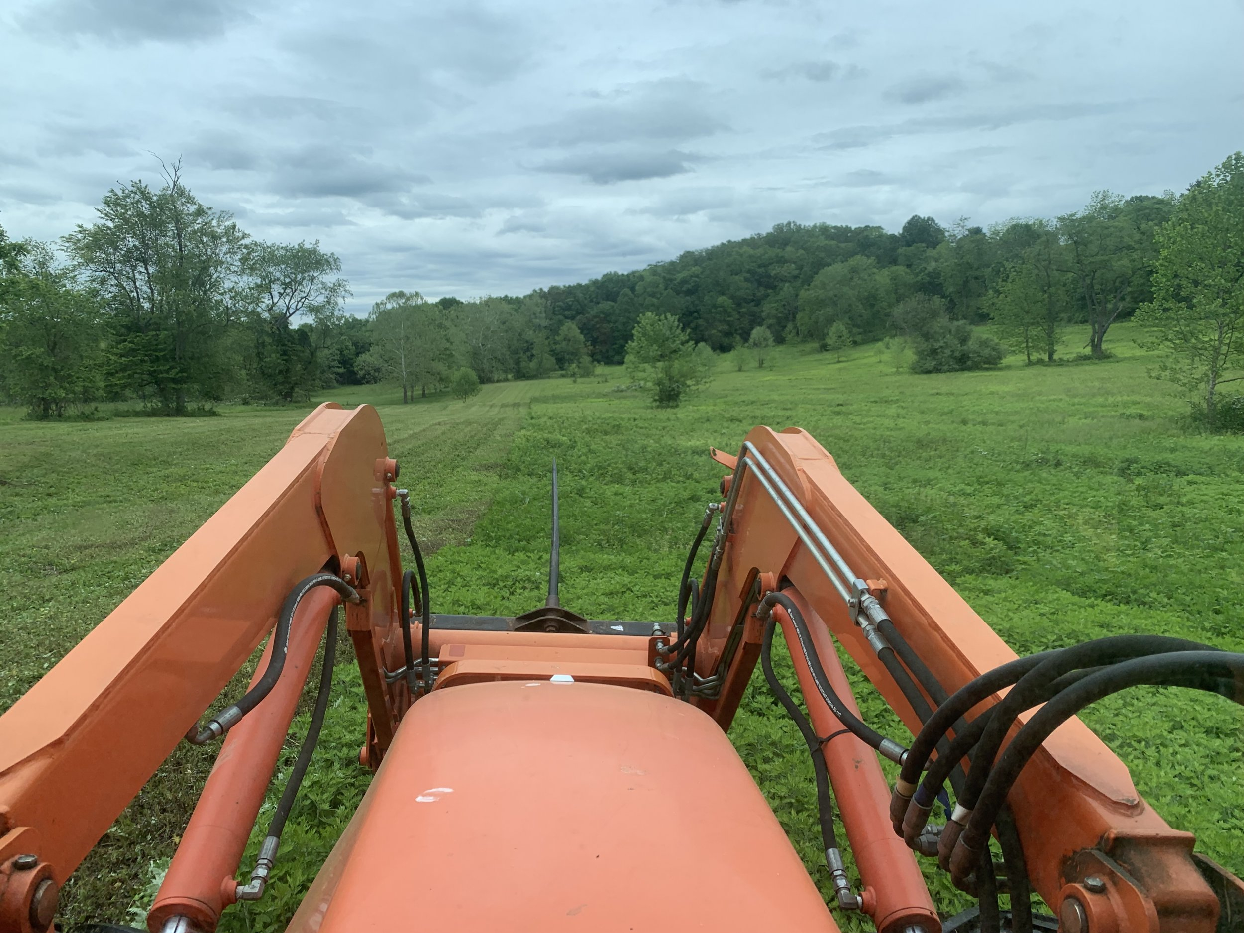

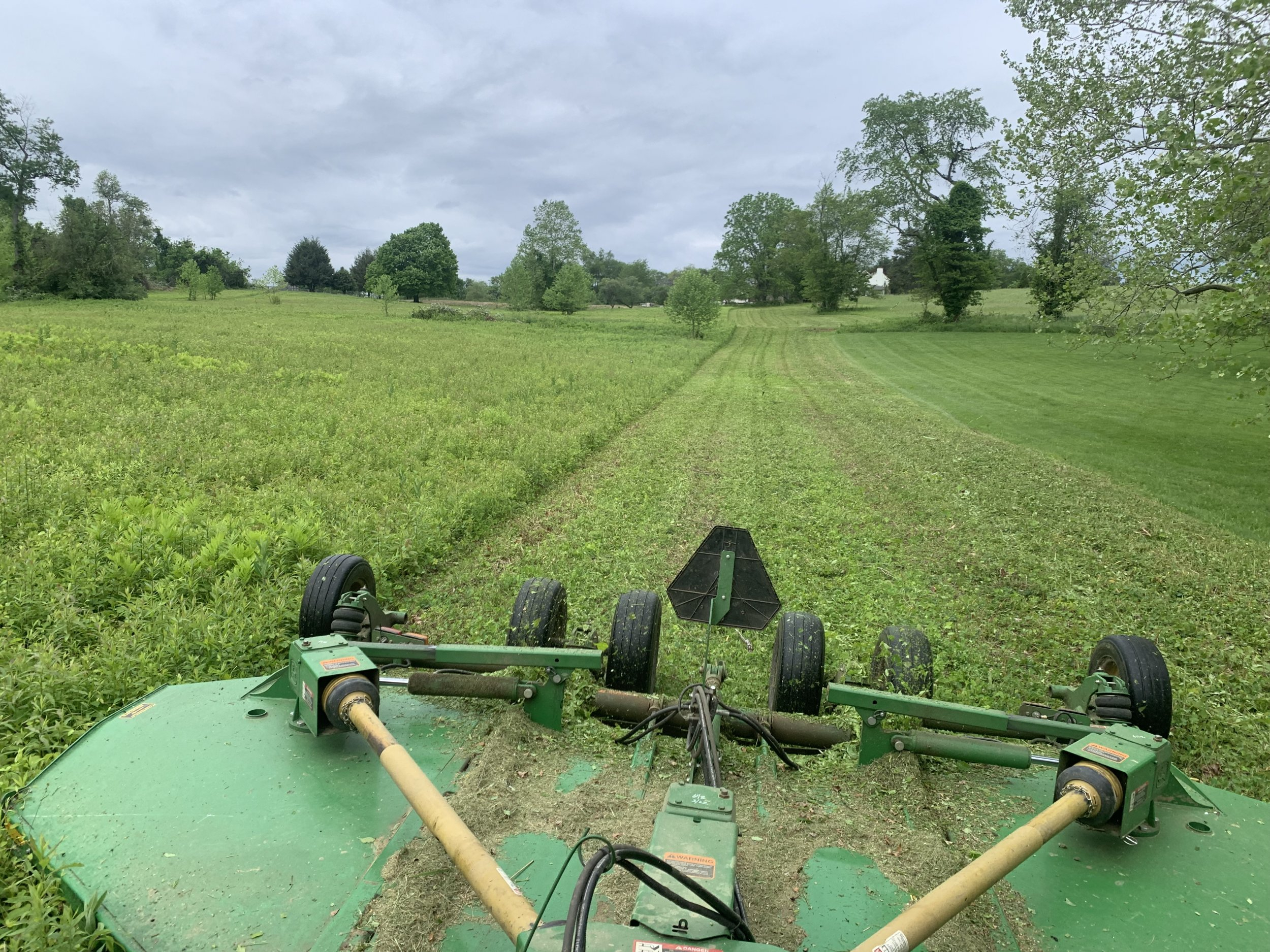

Few more mowing pics from today

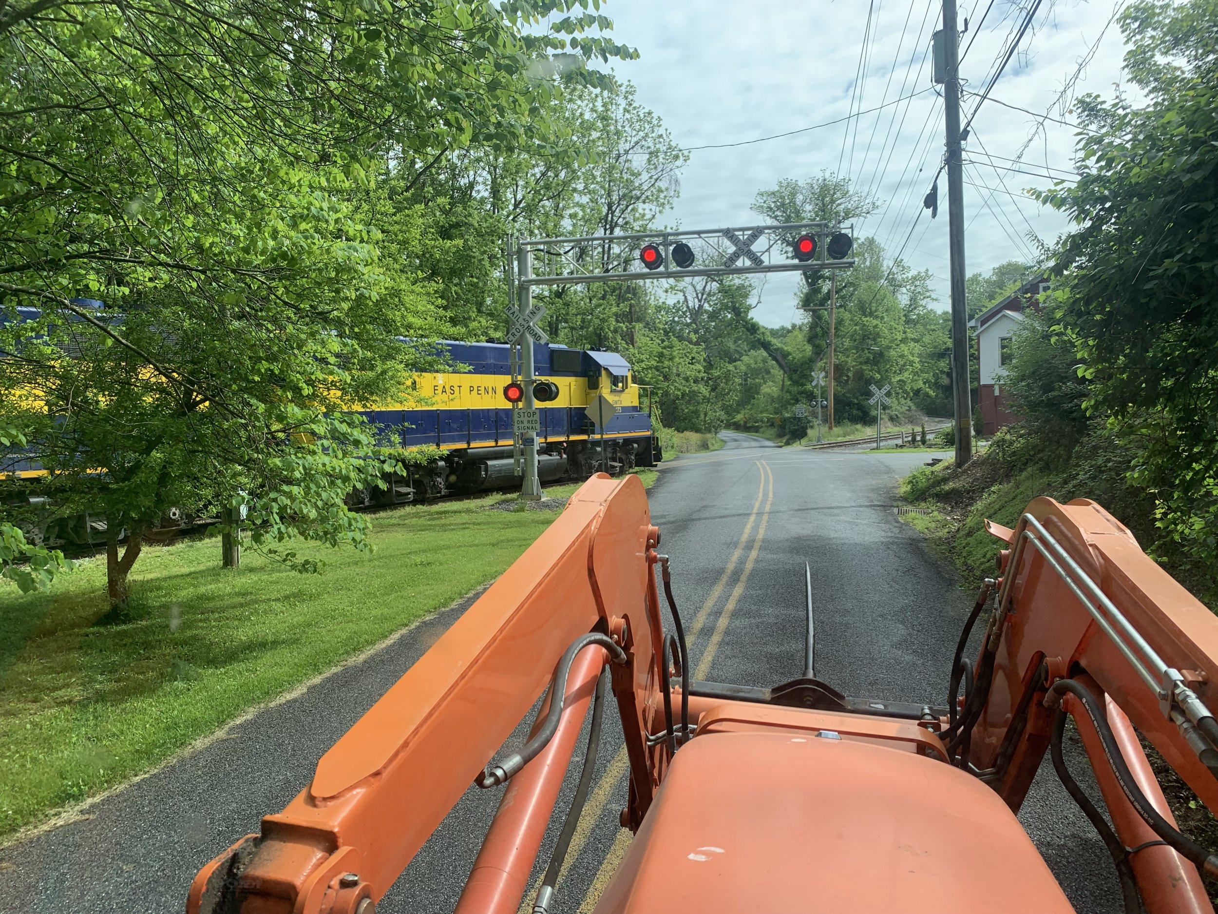

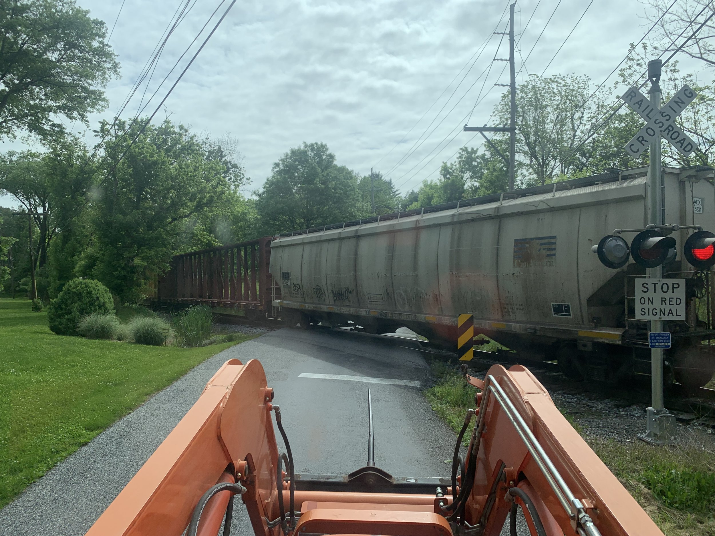

On the way home, got stuck at the RR crossing. Not once,
But TWICE.
