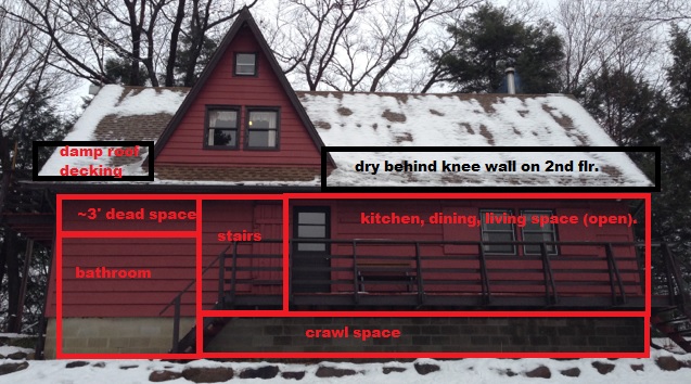

At the beginning of the month, we moved into what was previously a three season, weekend only home. The building was constructed in the early-1970's and has non-vented soffit and no ridge vent. The walls and entire roof are insulated with foil backed fiberglass insulation (all space is finished including the attic). While in a kneewall today, I pulled back some of the insulation to look at the eaves and found the west end of the building (in photos, the end to the left of the dormer) were damp about 2-3 feet up from the soffit. I cut out the damp insulation and have fans drying the areas out. There is no obvious mold, punky wood or other issues although there is some slight discoloration which leads me to believe there has been some moisture here before. It is winter (almost) and any drastic measures are not feasible until spring, so I seek any advice to get us through the winter or maybe even completely address the issue. I've attached a few photos for reference. Thanks in advance! image-3300721623.jpgIMG_3582.jpgIMG_3583.jpg

Looking at the first pic of the interior eaves, I assume you are behind a finished knee wall to the inside of that area?
That knee wall should separate the heated from the unheated area IMO. The interior knee wall would be one section of the conditioned space "envelope". What is outside of that should not be insulated and you want free air movement there too. The issue probably originates from the first floor ceiling area that is below that knee wall floor. That part of that ceiling is also an envelope barrier area.
If you put down a plastic vapor barrier on the floor behind the knee wall, then put un-faced fiberglass batts on top of that you will improve that part of the envelope. Add soffit vents to allow what makes it through the envelope to get some ventilation.
The vapor barrier for the knee wall floor really belongs on the warm side of that--the first thing on the first floor ceiling--but that would be a major project. You may see some condensation under the vapor barrier because of that but it could get you through the winter without major issues.

I got int the knee wall on the opposite end (east/right) today. All wood was dry. It appeared as though the insulation either never went down to the soffit or was trimmed back at some point after construction.

Is the wet side the dormer side? Dormers are notorious for leaking if the roof isn't done correctly.
Is the bath or kitchen under the wet side or dry side, or neither?
/ Condensation in eaves with non-vented soffit
#14
The bathroom is in fact under the damp area. The damp wood was on the front and back of the cabin although the bathroom is only on the front portion. The ~3' space above the ceiling of the bathroom extends to the room behind it. (Both rooms are on slab vs. the rest of the living space which is above a crawl space). I suppose moisture could have migrated through that ~3' space to affect both the front and back. The bathroom does have an exhaust fan that is vented through the west end wall of the building. Remember that in these two places the fiberglass insulation extended down to the wall below unlike the east end where it did not (and the wood wasn't damp). Here is a very rough layout sketch from the front:

Well, best thing to do now, with the damp insulation out, is to monitor the situation and see what happens I think.
My best guess is it is either moisture from the bathroom migrating through the 3' ceiling area, or that side of the dormer leaks. Moisture will migrate through painted wallboard, wood, etc. Most bathroom fans eventually clear shower steam but are generally on the wimpy side in terms of cfm's.
You could lay plastic down on the 3' knee wall floor for a few days, check it for condensation on the underside.

Well here we are in the spring. We decided to rip out all of the paneling and fiberglass insulation and have spray foam and drywall installed to address our issue. After monitoring and thinking all winter, I decided the issue wasn't a moisture leak but just inadequate insulation. Most all of the roof deck was frosty on the underside at times because the insulation was way weak to keep the hot air in and the cold air out, so the dew point was reached. Lots of ice dams on the shady side of the roof. So after quite a bit of research, we went with open cell foam from the soffit to the peak, including the gable end walls, dormers etc. essentially everything above the first floor. We will also be replacing all windows with Andersen 400 series. And then some work in the bathroom including foam on the outside walls, drywall, tile floor with heat below it. Definitely some $, but it's time.
