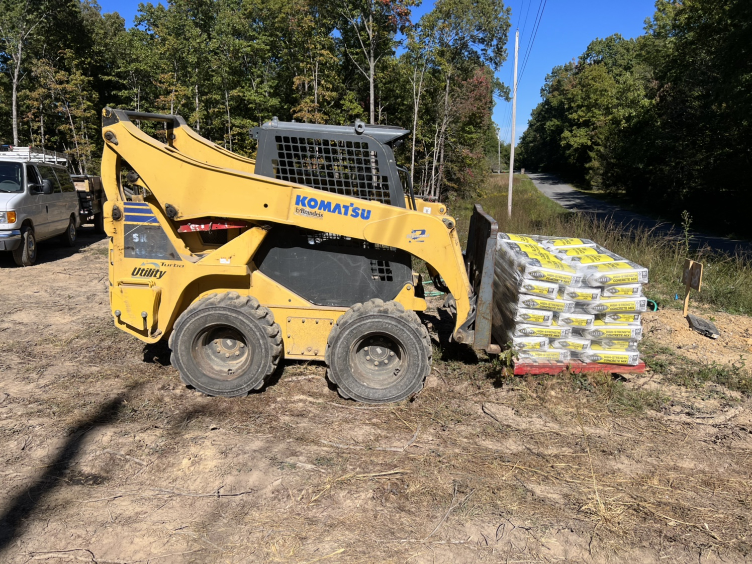

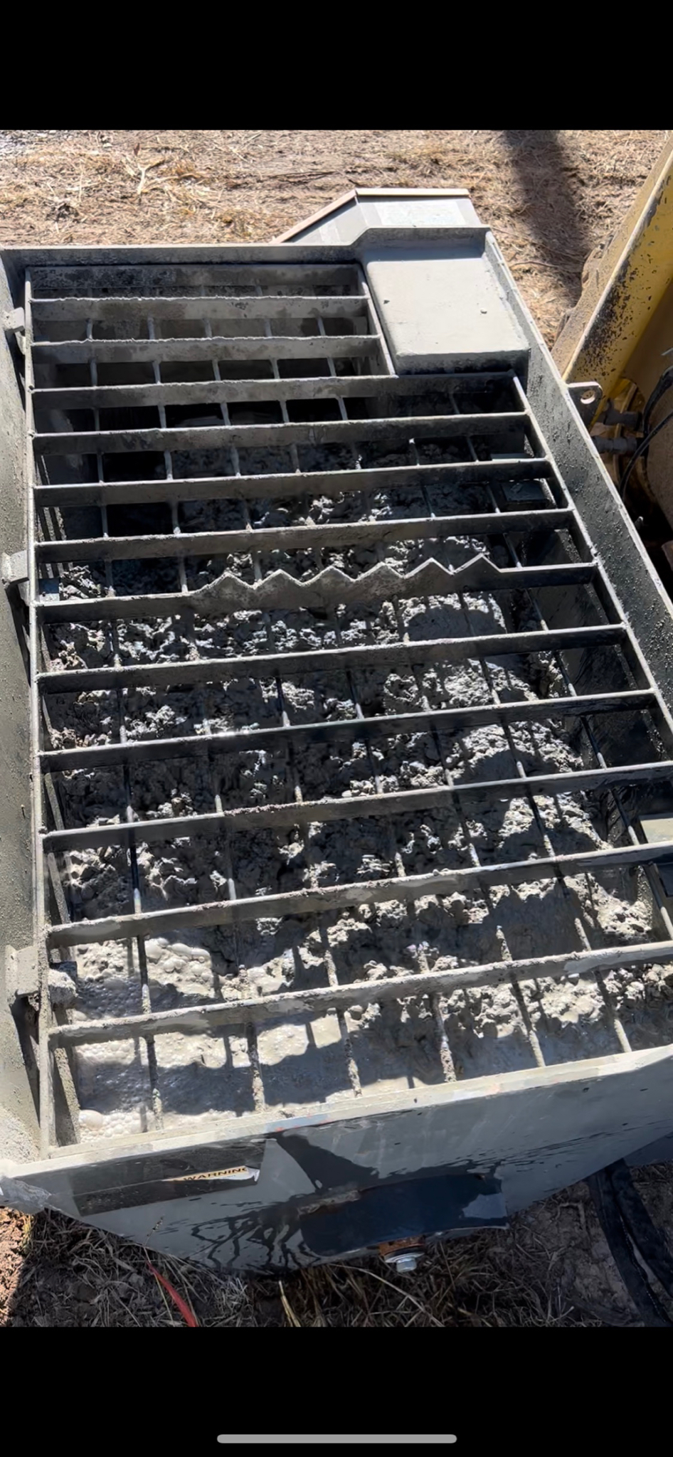

Anyone ever cobble one of these type of buckets up with useing there current bucket as the base?
I have 18 1'x6.5ft sono tubes to fill and can only get a cement truck about 700ft away. It's about $1000 in concrete bags. Last time I checked 3.5yrd of concrete from the truck wasn't $280 a yard.
For jobs requiring 5yds or less, I mix my own. I usually have piles of sand & gravel around but I'll occasionally buy bags of pre mix if necessary.
I welded an SSQA plate to the frame of an old 6 cu ft. stand mixer I bought at a yard sale. I replaced the burned out electric motor with a hydraulic motor which I power using the 3rd function valve. With the mixer attached to the tractor FEL, I load the ingredients and mix them while transporting to the job site. Pouring is easy using the FEL without having to get off the tractor. It takes around 5 trips to pour a yard but turn around time is reduced by mixing while transporting.
I particularly like this idea because it saves setup & cleanup time. Instead of getting the sand, gravel and cement together next to the mixer, I take the mixer to the components.
