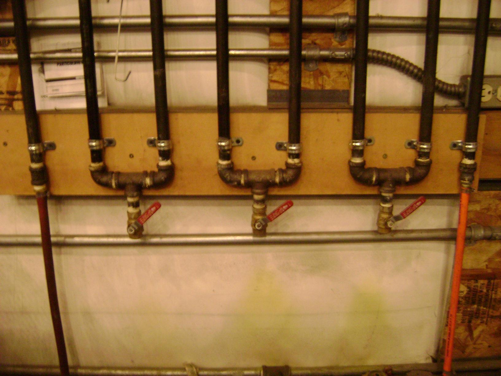

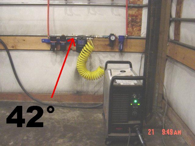

If I'm understanding your question correctly. Why not go to the hardware store, and buy some hose barbs, and hose clamps? Cut a short section of air hose. That's what I did at the after cooler for my shop air.

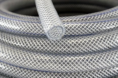

I use the heavy duty braided clear hose and barbed fittings. <img src="http://www.tractorbynet.com/forums/files/welding/416041-compressor-piping-hose-question-image-jpg"/>
Haha. Good choice Dave. I was just using some this afternoon. Here's a photo with a 'miscalculated' piece. :( image-50838910.jpg Terry

I used high pressure rubber hose for my whole system.
Use barbed fittings with 3/4" hose clamps.
No leaks in over 1o years of use.
No need to get a hose made up, buy enough hose and cut it to size and the same store should have the barred fitting too.
