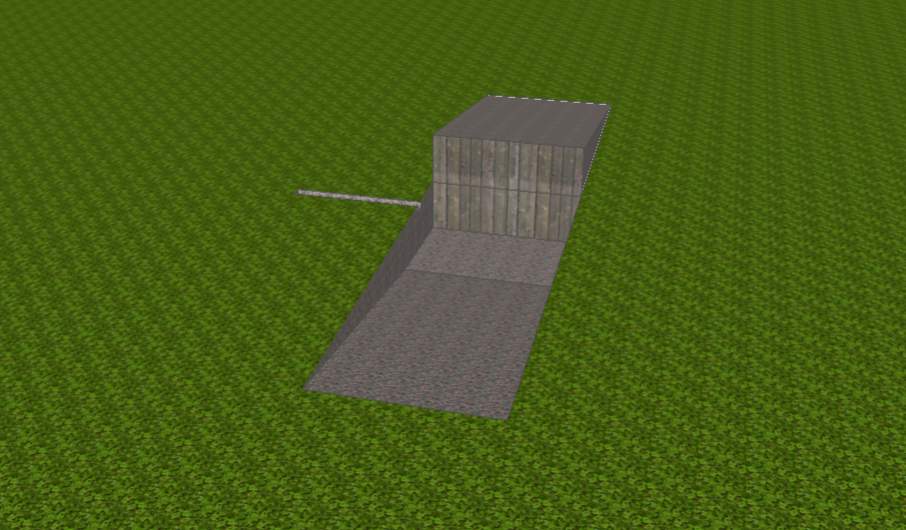

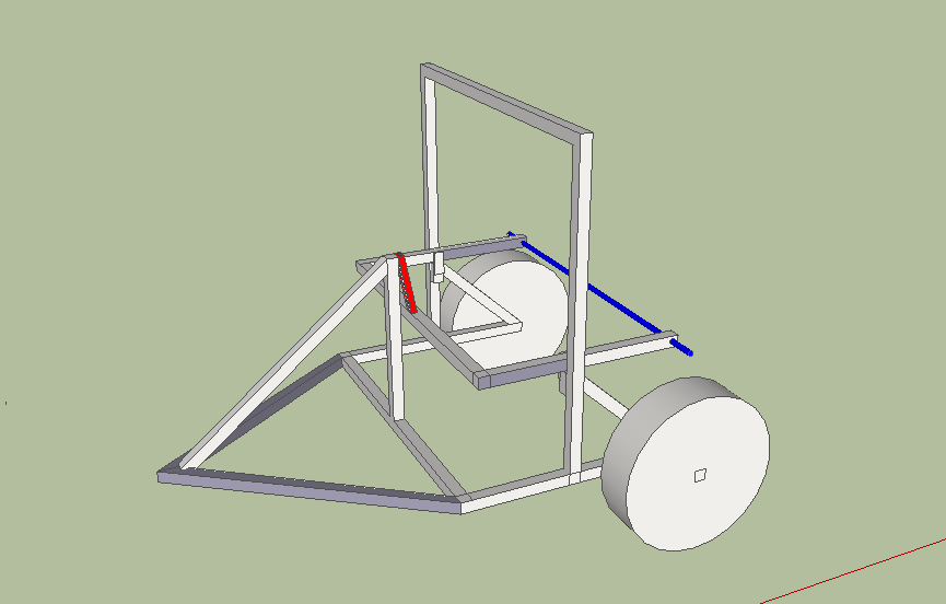

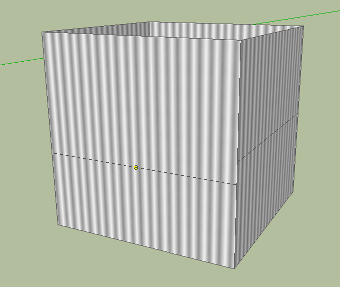

I had another idea, that is to have a trailer (see pic 2) that can move bins (see pic 3) and tip them. Then dig into the side of a hill (see pic 1) and so you can put an empty bin in the bottom and tip the full one from the top. The red thing on the trailer in pic 2 is a manual hydraulic and the blue rod on the trailer goes through the yellow hole on the bin. You will notice the rod is not in the center of the bin that is so that it is easy to tip.
