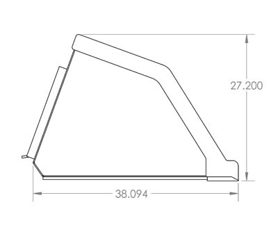

The Kioti handles the 1 yard bucket better than I thought it would. The Kioti has a strong loader for a CUT. And subtracting the extra weight of the larger bucket, my loader will still lift ~3,500 at ground level and ~2,500 to full height (with enough ballast). The curl cylinders are very strong for a CUT and have no problem with the 38" depth of the bucket. I originally bought it just for light materials, but I now use it for everything (wood, gravel, loose dirt) because it's so much more efficient than the tiny 13 cubit foot stock bucket.

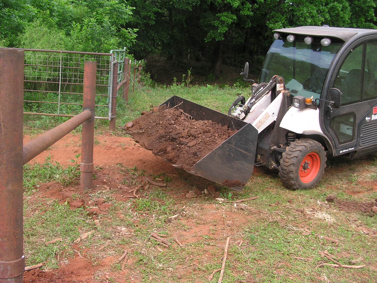

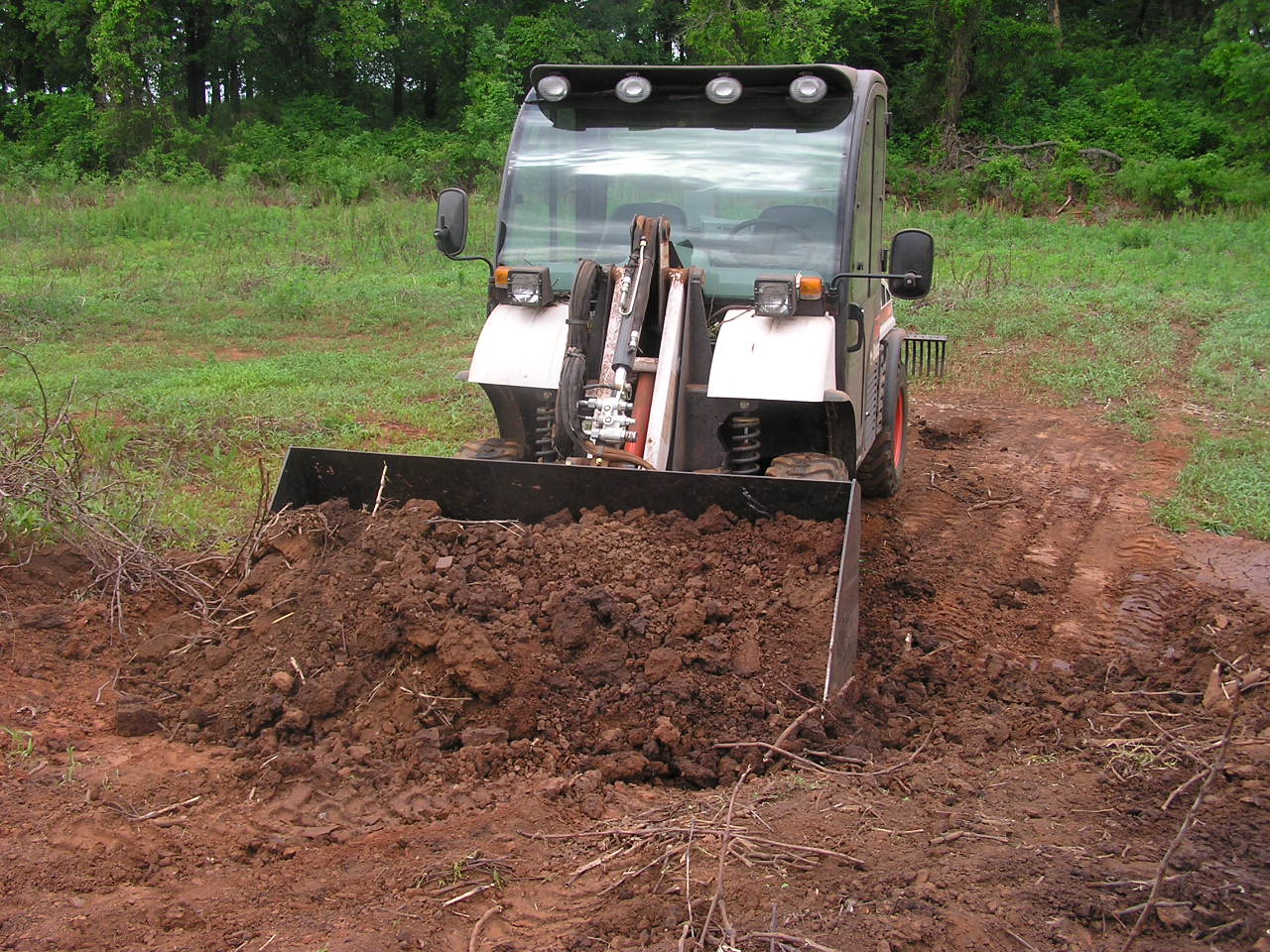

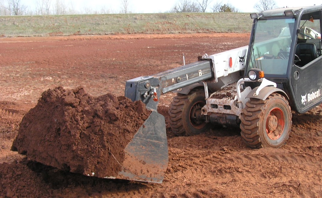

My 6' wide, 1 yard SSQA bucket is from Bobcat:
View attachment 574275 View attachment 574276 View attachment 574277 View attachment 574280
With 17 feet of lift, it has no problem loading a truck. :thumbsup:
Mine is deeper but not as tall (also 6ft wide). I like the shape because I can see the front edge of the bucket if I scoot forward on the seat and sit tall. I can't do that with my stock bucket. At 778 pounds, yours is much heavier duty. I weighed mine right at 500 pounds but it is plenty heavy duty for a CUT and the weight savings helps me because I don't have the kind of lift force that you have.
