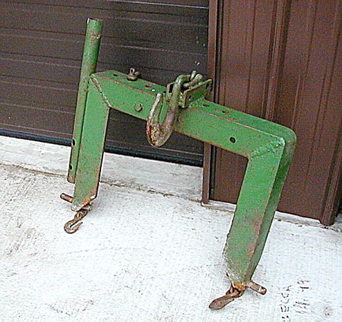

I was searching for a way to skid logs with my JD 2520 without having to leave the seat (lazy I know) and came across the attachment from Smallwoodlottools.com. Although I really liked the design of the attachment the price struck me as quite high. I have decided to take a swing at building my own. Not knowing if reverse engineering is illegal in anyway I have opted against posting any pictures from the website but have already made a scale model to make sure that everything will work out as far as the size of the parts go. I already have all the steel needed but have a few questions for you guys on the forum.
- Are Brass bushings and grease fittings needed on this attachment?
- I plan to build the entire project out of 5/8 steel, but I do have 3/4 at my disposal. I would like everyones opinion on which they would suggest.
- And last but not least, is anything Im doing illegal in any way shape or form. being that I am not distrubuting the plans for it (because I have made my own) I doubt that there is any wrong doing but you never know.
Any thoughts or ideas for improvements would be greatly appreciated. Hopefully I can lazer cut the steel tomorrow and get the ball rolling.
Thanks.:thumbsup:

Can't see what is shown in the pic. Looks like something just slightly larger than an ignition key. ??
But the tongs shown at the Smallwoodlottools.com site looks handy. I use the iMatch QH and a set of logging tongs to skid logs. Sometimes hook them up with a chain as they can roll and come loose on the way out of the woods.

All that is in the pic is a scale model of what I plan to build. 1/10 inch = 1 inch so it is quite small. I just needed to see that all the pivot points would function together before I dove into the big steel. Not really all that important in the scheem of things

Build your project full size using wood. Use 1/4" bolts to represent any pins. As the design progresses you can use a hole saw with a 1/4" pilot bit to enlarge the pin holes to the actual size where needed. Bushings are not needed, just use thick sleeves if necessary.
   / Compact Tractor Log skidder #6
You got some skills bud. You could be making some hobby stuff or toys.
I looked at the website you listed. Without seeing it operate, I question the design of those long inny/outy hooks. Don't know if it could grab a log smaller that maybe 12".
I see a pair of chains attached to the drawbar maybe. What would that do? They seem similar to rope attachments that I located on my hooks, but on mine I run the ropes vertically to the top and forward. I pull the ropes to expand the hooks to slide over a log and then to release the log when done.

The design on the tongs have changed quite a bit. They have began using straight square stock with sharpened round stock welded at an angle to the ends. This should allow the tongs to grab smaller logs while making them easy to build.
I believe the chains are to keep the pulling of the log on the tow bar rather than on the 3pt. When you grab the log and pull away the chains pull tight placing the strain on the tow bar and lower to the ground. It should also help with preventing doing any accidental wheelies.

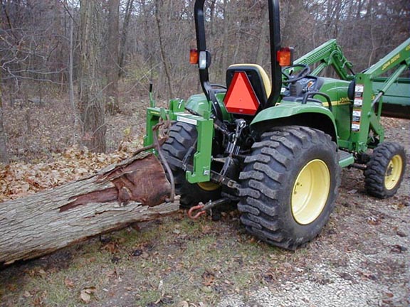

They are welding 2 hooks on both sides of my I-match for me right now and they are welding me a hook on the top of the 3 point receiver for the I-match when it comes in. All will be used for pulling logs with chains or carrying chains.... Might look into some tongs down the road but I would rather not get off the tractor until I each my destination (Tongs might fall off on my terrain)...
   / Compact Tractor Log skidder #10
That is quite the gozmo from smallwoodlot. Most of my effort is expended in getting the logs TO the tractor. Once they are there I just hook them to a chain on the 3pth and carefully head back to where I've parked the trailer.
I really like that pull chain to the drawbar idea however..You are able to lift the lead end of the log, yet pull from a low point (once everything is adjusted)
