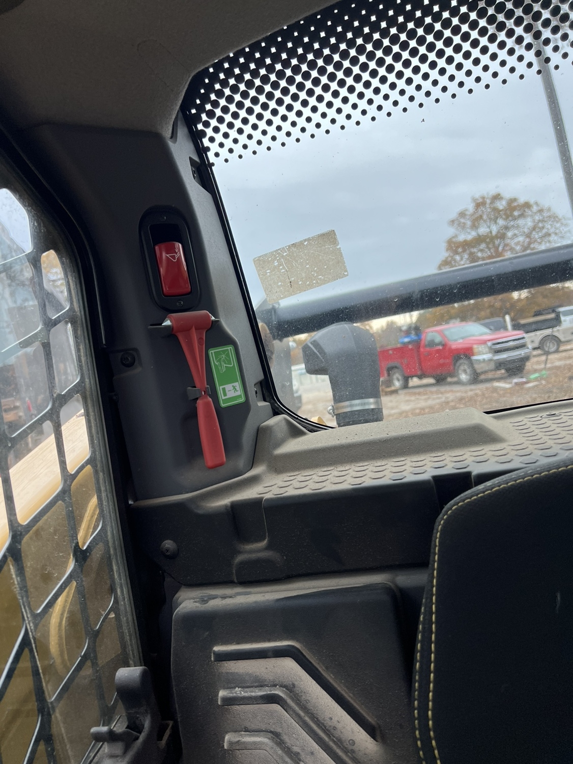

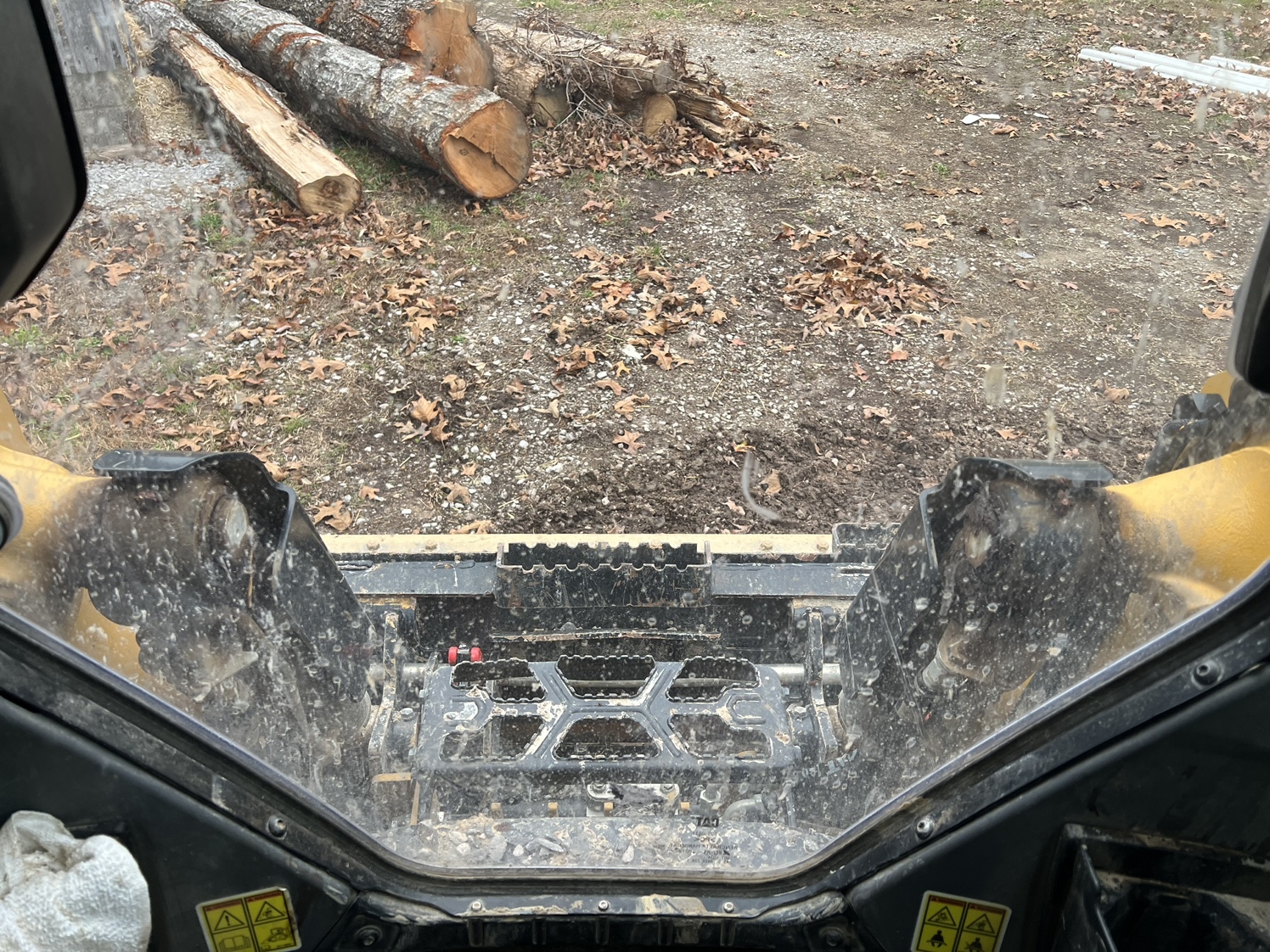

I don’t own a Cat skid steer at all and it will probably stay that way. The visibility out both ends is terrible and they don’t steer smooth either. The electric controls do not work as well as the hydraulic over hydraulic controls most other machines have. I ran another one today and it was the same issue as the other cats I’ve ran. I think this was a 255.

I don’t own a Cat skid steer at all and it will probably stay that way. The visibility out both ends is terrible and they don’t steer smooth either. The electric controls do not work as well as the hydraulic over hydraulic controls most other machines have. I ran another one today and it was the same issue as the other cats I’ve ran. I think this was a 255.View attachment 4327297View attachment 4327298
The 255 is one of the new models. I know the cab design is new on that series. They made it so you could open you cab door without the arms being all the way down, which may have inset the cabin door some. My 289 has the frameless lexan door, which gives you a good view forwards. But your arms have to be all the way down or all the way up to get the door open to the cab. Turning is very dependent on the type of track you are running, how heavy your attachment or load is and what type of material you are trying to turn on.

Visibility sucks on all of them. Honestly, its a basic feature id them all. Some are worse than others, but none are good. Thats actually why I wondered if a skip loader/industrial grade tractor might be a good option
