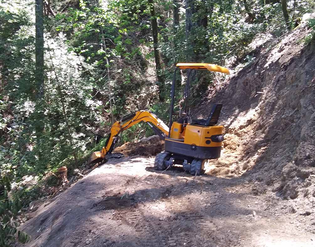

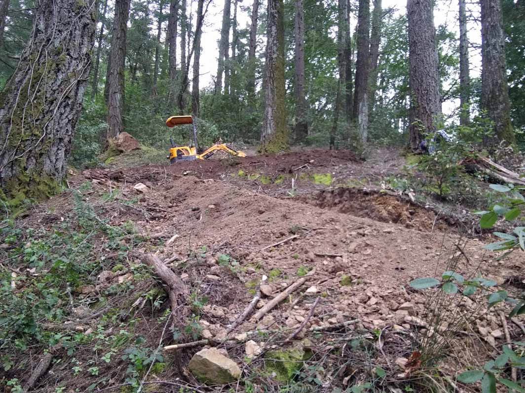

I have over a mile of trails now on my 19 acres, some built with my TLB, some by hand, and some with my newly-acquired mini-X. My wider trails are done with the Kioti, and they are about 6-feet wide at their narrowest, and 25% slope at their steepest. My "foot" trails are narrower, and only 4-ft wide at their narrowest, and as much as 33% slope. I started the foot trails over a dozen years ago, with pick and shovel. Progress was slow, of course, and got even slower as I got older and more decrepit.
So, I got the mini in 2018, and now have a year of productivity. Wow. I shoulda gotten it years ago. Now my foot trails can safely be traversed with my 4x4 ATV, which is 42" wide. When cutting a new trail, I can only go up the steeper slopes even with my tracked machine if the soil conditions are just right. Switch-backs take a lot of extra work to get right.
Even my wider tractor trails at their steepest can not be navigated with my tractor if the surface dries out too much. I have crappy R4 tires, and they are a huge compromise to traction.
If you don't want road-width trails, then a dozer or larger excavator is not gonna work. You CAN build certain types of trails with a TLB, but you must get AG tires, IMO. Most of those newer sub-compacts are sold with R4s, which is not good.
Some folks disdain my tiny Chinese mini-X, but it was less than $8500 new, and is only 3-ft wide. When I cut a new trail, I shoot for 36" of undisturbed cut ground, with the fill on the side adding to a total width of about 4-5 feet. I do not drive on the fill part (with ATV or mini) until it has consolidated for one season. Ideally, I would use a plate-compactor for the fill, but they are too heavy to haul up the mountainside.
