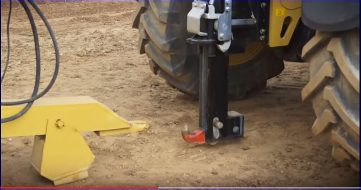

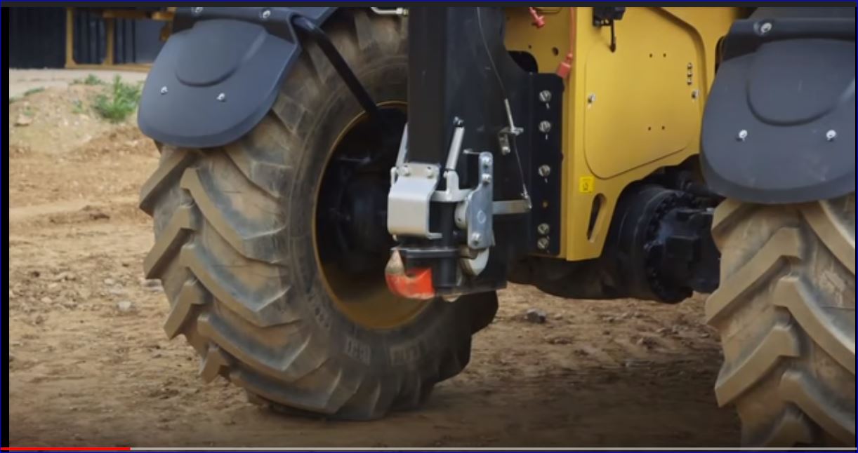

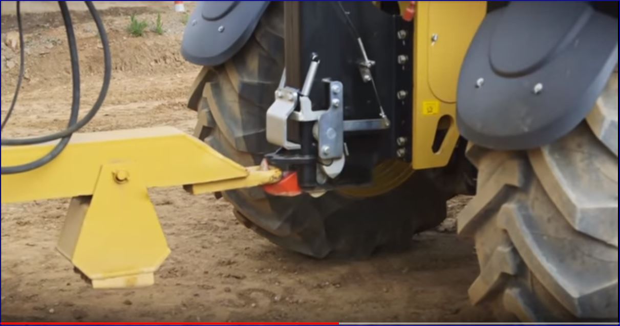

Here is my anchor. :D
/ Compact telehandlers #42
You have some decent tires on that thing. Counts for a lot.
