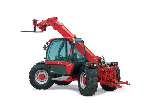

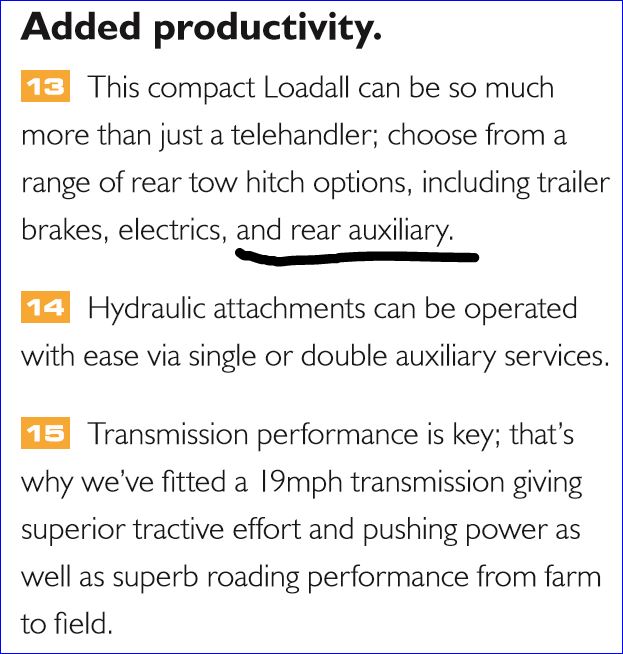

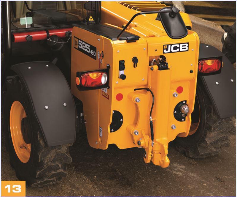

It could pull a harrow and a disc and much more if you get the rear aux hydraulics:
Or order the hydraulic hitch, remove it and use the hydraulics to operate pull type implements:
I wish they would sell the 3 point hitch versions over here:

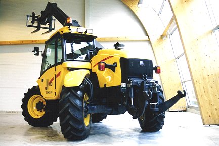

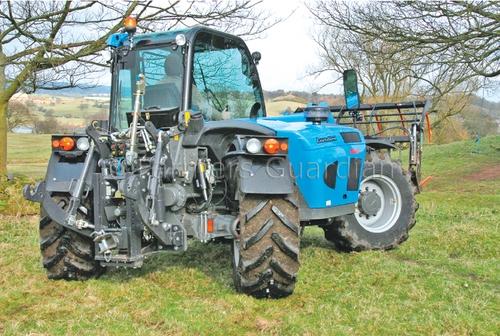

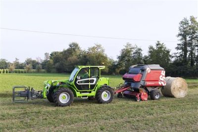

A 3 point on the back would be sweet! Who makes the machines shown in those photos?
I found the pictures on an image search for telehandler 3 pt hitch.
The green one is Merlo, don't know the red one, the yellow one might be Dieci: Dieci Agri Tech: The First Multifunctional Agricultural Telehandler >> Tracey Road Equipment
Blue might be New Holland:

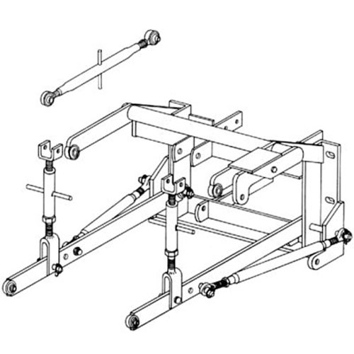

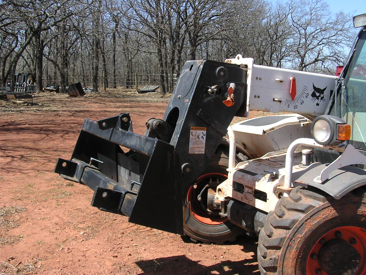

I have a 3 point conversion like this one:
, made for an old farm tractor, that I was going to put on the back of mine, but haven't needed it enough to do it.
I do have a 3 point adapter for the SSQA:

Just found a Merlo dealer within a couple of hours from here. Going to have to contact them and see how much these things run. The Merlo Multifarmer line has a 3point with PTO on the back. This may just what I was looking for. THANK YOU.
