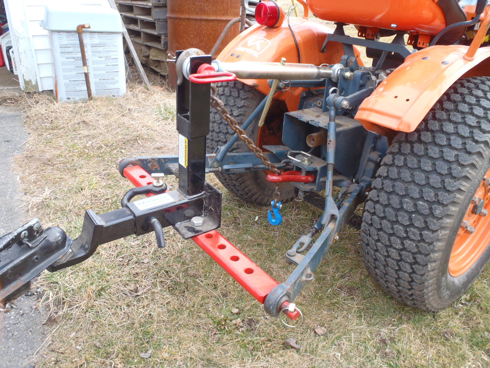

Run a chain from the drawbar to the top link:
I do this to keep the trailer tongue from lifting if the load shifts aft.
<img src="http://www.tractorbynet.com/forums/attachment.php?attachmentid=279858"/>
That is gosh darn clever.
