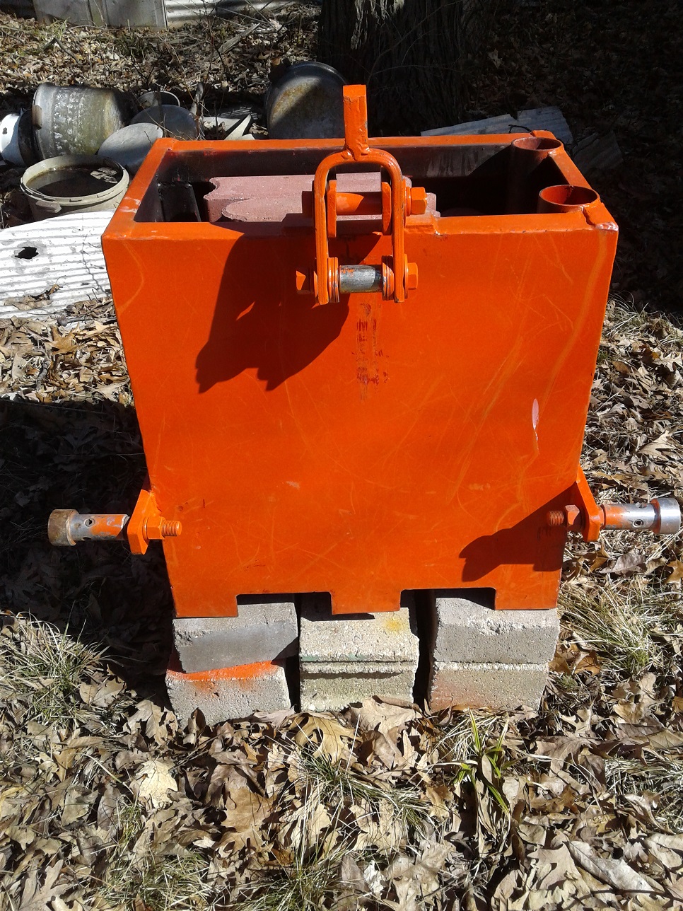

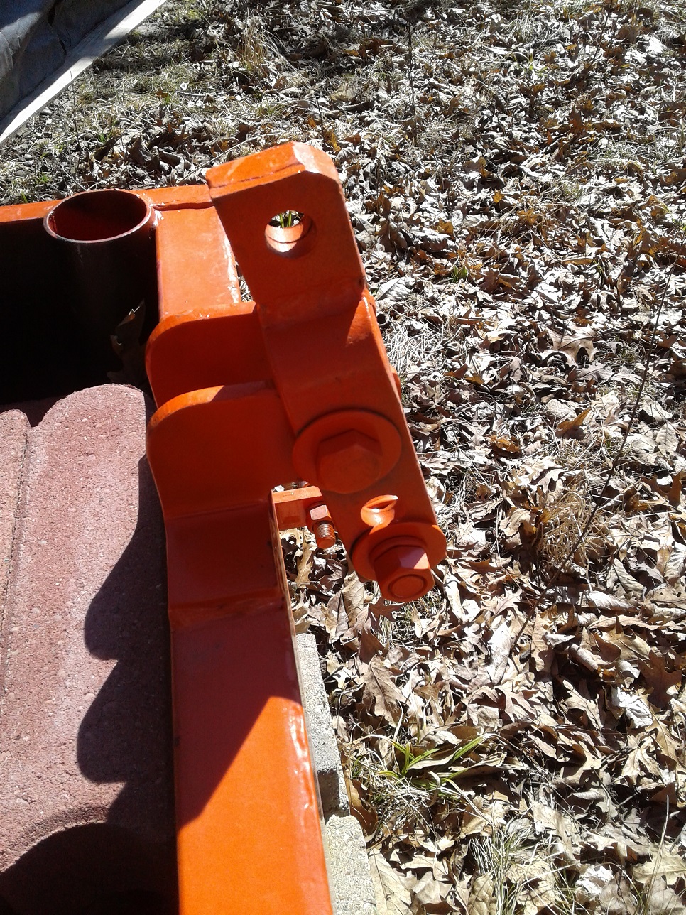

My Titan ballast box was not quick hitch compatible. The top link was behind the lift arm pins and placed too high. Here are photos of my modification. Maybe someday I'll take welding classes. Also added the proper paint.
