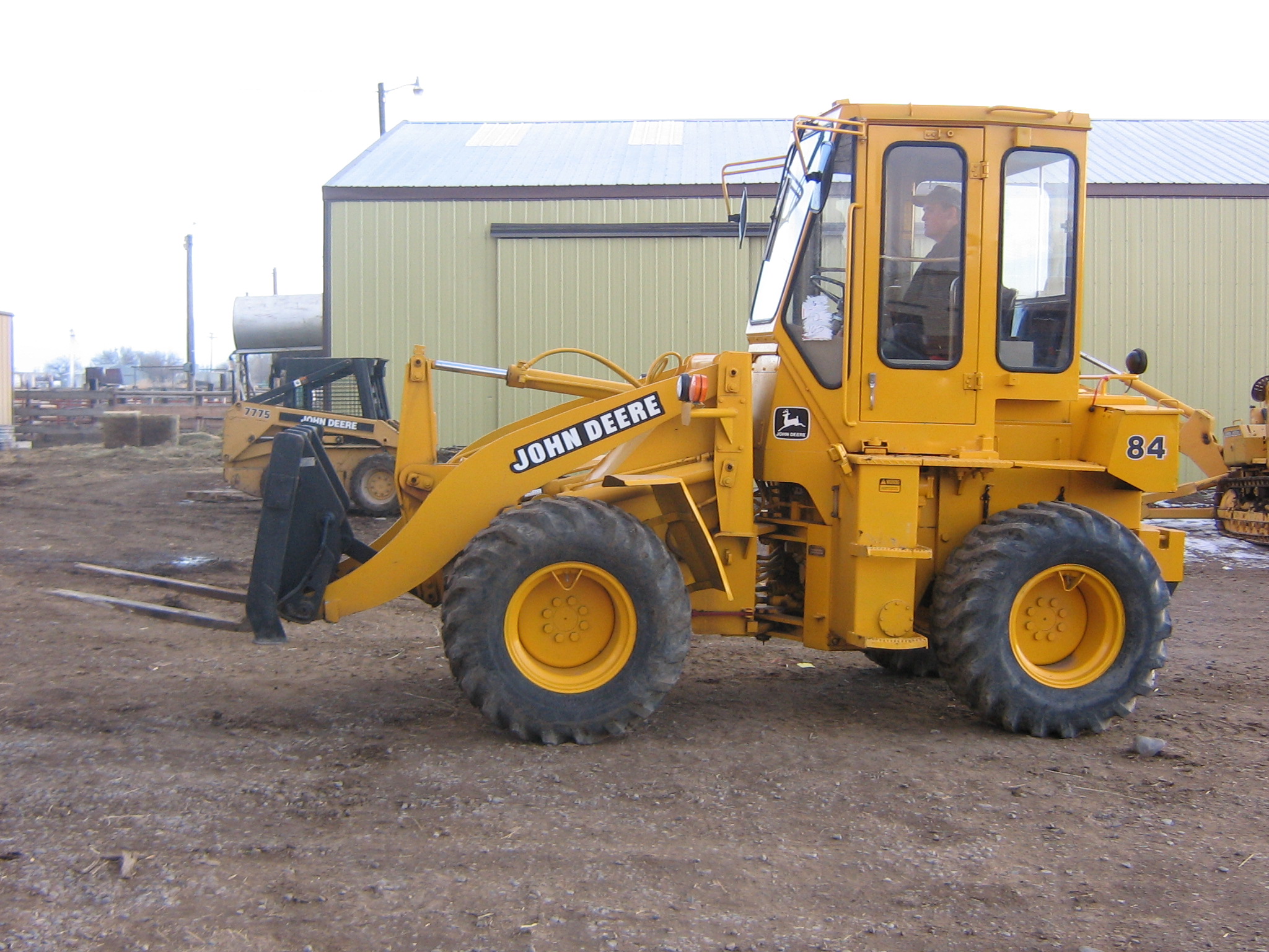

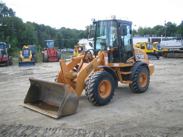

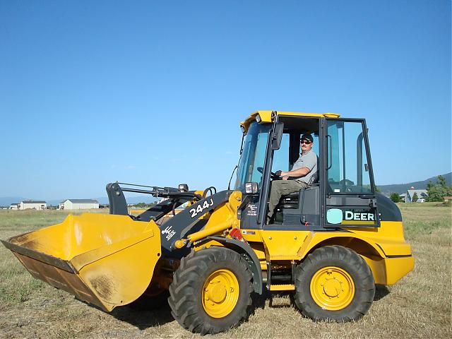

The case 221D is a large compact loader. Case does have smaller models but I've never used them or seen them and right now their website is down so I can't check the numbers. The Deere 244J is a large compact loader as well. The only other compact loader I know of is the JD 84 which is the third picture. I'm not sure on it's size. The Kubota, from what I've een, is a pretty dang compact loader. They have two sizes, one smaller, one bigger. I'd check one of those out. The only thing I notice is they don't look too terribly comfortable. But I could be wrong. Case's machines look comfortable.
