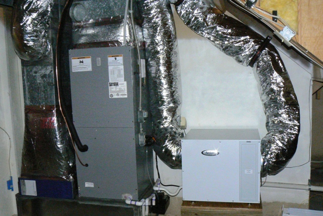

In our 7th year after encapsulating our crawl space underneath the family room and laundry room, we started experiencing odor and it affecting my wife this year. It has been traced to bacteria formation underneath the encapsulation. The expert who diagnosed this recommended a commercial dehumidifier, Santa Fe or AprilAire. We went with the Santa Fe because it is more efficient even though about $100 more. Bought their 70 pints/day one.
There's a remarkable difference between it and the run-of-the-mill department store dehumidifier. We tried one of those in our first year of encapsulation. It was inadequate (at the same 70 pts/day) because it grossly heated up the crawl space and didn't seem to lower the humidity much. We went to about 3 different fans located at various places in the crawl space plus a normal dehumidifer in the adjacent utility room. This worked well for 6 years, until this year.
The exhaust from the Santa Fe is only about maybe 70 F. I figure the thing has enough air flow such that the cold coil probably only cools the air maybe 5 F and then the hot coil reheats the air 15 F: 60 F down to 55 F and then back up 70 F. I could do a whole lot of calcs to prove this, as this is kind of work that I did as a chemical engineer, but figure I'm pretty close in my guess.
Highly recommend the Santa Fe. The compressor is so quiet that you cannot tell when it comes on. You just have to watch for the water being condensed out on the cold coil.
Ralph

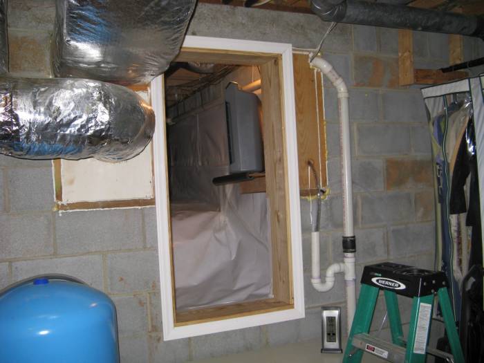

We had our friend who is a handy man take out 3 concrete blocks to enlarge the opening to the crawl space. My wife hung her toe coming out of the smaller space and bounced onto the file cabinet and then only the concrete floor of the utility room. It pulled some muscles around her ribs and was painful for a couple weeks.
Here's the enlarged crawl space opening.

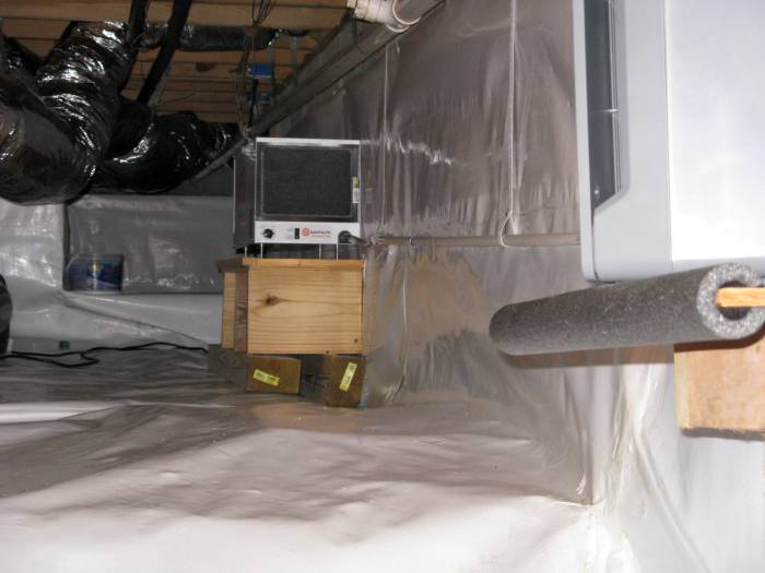

That unit sitting on a shelf just inside the crawl space is an air purifier. It didn't entirely do the job: thus the Santa Fe. The air purifier uses a Merv type filter ahead of an activated carbon one.
The Santa Fe has a Merv 13 filter on its air inlet. If it also had an activated carbon one, we could junk the air purifier.

For the last 15 years or so have been using a Aprilaire dehumidifier. The unit runs constantly in the summer, tied to the first floor system. On average, brings all three floor levels down about 5-10% in RH with the first floor generally never getting over 42% RH, which leaves me running the t-stat at around 77F in the summer.

There is something between the plastic we see and the dirt, some sort of ruffled black plastic thing. Cannot get under the plastic we see unless we untape around the upper edges. Did some retaping where we enlarged the hole. Old tape doesn't hold as well. I'm not touching the tape in place.

Posted a pic earlier that shows some of it. I'll post it again. That duct work you see to the left and goes up above the Santa Fe is the new plastic duct. It's fatter with more insulation than the old (dirty) ducting.
Ralph
The irony is I was going to say the only thing I really see (because I was looking at that picture as well) was the vinyl flexible duct:D I assumed (my fault) when you said take offs you were refering to the tab collars that are metal that connect to the main supply and return duct.
