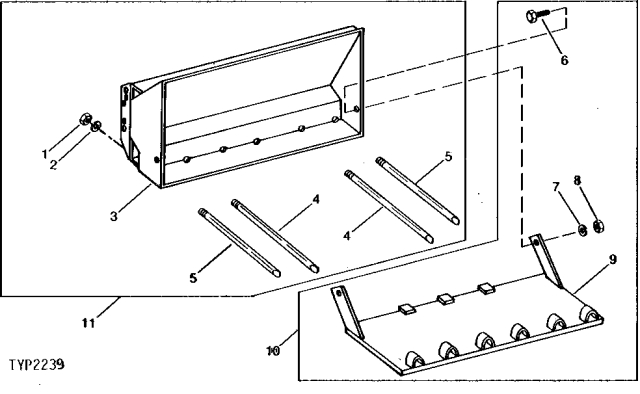

Is this picture attachment what you're thinking of? This is from the JD parts for my 67 loader and is called a tine bucket, and the plate is called a dirt plate. Did not have a price when I added it to my cart.
/ Comb-bar Anyone? #7
Henro, THAT'S what I need. Gotta' call the dealer on Monday.

Hmmm, you've got me thinking. For light duty brush moving ( not ripping, but just transporting cut stuff ), why not build some sort of angle or box tube attached to the bucket with 1" pipe flanges welded on at say 12" centers. You could then just thread in 1" pipe at whatever length you need. Won't be real heavy duty, but for moving light stuff.....
....all I need now is a welder /forums/images/graemlins/grin.gif
