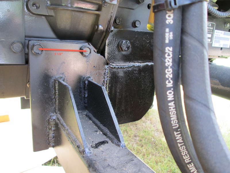

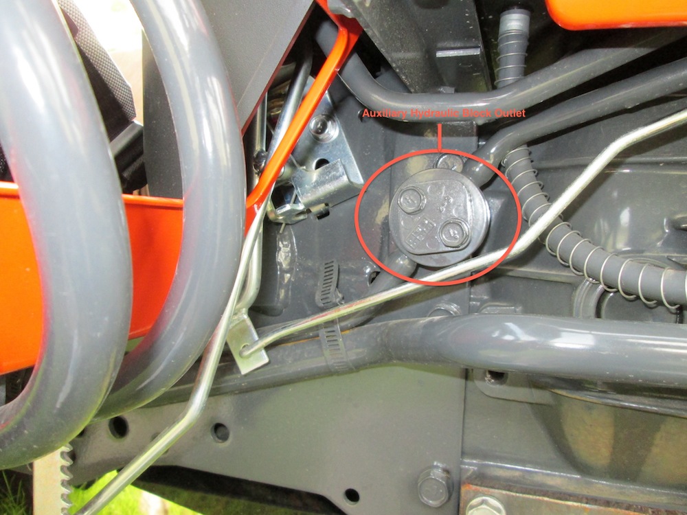

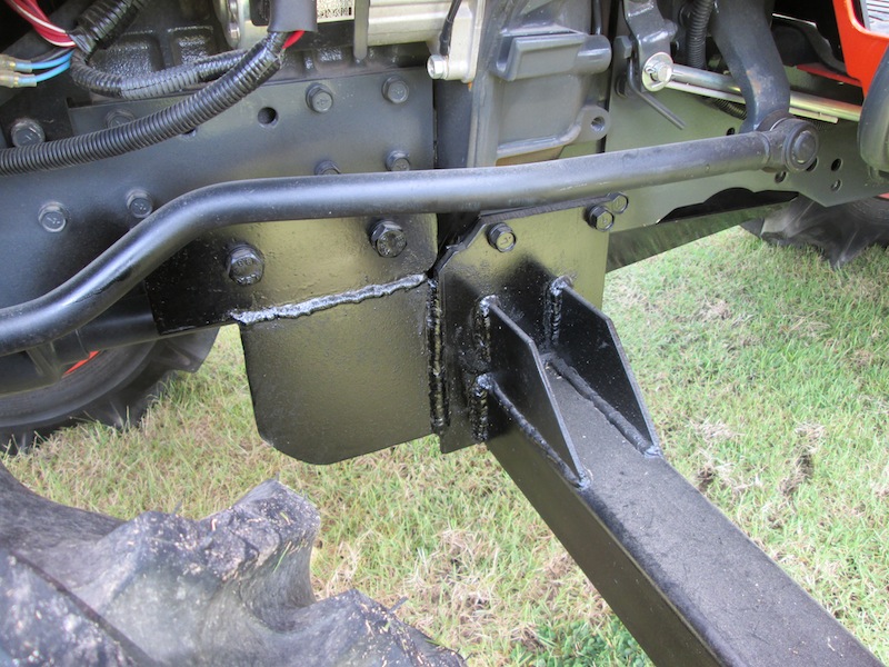

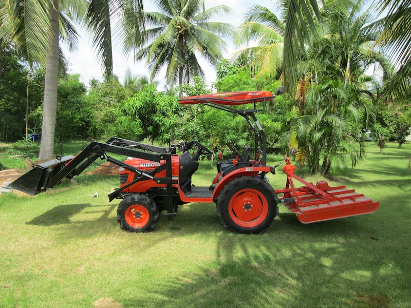

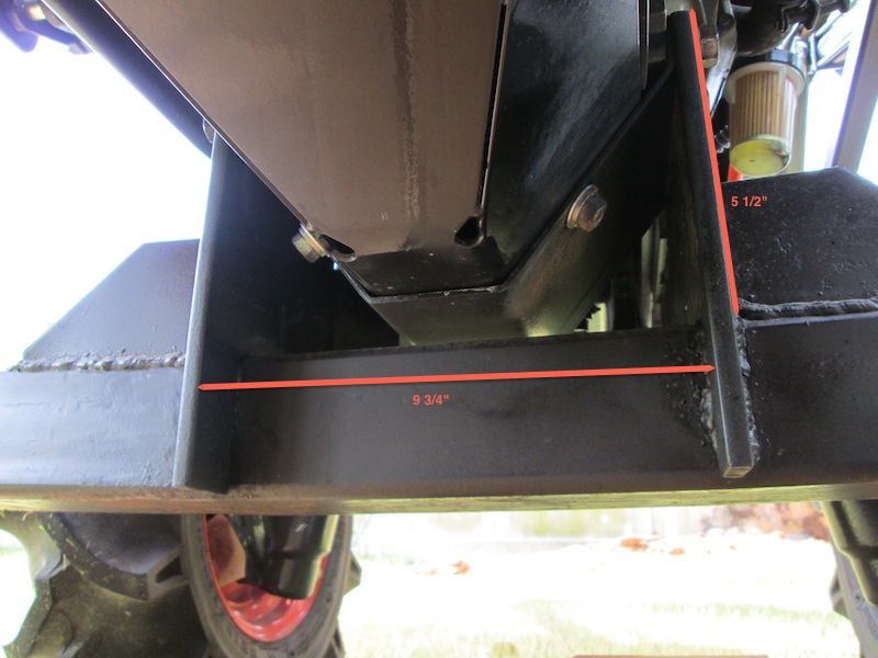

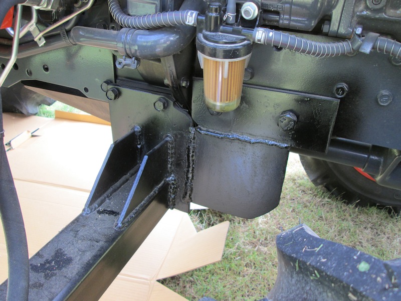

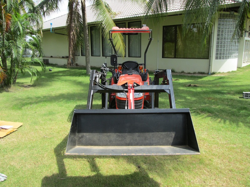

Don't want to steal the thread but got my loader from Coldwater Tractors some time ago. I live in Thailand. Took a while to get it fitted up as Coldwater had not made a loader for a Kubota B2420 before so I had to find a welder and a mechanic to help me with the bottom brackets and hooking up the hydraulics. Kubota in Thailand is useless. No help whatsoever. I had to order parts from Keller Kubota in the USA to get the hydraulics to work. Simple kit and the part numbers are Kubota global part numbers but the dealerships here have no clue.
Kris from Coldwater was very helpful although a 1 or 2 page list of instructions would be beneficial. Below are some photos.

Nice looking setup. I hope it treats you well. I'm surprised your Asian support is poor, although I imagine each country is different.
I think the Kubotas may be made in Japan, but it would depend a bit on the language and access.

I would not call the support poor in Thailand. I would call it non-existent. There is a small Auxiliary Hydraulic Block on my Kubota to the left and up from the fuel filter. It has a cover on it with two bolts.
You remove the cover and two bolts, attach an adapter block with two o-rings and adapter bolts for the hydraulic fluid to flow through to the FEL control and presto, shazzaam, it works. I showed pictures and owners manual to the Kubota dealers here, even gave them the part numbers and no dice. They told me that there was a place in Bangkok that could manufacture and attach a loader for me at a cost of $6,550. With the cost of the Coldwater FEL - $1,800, Shipping - $500, Customs duties - $150, Parts from Keller Kubota - $31.75 and the mechanic and welder time - $140, it cost me $2,621.75.

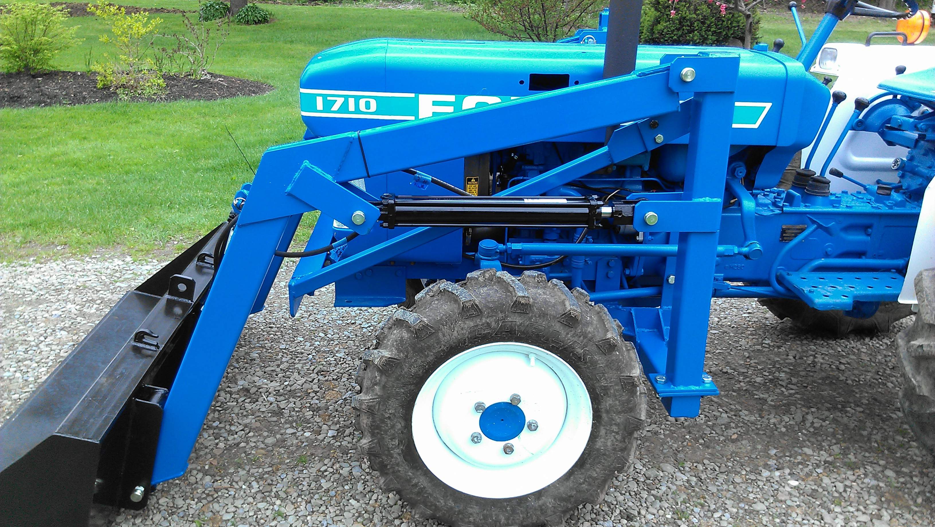

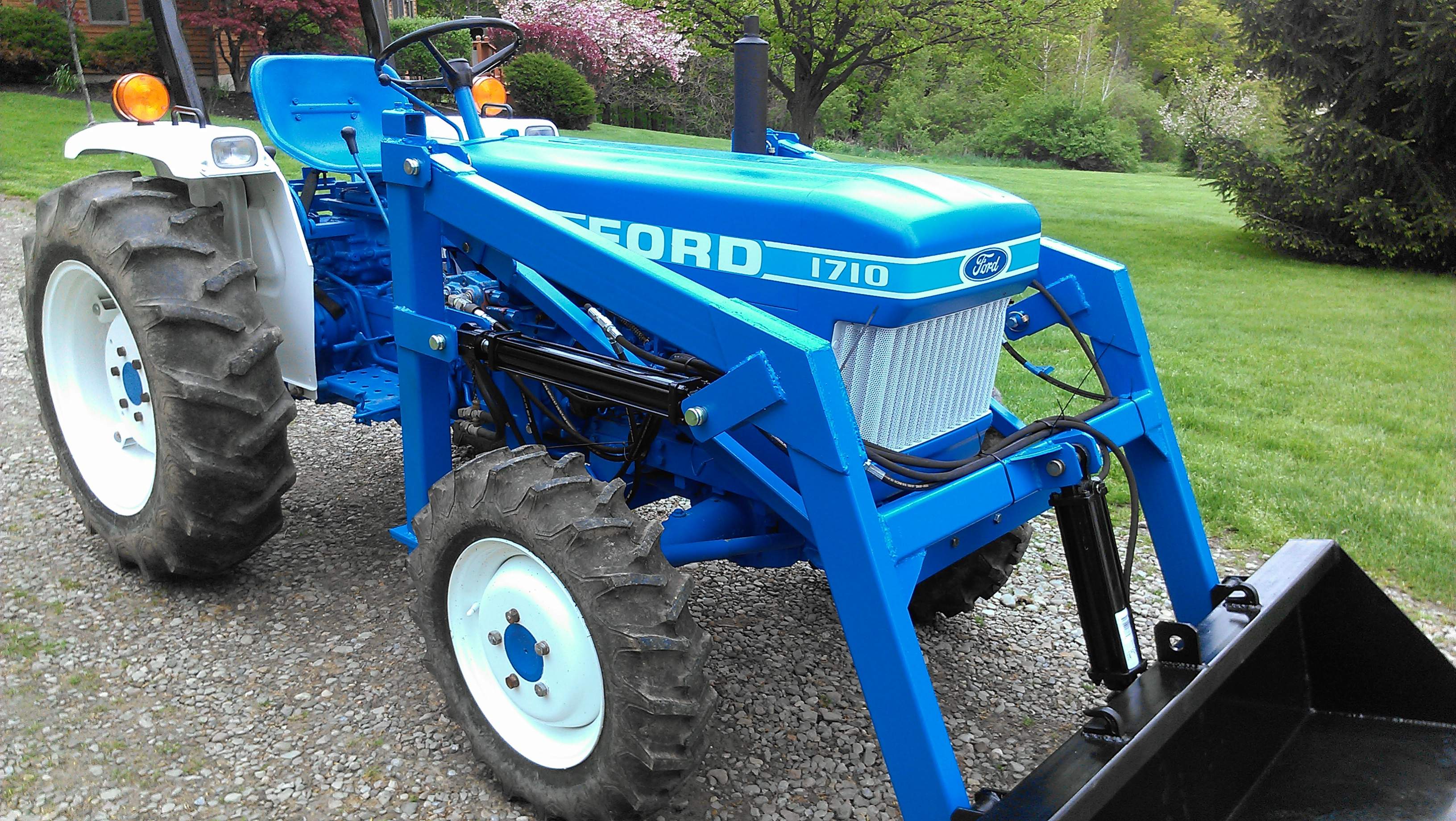

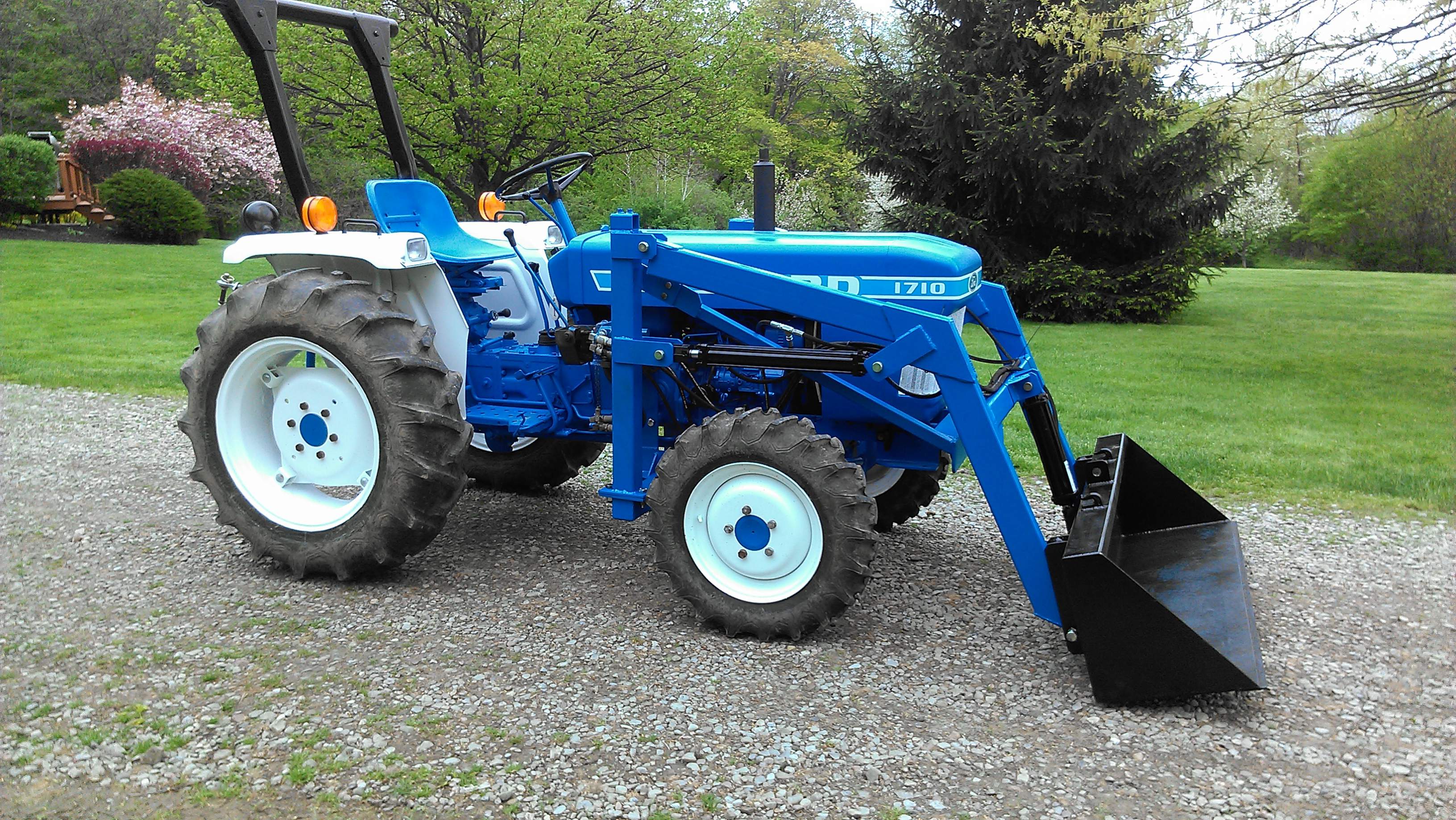

i just installed my coldwater FEL. i have been able to use it some in the past week and am very pleased so far.

Just out of curiosity, I noticed from your photos that it does not appear that the side cylinders have been "flipped" so that the hydraulic connections are pointing outwards and not inwards. Part of the instructions I received from Coldwater was to flip the cylinders so the hydraulic connections were pointing out.

I was not aware of that. Mine came fully assembled with no instructions. The first thing i did was take it apart amd paint it and i guess i didnt pay attention to how the cylinders were installed. I will get them turned around. Do you know what the difference is?

Yeah Muzz123, I had to flip my cylinders when my loader got here too. I think they turn them inside due to the way that they package them for transport, to protect the fittings. I didn't figure that out until I tried to raise the loader and the fittings hit the frame supports coming up from the front bumper. Im liking the blue paint too, its just enough for me to take mine off and paint it. Good looking tractor
/ coldwater FEL #14
Same reason as letsmowone. I thought the fittings would be better protected being on the inside but I had tags on mine saying to flip them so the fittings were out. Maybe on yours you have enough clearance with the fittings pointed in.
/ coldwater FEL #16
I havent had an issue with them being inside and they did not have any tags on them sayingng to flip them either. I will flip them around though, thanks for letting me know.
