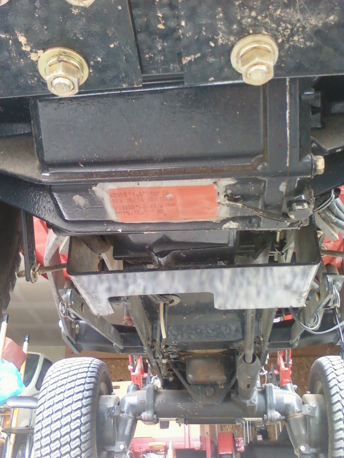

I do use a small silicone pad heater on the bottom of the differential. It keeps the fluid from being affected by the cold, and reduces the published warm up times.
