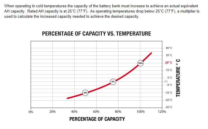

I'm always amazed at how much the capacity of a lead acid battery is influenced by temperature. At -15C (5F) the capacity is reduced by 50% compared to the battery being at 25C (77F):

thclimer: That's an interesting graph; it explains a lot about lead acid batteries and cold climate.
So...it doesn't really matter if my battery has 400 CCA or 800 CCA...that puppy is 100% flat at -35*C
And...the best way to get ol' ding beep poppin' again is to warm up the battery.
Thanks for posting! 🚜 ding beep
The graph comes from a Canadian battery manufacture (Rolls Battery Engineering), here is a link to the site:
Temperature vs. Capacity - Flooded Lead Acid Batteries
I'm sure at -35C there is still some energy remaining in a battery.
The site also describes how the "life cycle" of a lead-acid battery is reduced at warmer temps but increase in colder temps. I guess its the nature of wet chemistry where an increase in temperature speeds up reactions and cooling something down helps to slow those reactions.
