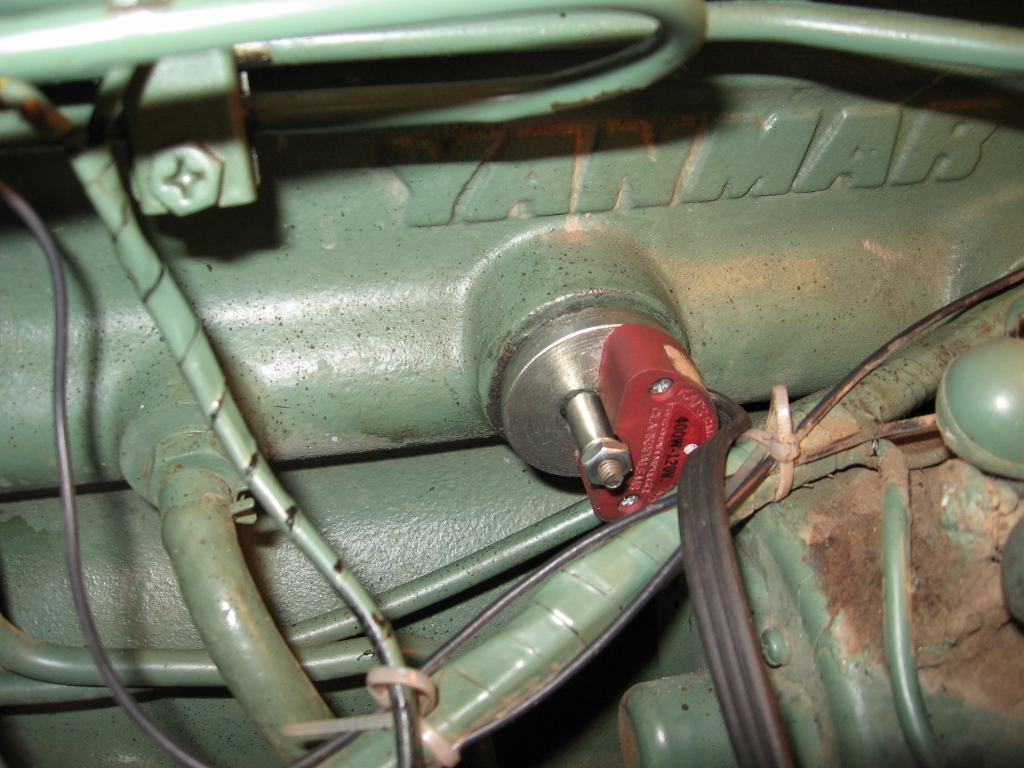

I have a similar tractor and I put a block heater in soft plug type and it works fantastic I have started mine at 20 deg and it started better than my pickup that was out too.
I used a Kats 10417/K4NB 400w it cost me $26 best money I will ever spend on my tractor I am sure.
When its inside my shop which gets 50 at night I will plug it in for an hour or so and it runs like its been running all day saves warm up time a bunch.
