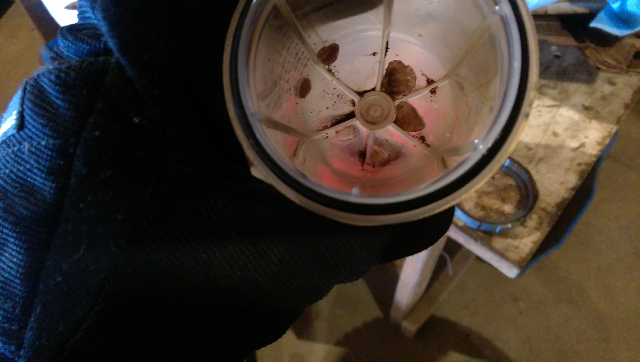

You may have water and gunk in the line from the block to the in injectors....You could have someone crank it while cracking the lines loose at the injectors maybe purging crap and air out.
I'd be tempted to pull the tank and clean it out..Put good clean fuel in, then bleed it at the injectors, you got that much crud in your filter with 300+ hours on your new rig there has got to be a bunch of crap/water in the bottom of the tank...

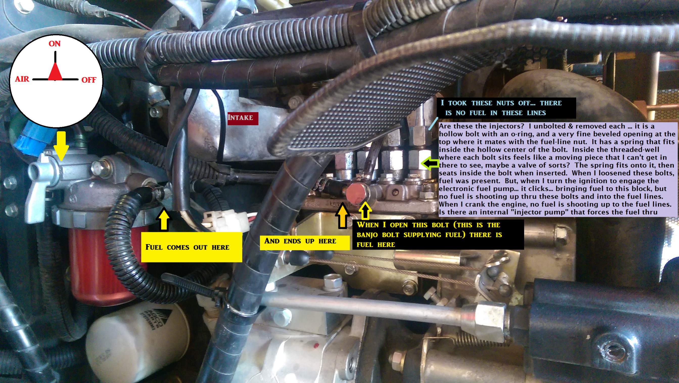

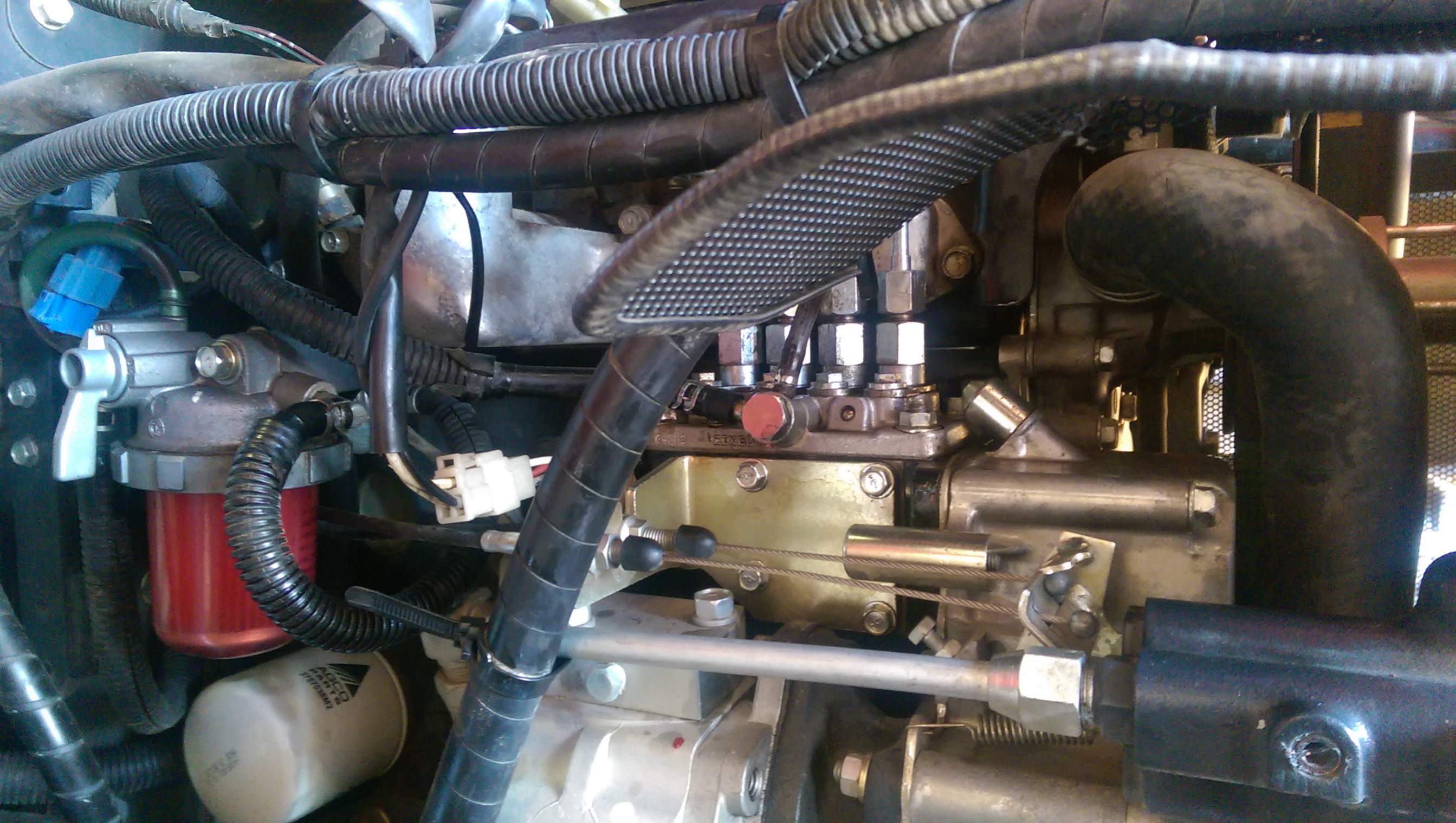

#36
Ok ... please view the attached pics. I checked for fuel, and I'm getting fuel to the pump. I don't know the proper nomenclature for these mechanical parts, so please fill me in. I'm guessing these are the injectors ... those 4 nuts/bolts that are right together and would shoot fuel up into the fuel lines. So, I'm calling that the "injector block" ... I'm getting fuel in there, because when I opened them up, there is fuel. I took the "injector bolts" apart and they did not appear to have any foreign material in them. When I turn the key to the "acc" position, I hear the fuel pump clicking like normal, and it is working to fill that "injector block" ... but is there a second pump? Something that moves the fuel at high PSI that maybe isn't working? Is it inside that "injector block" (again, that's what I'm calling it because I have no idea what its called).. ? When I crack those bolts/nuts, fuel "seeps" but never did "shoot" out.
I'm still getting absolutely ZERO fuel up into those lines because there's isn't a puff of smoke coming when I crank her.
Oh, and please, feel free to "Doctor" my photo to properly label the components I need to be involved with.
I'm open to suggestions...
I'm wondering if... if there is an internal high pressure pump, that it could have been damaged by the contaminated fuel, or the moisture... or something like that ...?
