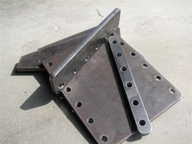

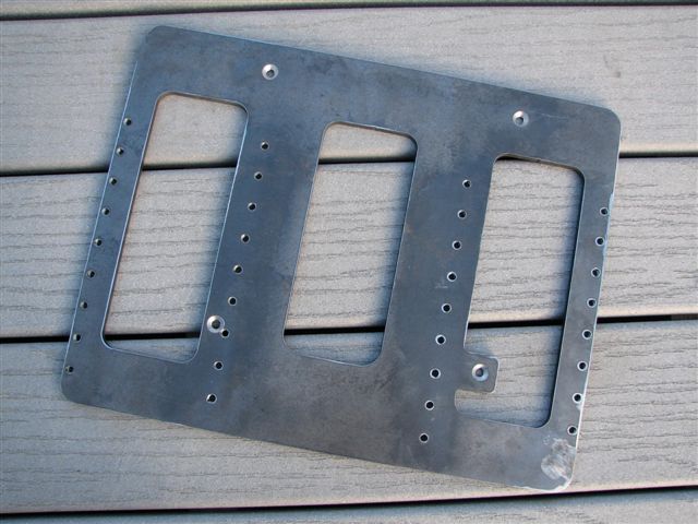

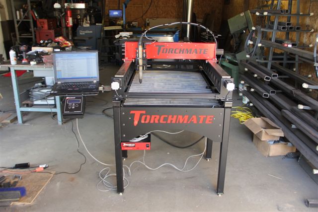

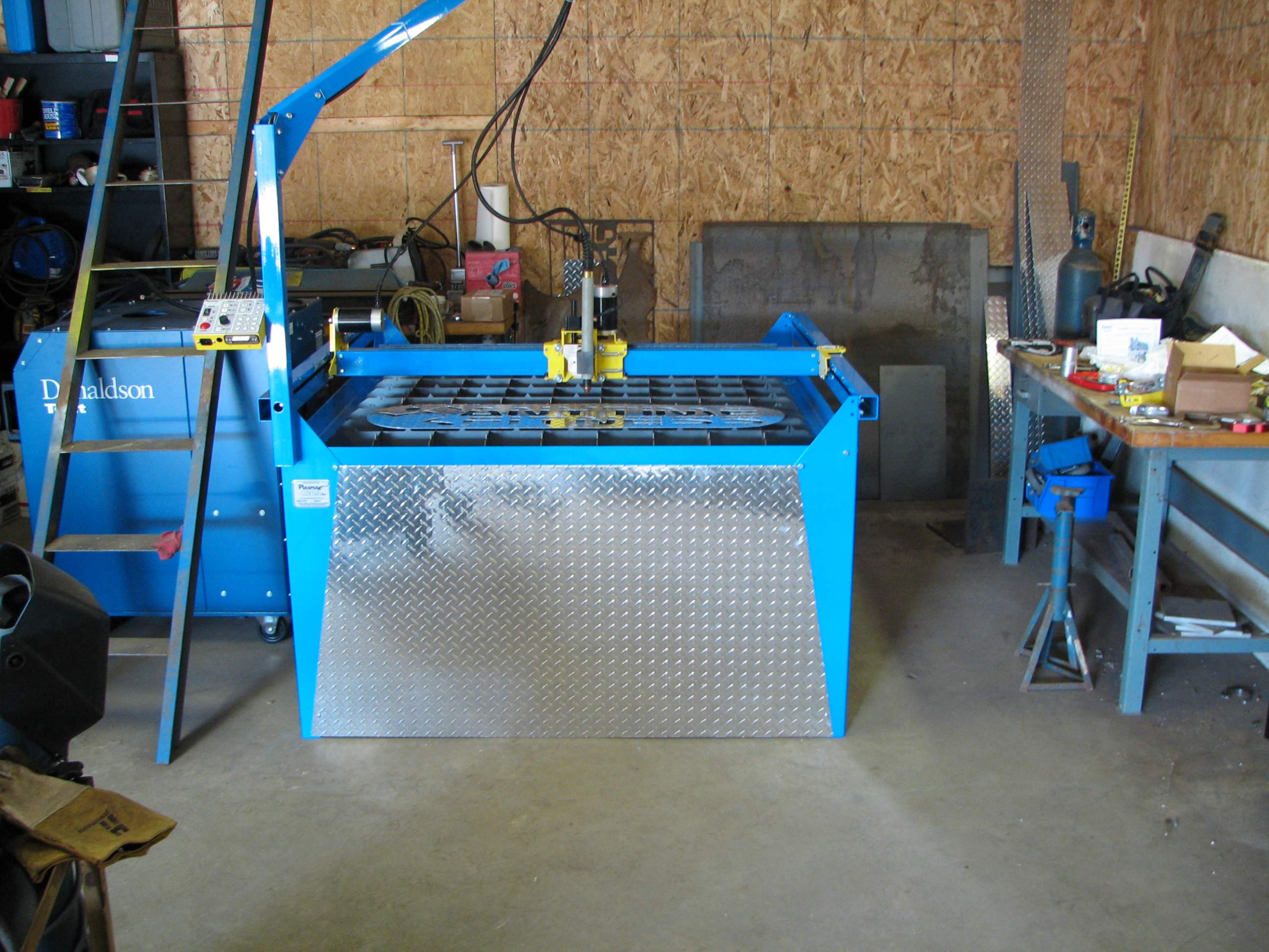

I have two cnc plasma machines in my home shop......a PlasmaCam and a Torchmate, both equipped with Hypertherm plasma's. When I bought the PlasmaCam about 5 years ago....I convinced my wife that it would pay for itself....she didn't really believe me. I put word out about my CAD drawing, plasma cutting capability....picked up a few customers.....and ended up working nights and weekends for 6 or 7 months (I work for Hypertherm as my "real" job).....the PlasmaCam earned enough money in that period of time to pay for itself. Now the machines are more for personal and hobby use.....but when I want to make a few bucks I can.
The Torchmate, PlasmaCam and Hypertherm Plasma Cutter are all made in USA.......each company is doing very well inspite of Chinese imports....in fact Hypertherm's fastest growing market for its plasma cutters is China.
If someone comes to me wanting parts cut.....they are always surprised at how fast, how accurate, and how cheap I can cut parts for them. And...my goal is to have my shop earning at least $100/hour when the cnc plasma is running.....it is pretty easy to achieve that goal.
Pics of machines and some parts cut.

As an example for pricing using my formula:
Lets say you needed a 12" x 12" piece of 3/8" steel with 4, 1/2" diameter holes. I would cut this part on one of my cnc machines at 65 amps with my plasma system......and the part would sell for $29.68, and could ship anywhere in the country (flat rate, USPS) for around $10.
That should be a relatively comparable price for plasma cut steel parts. You can expect 1/2" bolts to fit well through the holes, and tolerances on the part would be within about .020".
Jim Colt
