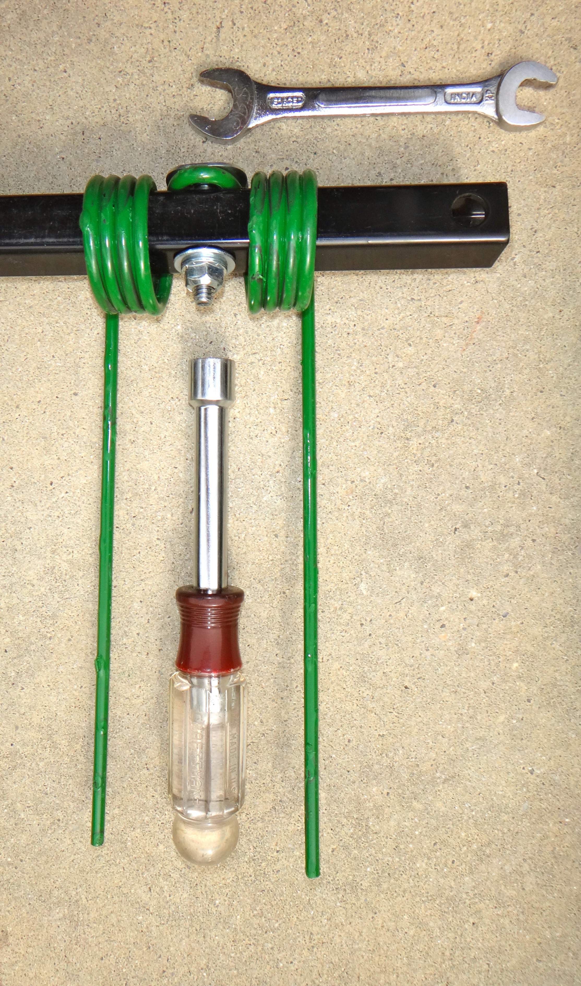

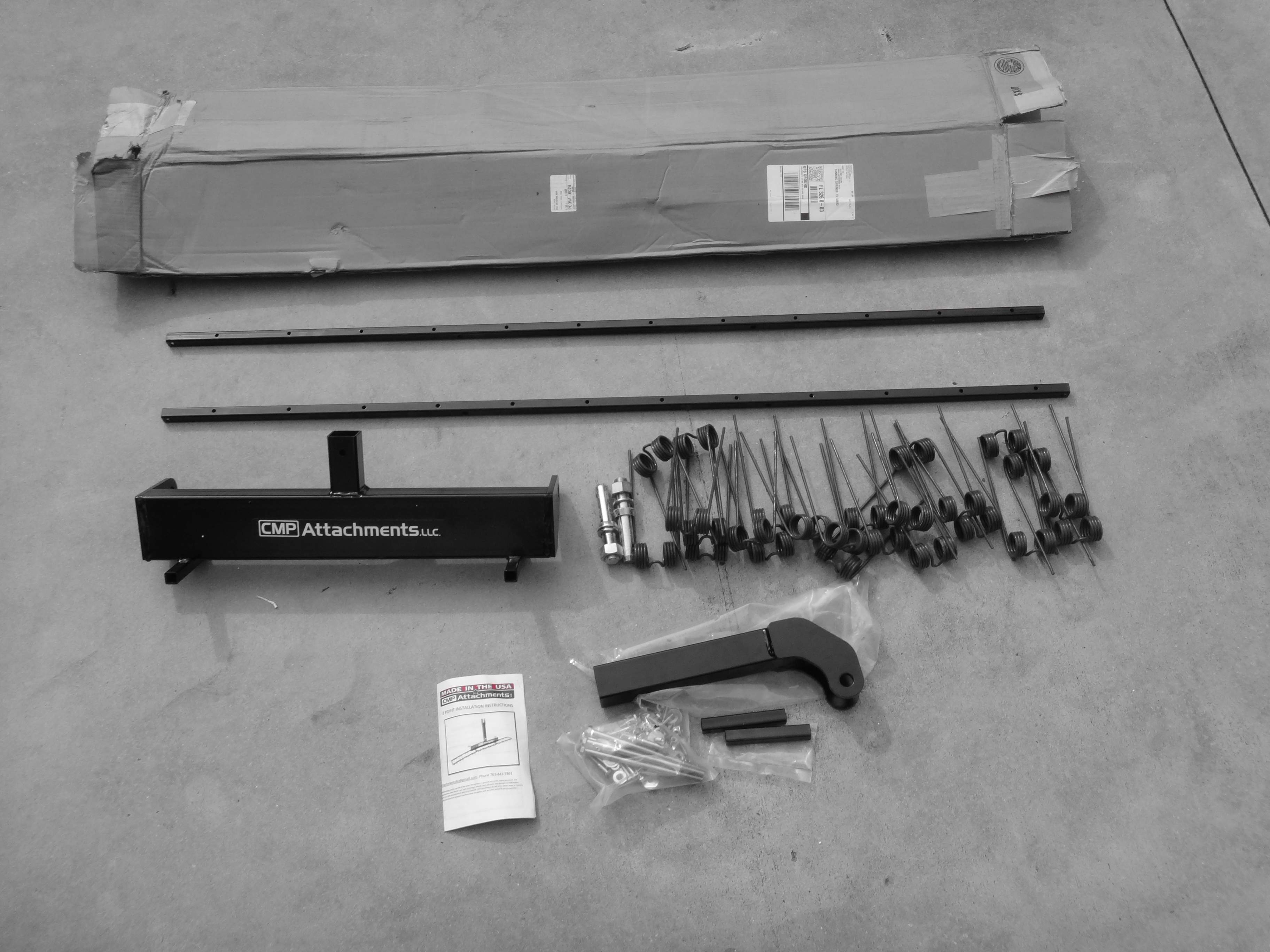

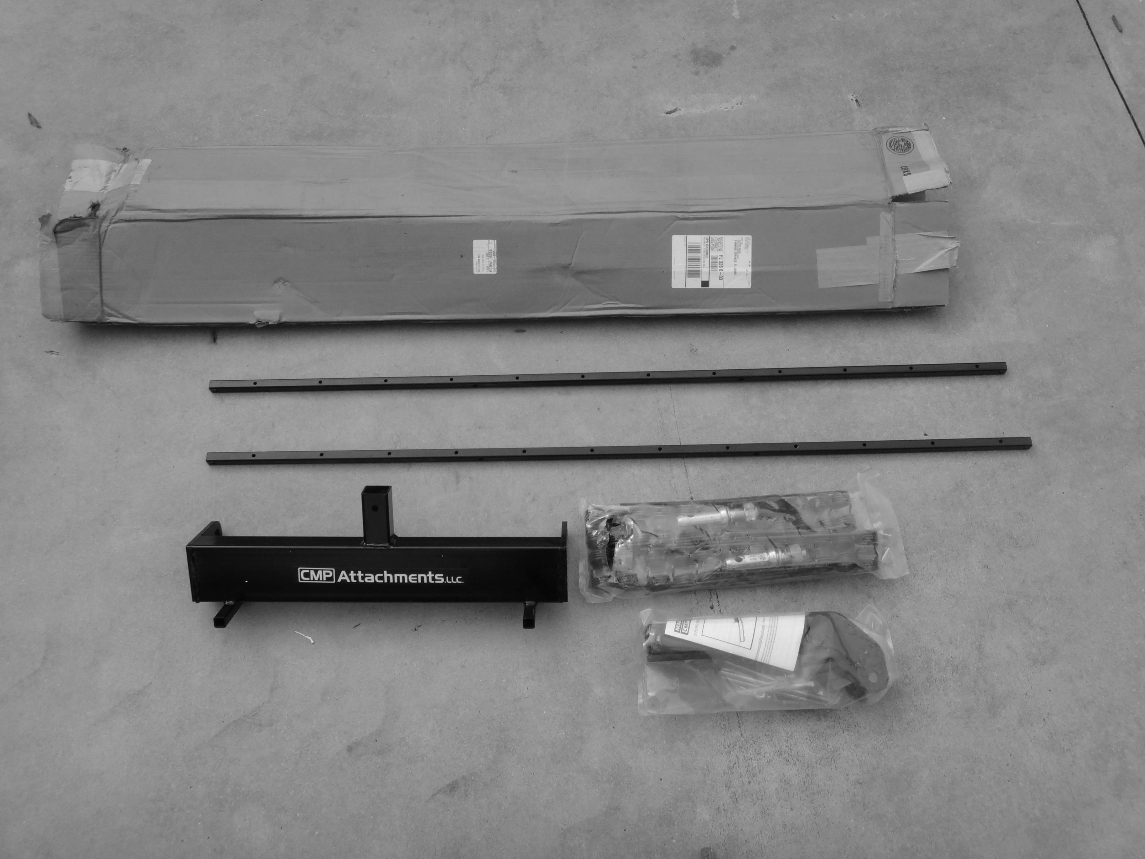

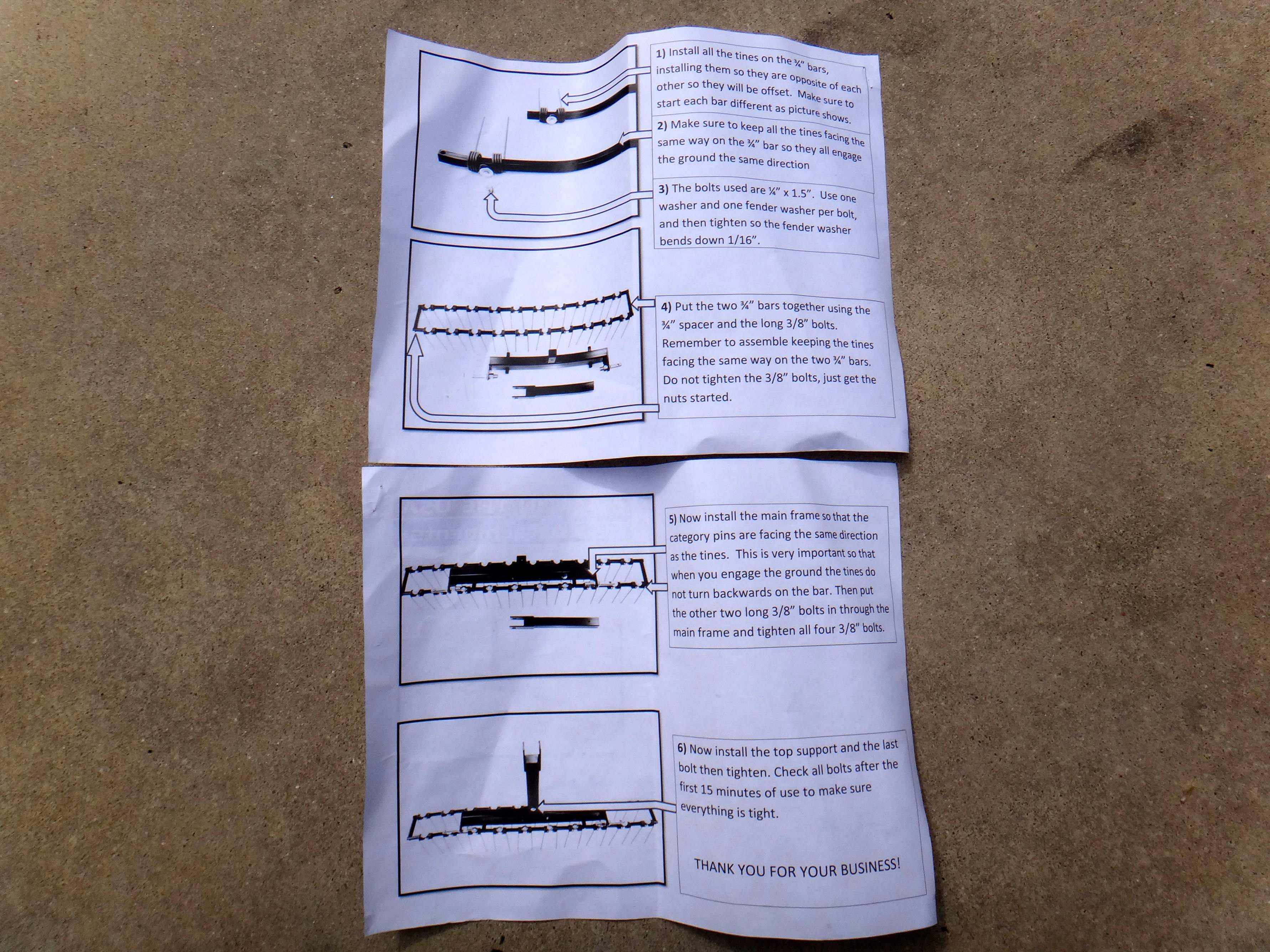

I received my 60" CMP Three Point Hitch Mount Dethatcher today, one week after it was ordered.
Price $269, including UPS shipping to my door, in a single carton.
Photo #1 Packaged components, out of the carton.
Photo #2 Components removed from packaging. (Two 7/16" tools and two 9/16" tools needed for assembly.)
Photo #3 Two sheets of clear assembly directions. Zoom in, you can read them.
Photo #4 Detail of tine assembly to tine bar (1/2). Twenty-four tines total, twelve per tine bar. Correct assembly of tines to tine bars took about ninety minutes. (A third arm would have been useful.)
Photo #5 Tine assemblies completed.

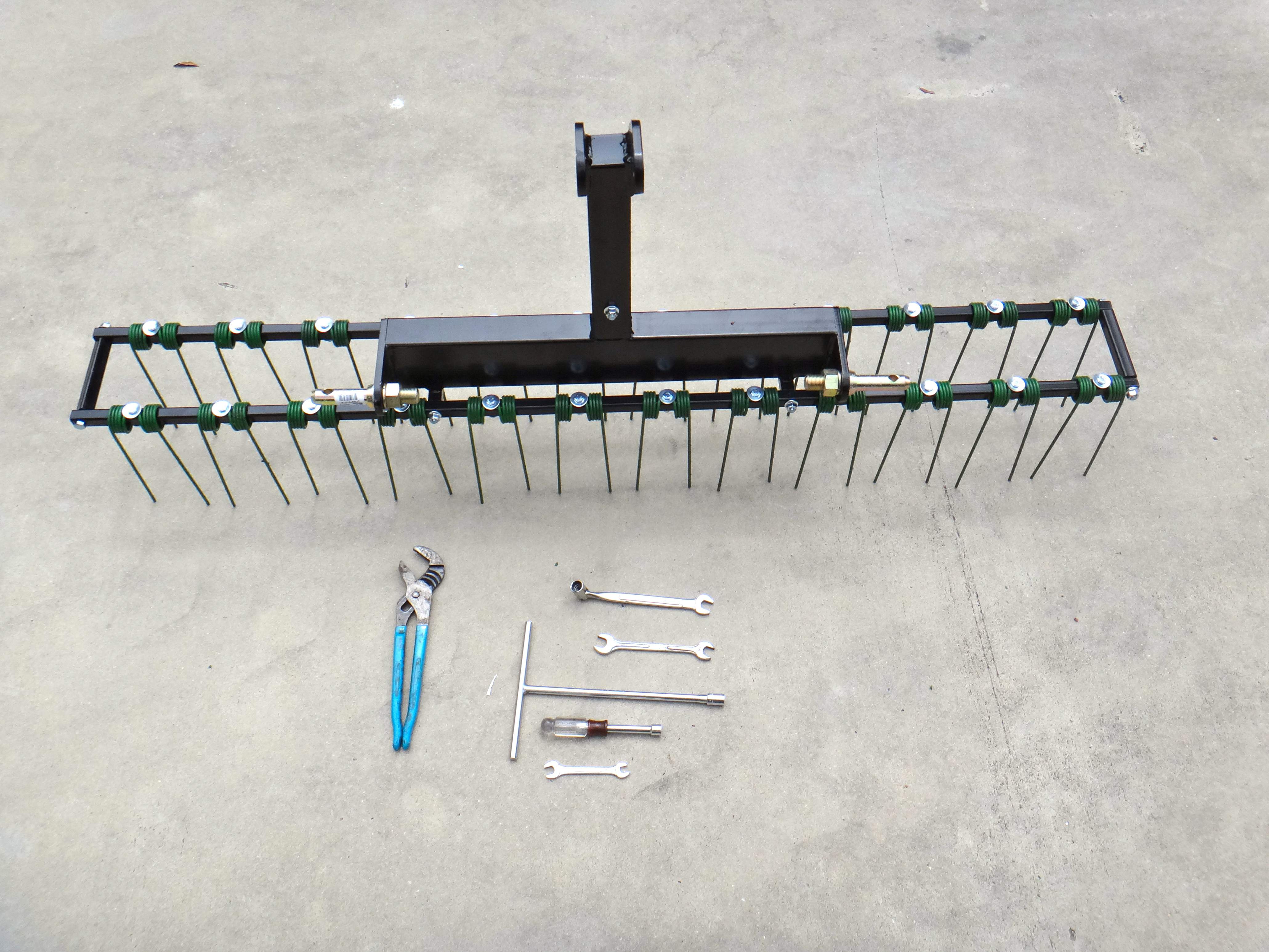

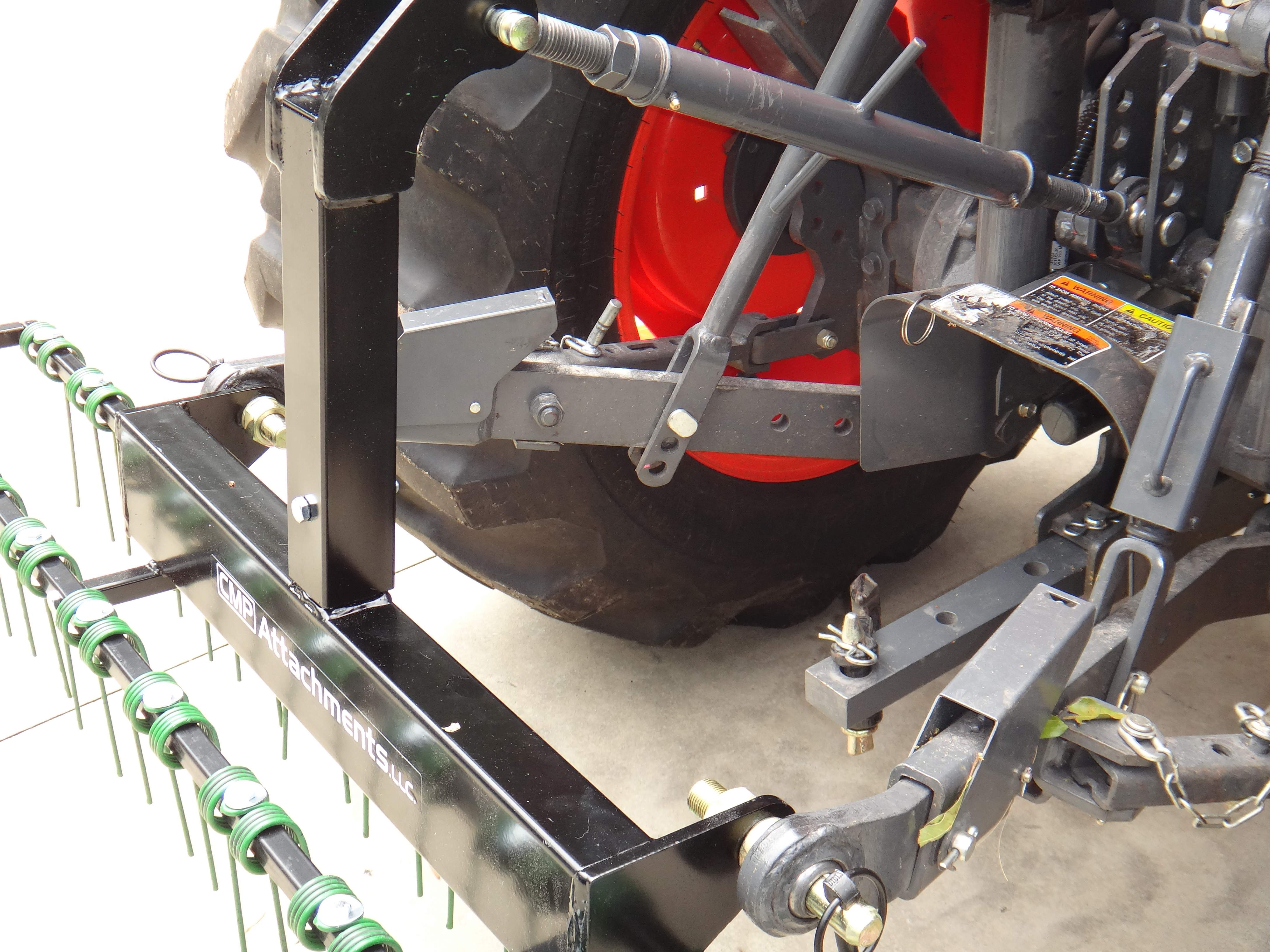

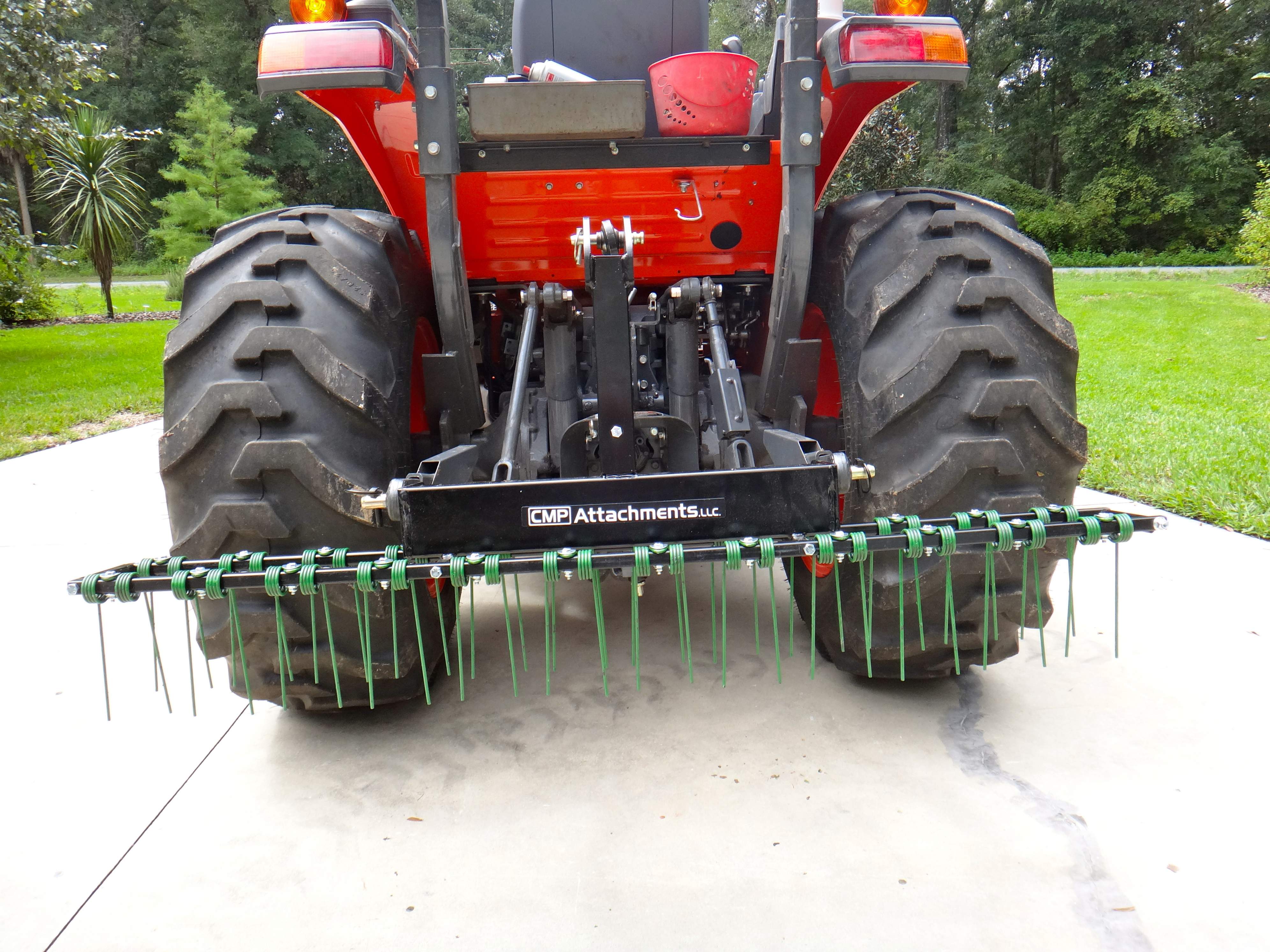

Photo #6 Two tine bars joined, main frame installed with draw pins, Top Link tower installed. ~Two hours total assembly time.~
Photo #7 CMP Dethatcher mounted on Three Point Hitch.
Photo #8 (center of photo) I may have to move pins in bottom of Lifting Rod brackets to lowest position to set tines of Dethatcher into the turf.
I wanted to test Dethatcher today but Gilchrist County has experienced a week of continuous rain and both the turf and soil are too wet.

/ CMP 60" DETHATCHER ~ ASSEMBLY (Three Point Hitch Mounted) #7

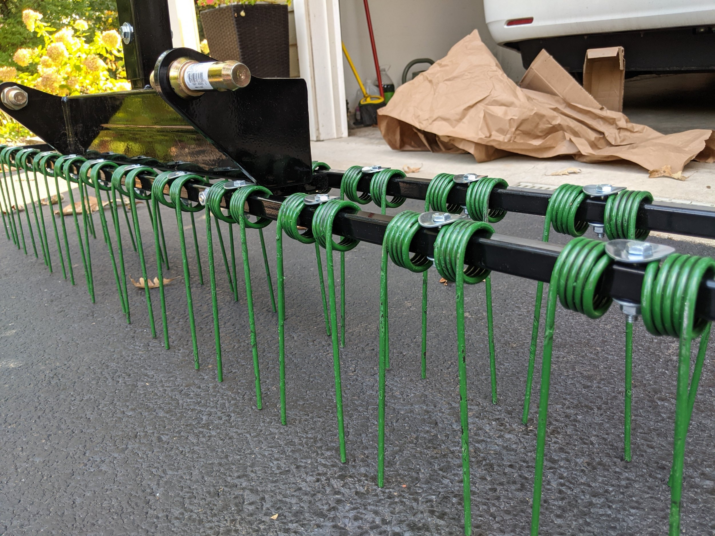

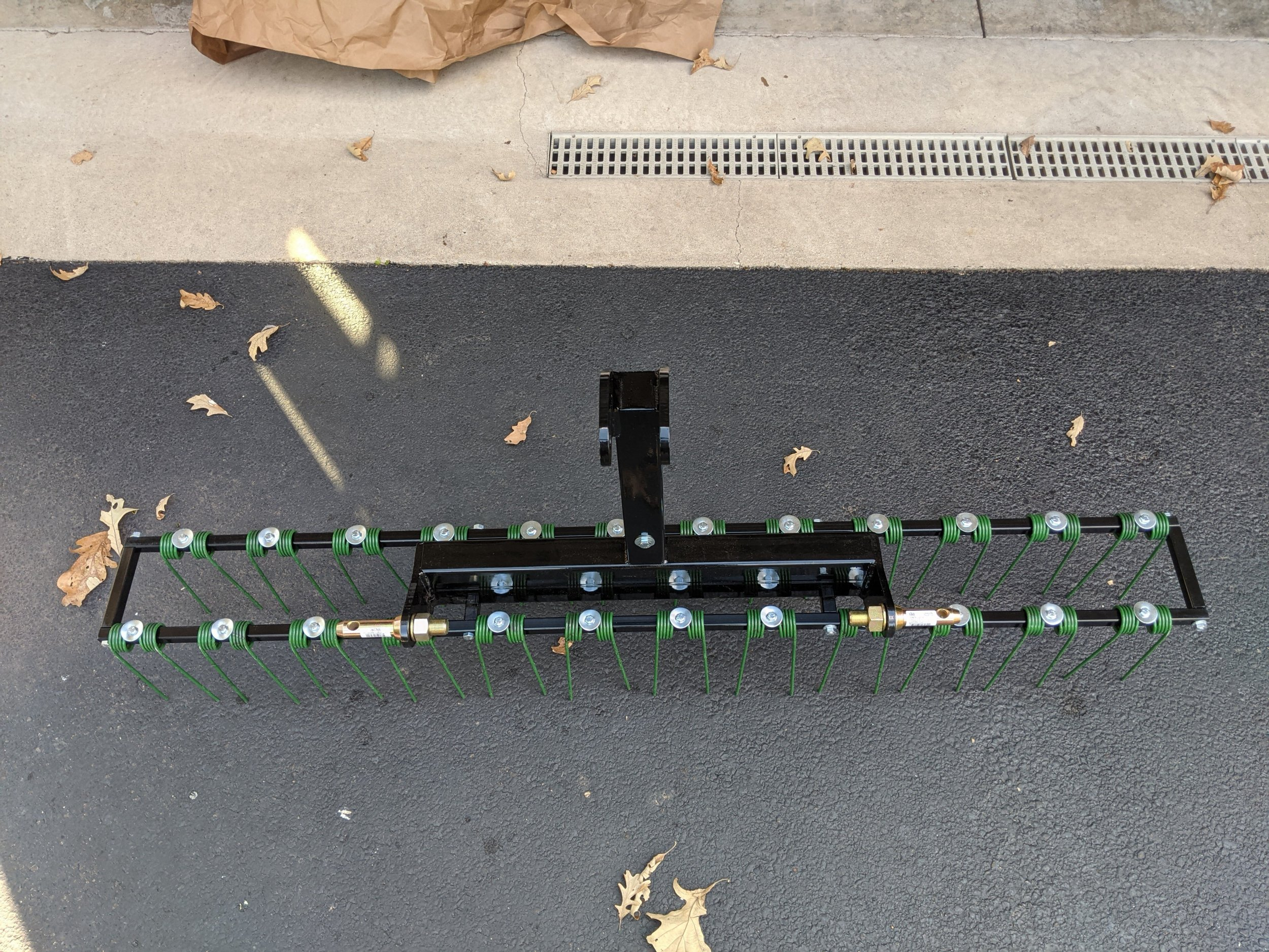

One thing I notice is that you didn't stagger the 2 rows, did you do that on purpose? The assembly instructions say to stagger them so that the front and back tines are offset from each other, which makes sense to me.
Staggering the rows would be good.
I missed that in the directions.
