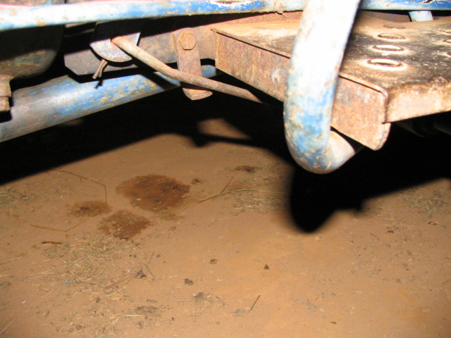

I took a look this morning and saw what looks like a hole with a pin driven through it on the clutch pedal shaft. Went out this evening and took a few pix. Here's what I got. Anybody have any ideas or solutions?
Thanks
Cecil

Just push in on the clutch and the wedge between the clutch pedal and that piece of angle should work fine. That is similar to what we did with my brother in laws JD.

Lots of great replies and suggestions here-thanks a bunch. Didn't have much going on this afternoon so I played around with it. I drove that piece out of the clutch pedal arm and did a little experimenting.
I welded this together. It's ugly but it's only a starting point.
Pictures of it doing it's job
I need to beef it up a little but I think it'll work. When I do the finished product I'll weld another piece across the top so that when I let it down, it'll rest on top of the arm instead of hanging down.
I set it to hold the pedal down but not far enough to activate the safety switch so the tractor can't be started by turning the key.
The pedal is held down enough that I can push the tractor while it's in gear so I feel like the clutch is disengaged enough.
Thanks for all the info.
Cecil
