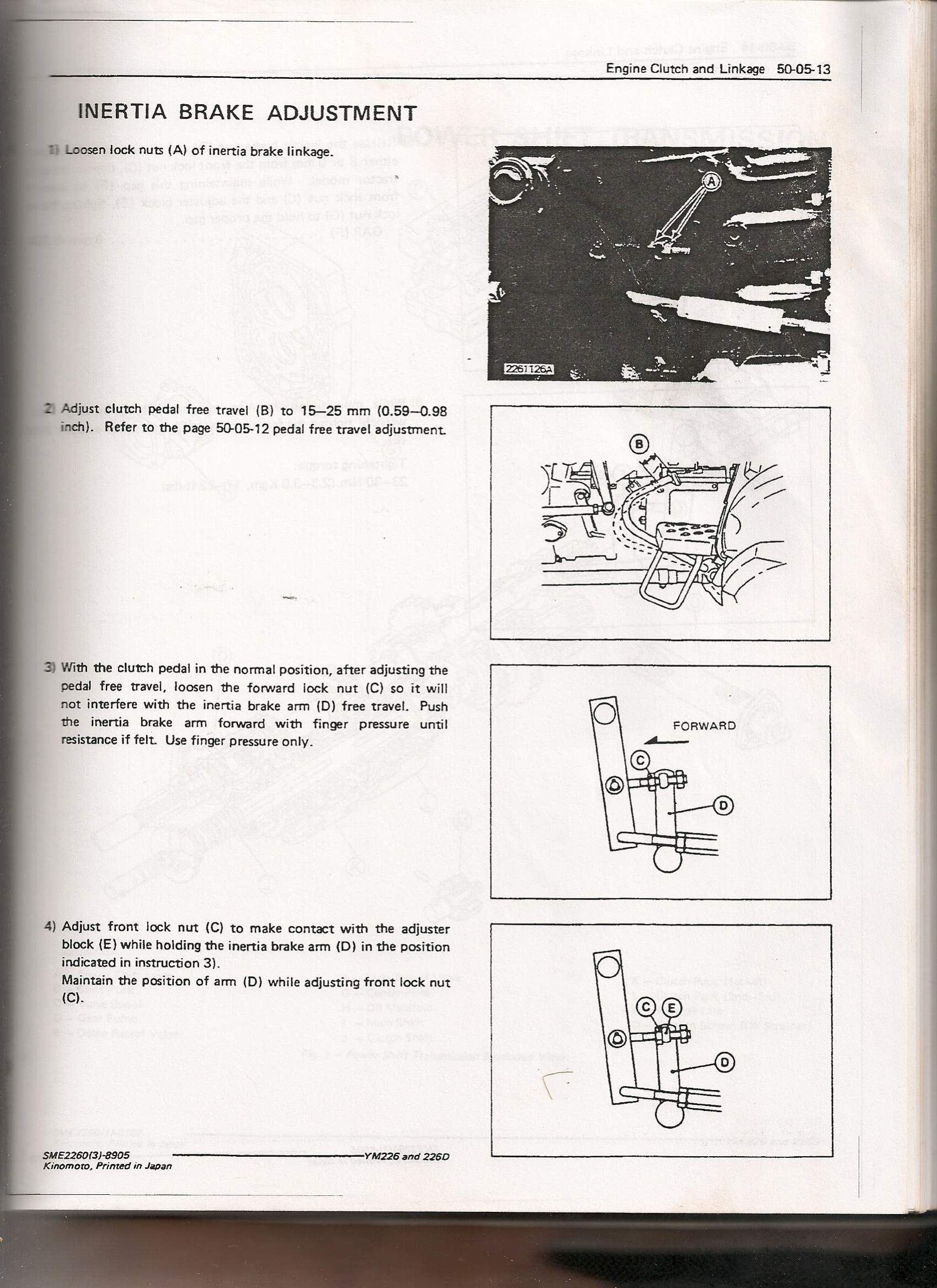

I noticed on my new YM2210 that the clutch starts making a grinding noise if I push the pedal too far. The clutch seems to be working and gears shift fine, but if I try to push it to the floor, it starts making this grinding noise. Is this normal? :confused:
There is a little metal angle under the clutch pedal (wish I had a picture to post) that didn't appear to have any function, but I tightened it up and placed it so that it stops the clutch pedal after it engages and before it starts to make the grinding. I wonder, is that what it was supposed to be for?

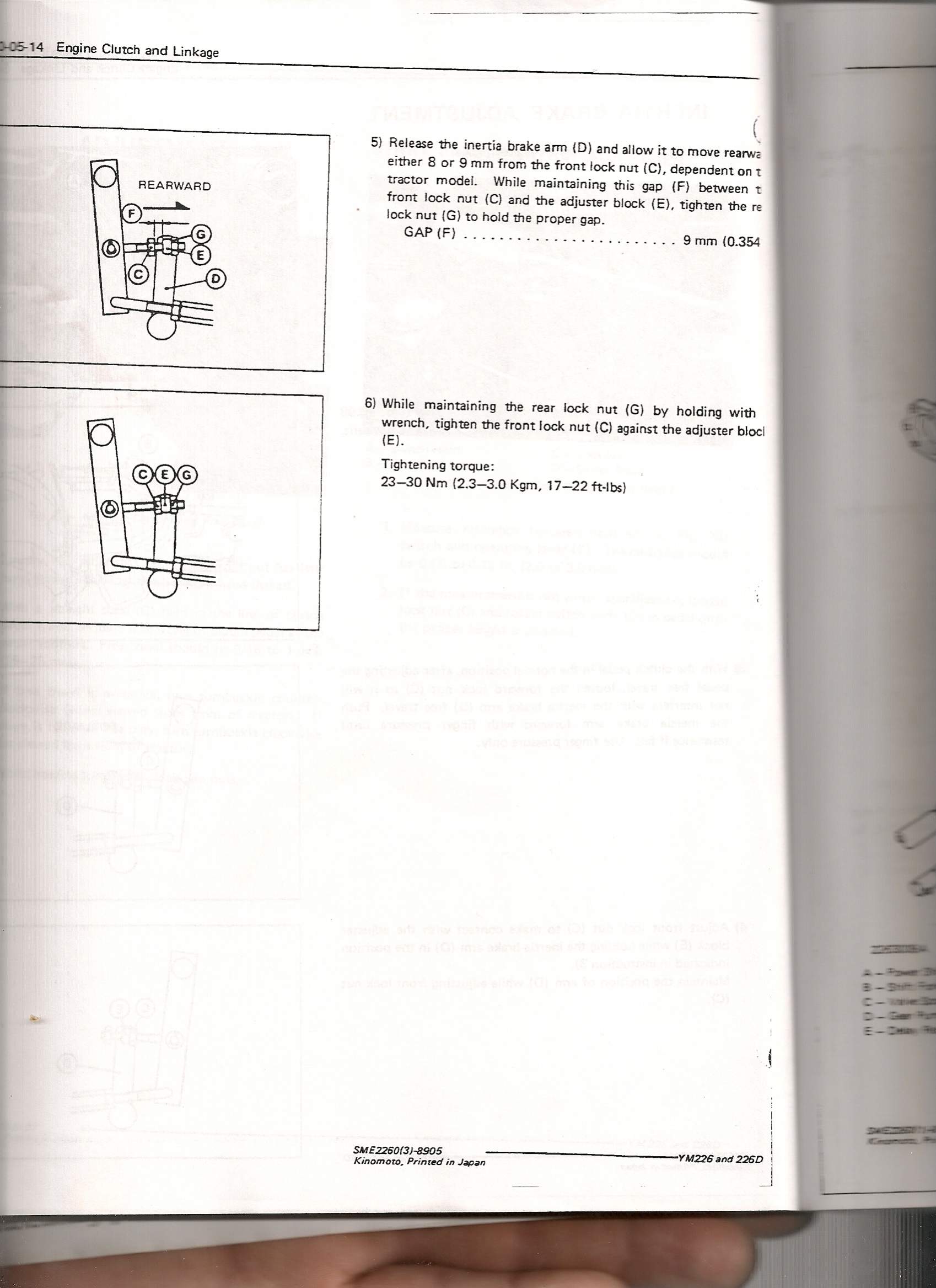

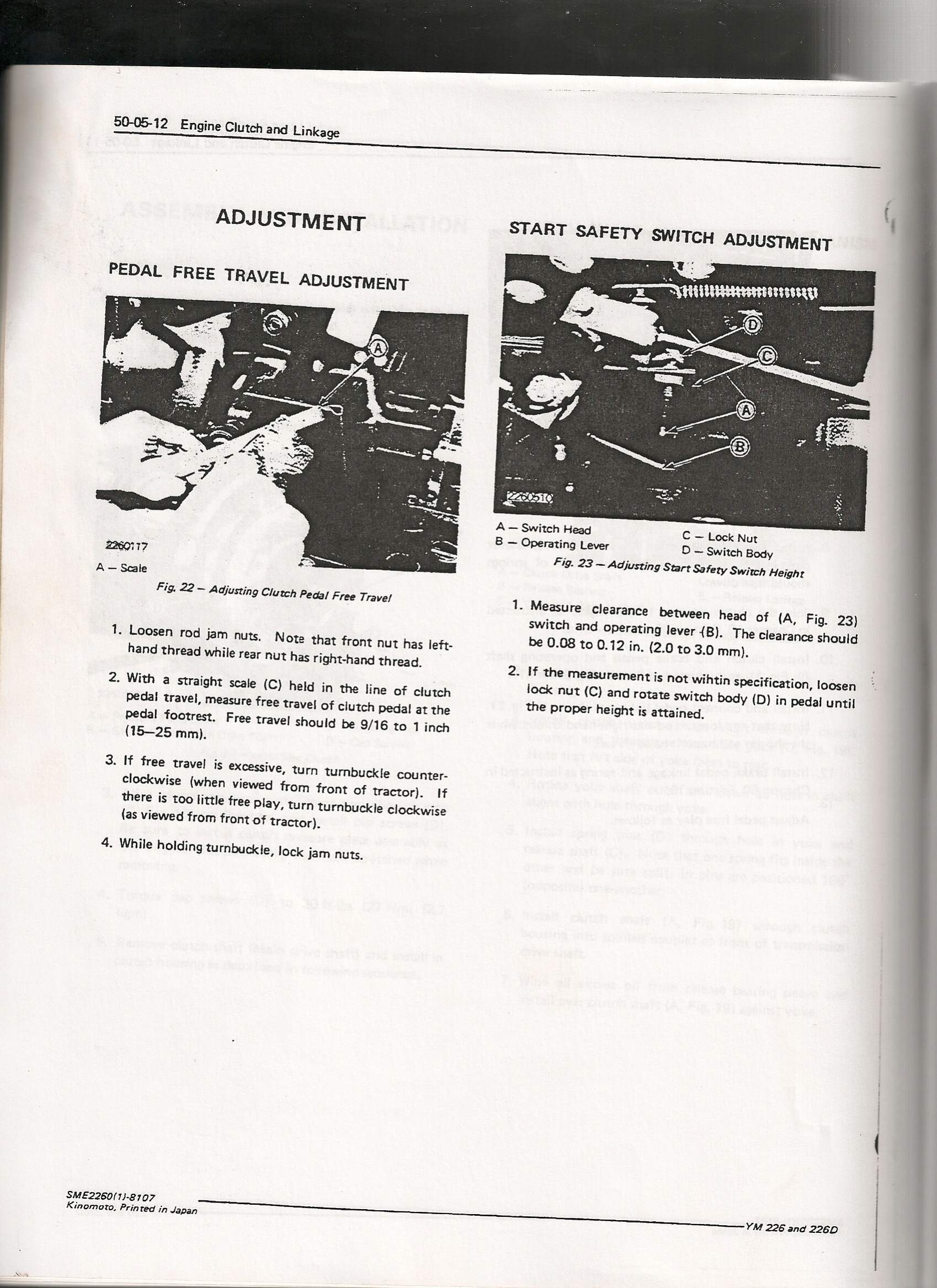

Your powershift clutch pedal actually has two adjustments. One for the regular clutch and one for the powershift inertia brake. I am not suggesting what you do but just giving you this information out of a YM226 serivice manual. I do not know if it is the closest to your 2210 or not. :thumbsup:

On my 2000 I set the Pedal freeply to a 1/2". If I recal the Manuel Spec. is around 5/8". Something tells me throw out bearing. If it's only happening when youi engage it. IMHO run like you need it to. If lets go it's under Warrenty ;)

The spec on a similar US model is about 1/2" to 1" of travel. I have this set to about 1"... do you have to split the tractor to replace the throw out bearing? *shudder* Hopefully it just works...

Clutches 101: The minimum 1/2-1" adjustment is there for 2 reasons- first to allow enough travel to disengage the clutch fully and second there needs to be enough clearance between the throw out bearing and the clutch fingers so the t/o brg is not turning at all times which can wear them out earlier.
With that said anything in between or over is ok as long as the clutch works. I think my pedal moves a good couple inches before touching the pressure plate and it works great.
On powershift machines like ours there is another lever (at least mine has it externally) that pulls on a valve inside the trans case that dumps trany line pressure so the main manual trans will shift easier.
I know for a fact it isn't a big deal whether it works properly or not as long as it isn't being pulled open all the time rather staying closed like too tight and out of adjustment for instance meaning if it wasn't even hooked up it would be better than way out of adjustment. Fact I am not so sure its linkage couldn't be hitting the pressure plate from out of adjustment???
