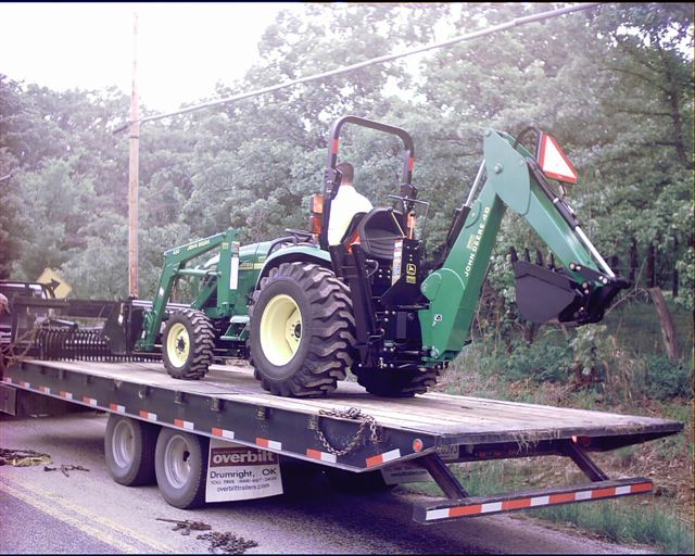

Is it a big chore to put the 47 hoe on and off, or do you just leave it on most of the time. I mow at least once a week during the summer and I store the tractor without any attachments on the back, so changing it could be a problem for me. (but I'm still going to save my lunch money to get one /forums/images/graemlins/smile.gif)

</font><font color="blue" class="small">( Is it a big chore to put the 47 hoe on and off, or do you just leave it on most of the time. I mow at least once a week during the summer and I store the tractor without any attachments on the back, so changing it could be a problem for me. (but I'm still going to save my lunch money to get one ) )</font>
Two surprises about the backhoe for me:
1. I figured that when they said easy on and off, that was for other people, not me. No, it was for me too. It really is quick and easy. The trick is a very level spot to do it. Nice big shop!!! (she says: SOON!)
2. I was told it would not be good ballast for the loader, because of all the rattlng and monkey motion. NOT! That thing is like a rock, back there and if the FEL can't do the job, spin around and sting with the tail...
The backhoe CAN work with the MMM, but who would do that?
The twist on the backhoe is that you remove the 3 point arms to install it. But that gets easy pretty fast.
I was reading about a backhoe for another "brand" and they said that two guys, using impact wrenches could get it on or off in less than an hour! It was SEVERAL hundred dollars less than my 47. /forums/images/graemlins/shocked.gif
Boy am I glad I got the 47! /forums/images/graemlins/cool.gif /forums/images/graemlins/cool.gif
