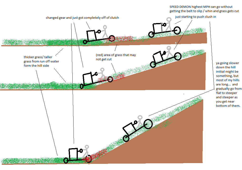

some pics, maybe help *shrugs* time to give up on these statements of mine.
I like the pictures Ryan especially since I do not have the foggiest notion how they're done but appreciate those more tech savy than I. On the very last one where the tractor is inching up the incline to get a bite on the rear blade is something I myself have at my place. It's just never been an issue. As a matter of fact, I don't think I think about it. I don't even know how I do it to have no problems but I'll check it out next time. (man this is like someone telling you "my you take your putter back far when you putt." Then you can't make a putt all day because you're only looking at how far you take the putter back.) Watch me hit my building with the rear blade for the first time as I 'm thinking "how is it you don't hit the building with your rear blade" .

The pictures don't help.
I simply do not have any of those issues with my gear machine.
