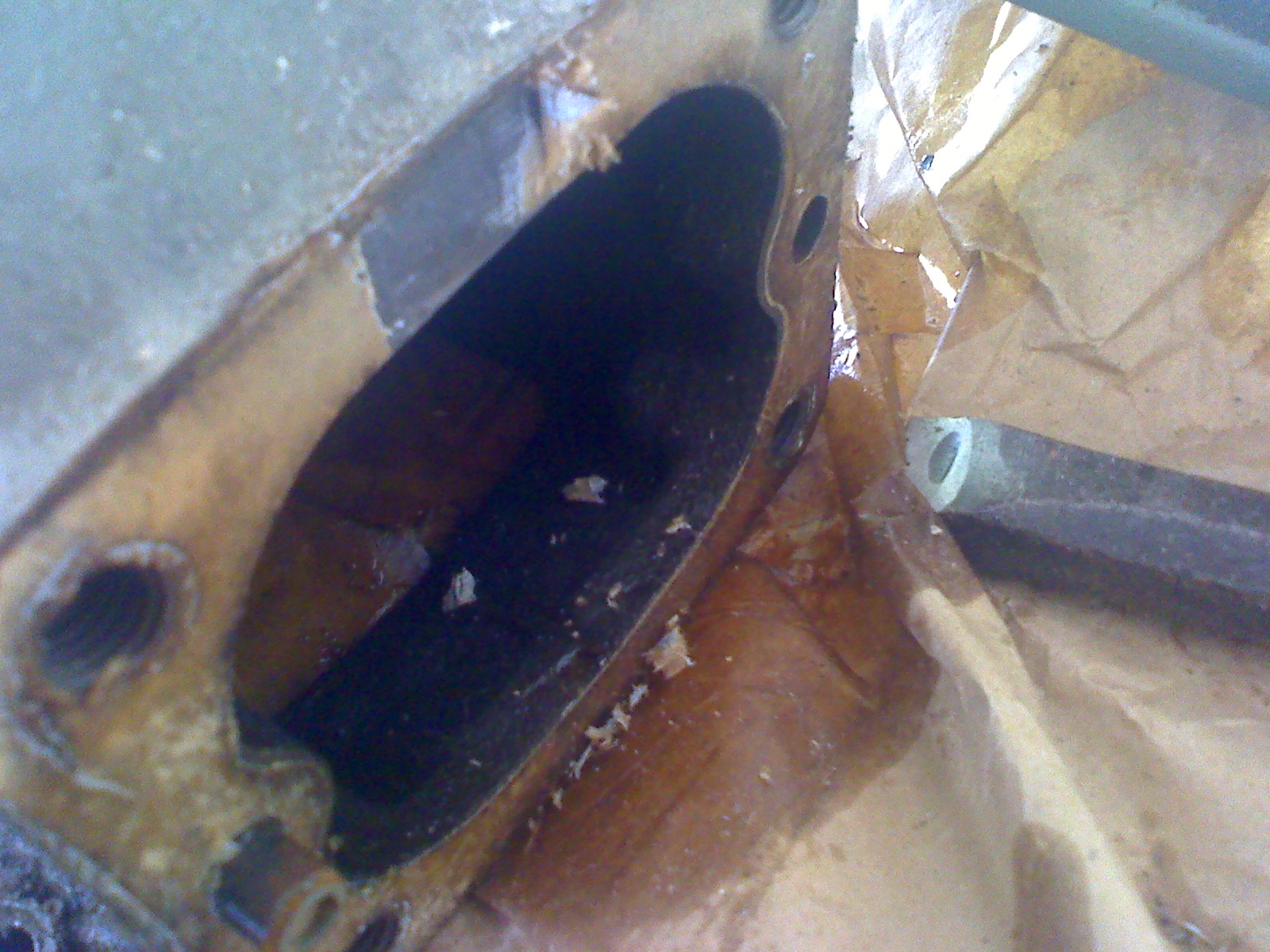

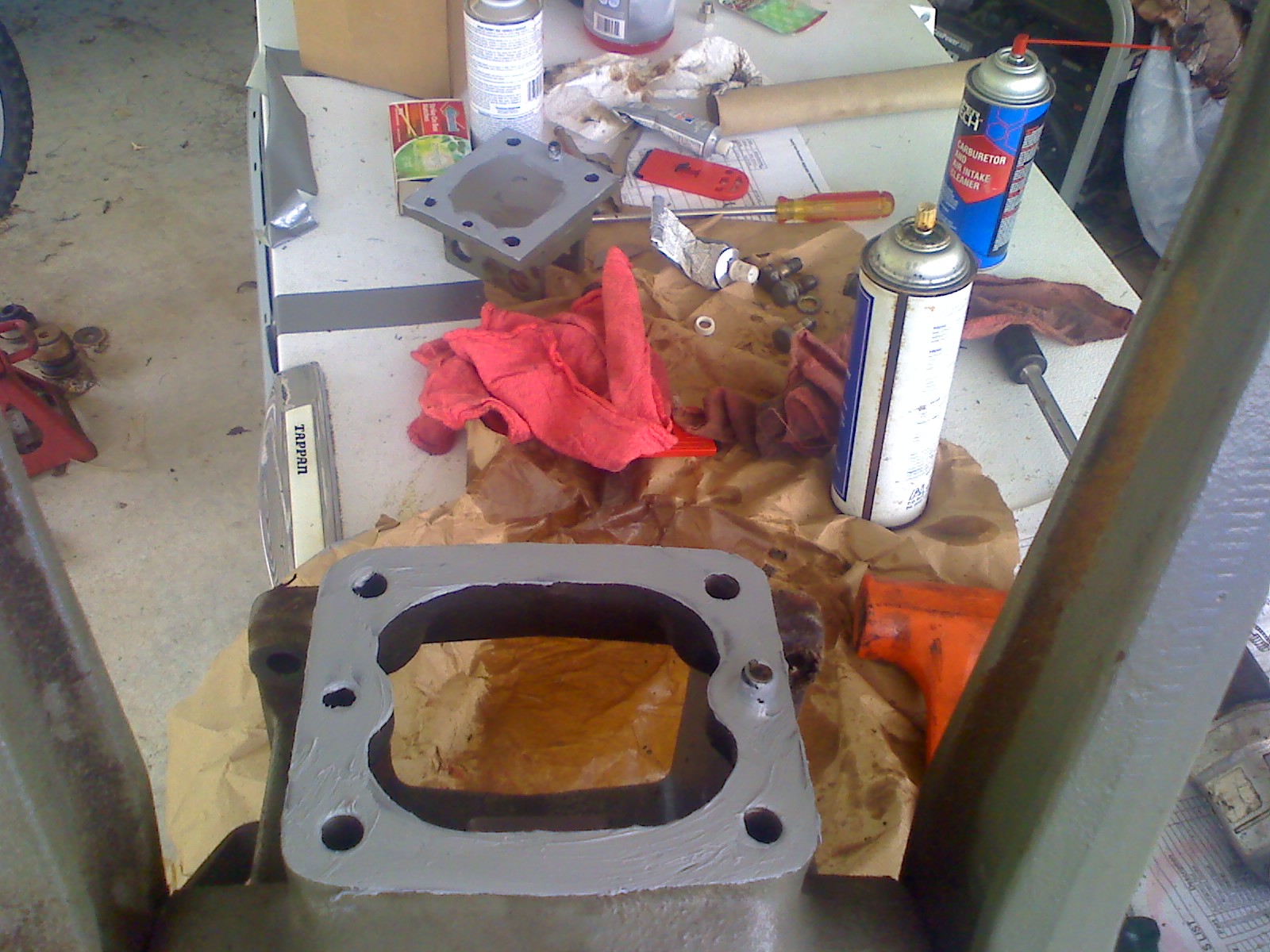

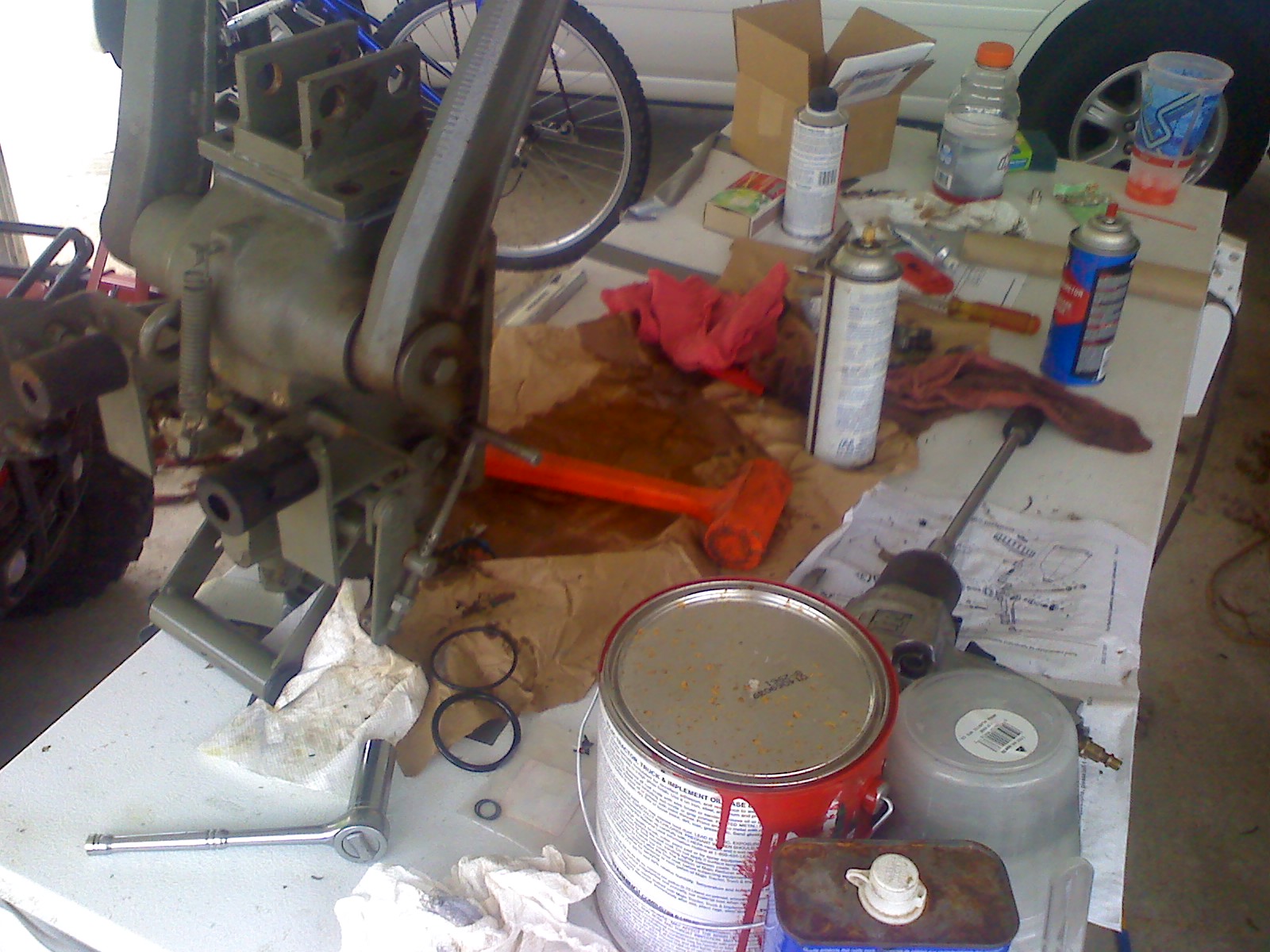

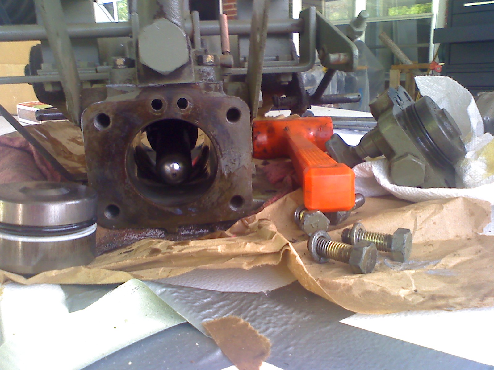

Inspired by Winston's Hydro oring replacement i decided to finially do mine. I have been thinking of doing it for over a year or more. When i bought the parts for my rear wheel seal, i bought the necessary orings for it as well. Since i had the tractor at the house i deceided to do it as well. I pulled the Hydro top off. It must weigh close to 80lbs!! It would have been way easier to pull the ROPS off to stand behind the tractor vs standing on top of the trator floor boards in reverse and manhandeling in upwards then resting it on the toolbox/ROPS then getting off and carrying over to a table.

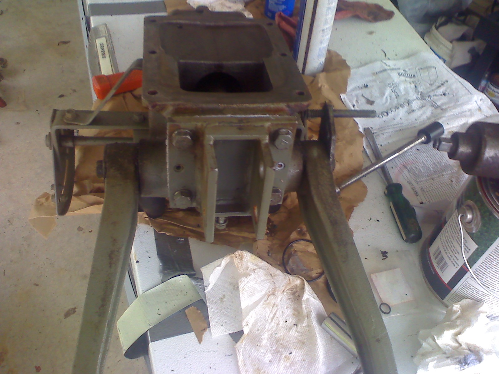

Once off i took the back off the lift then took the front off the lift, then pressed the piston out with a long screwdriver. The front of cylinder was hard to get off. I think the o-ring on the cyl head kid of seized itself in or either the top seized to the main body. It took several good whacks with a chisel to the head then plenty of whacks of a deadblow hammer to get it to move, then i was able to pyr it off with a screwdriver and pull it the rest of the way out. But for you to pull the piston out the front you would have to do the same thing i did, but you could do it without removing the hydro top totally. BUT mine was not sealed well and was leaking so i wanted to remove it and seal it up good. This allowed me to kill 2 birds at once. I also put a new o ring under the 3pt control valve, and then put 2 on the holes that i guess control the fluid flow to the piston, that are under the cyl head.
Have yet to start the tractor up, as im waiting for the silicone to dry.
But again can i say i hate whatever the refurbers use to "glue" gaskets on!! You can barely scrape it with a razor blade. I resulted to a wire wheel to "wear" it away and "eat" it down to the metal. I mean the stuff is tough. They use some paper gasket stuff and some glue that looks greyish, but is not silicone like but kind of glue like i guess. It forms very good bonds in the joints, and the paper basically tears apart leaving some on each side.
Pics to follow.
0818120955a.jpg0818121003a.jpg0818121034a.jpg0818121034b.jpg0818121157a.jpg0818121228a.jpg0818121231a.jpg0818121234a.jpg

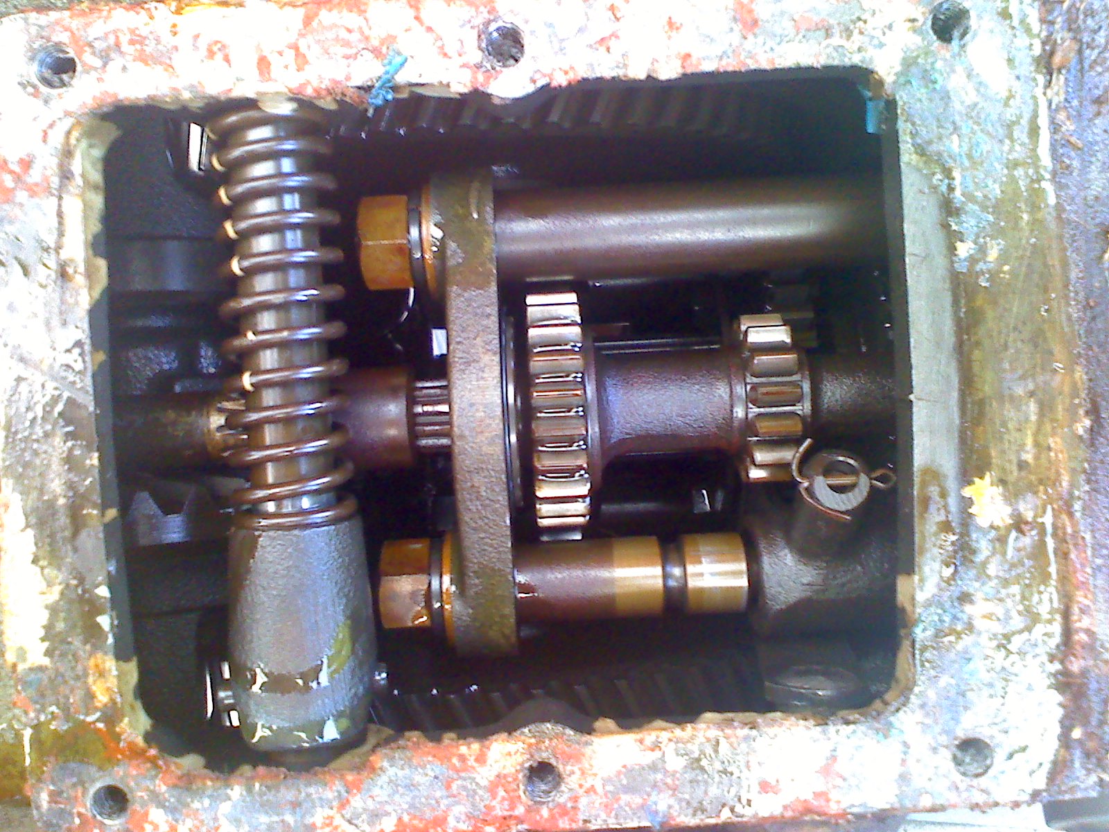

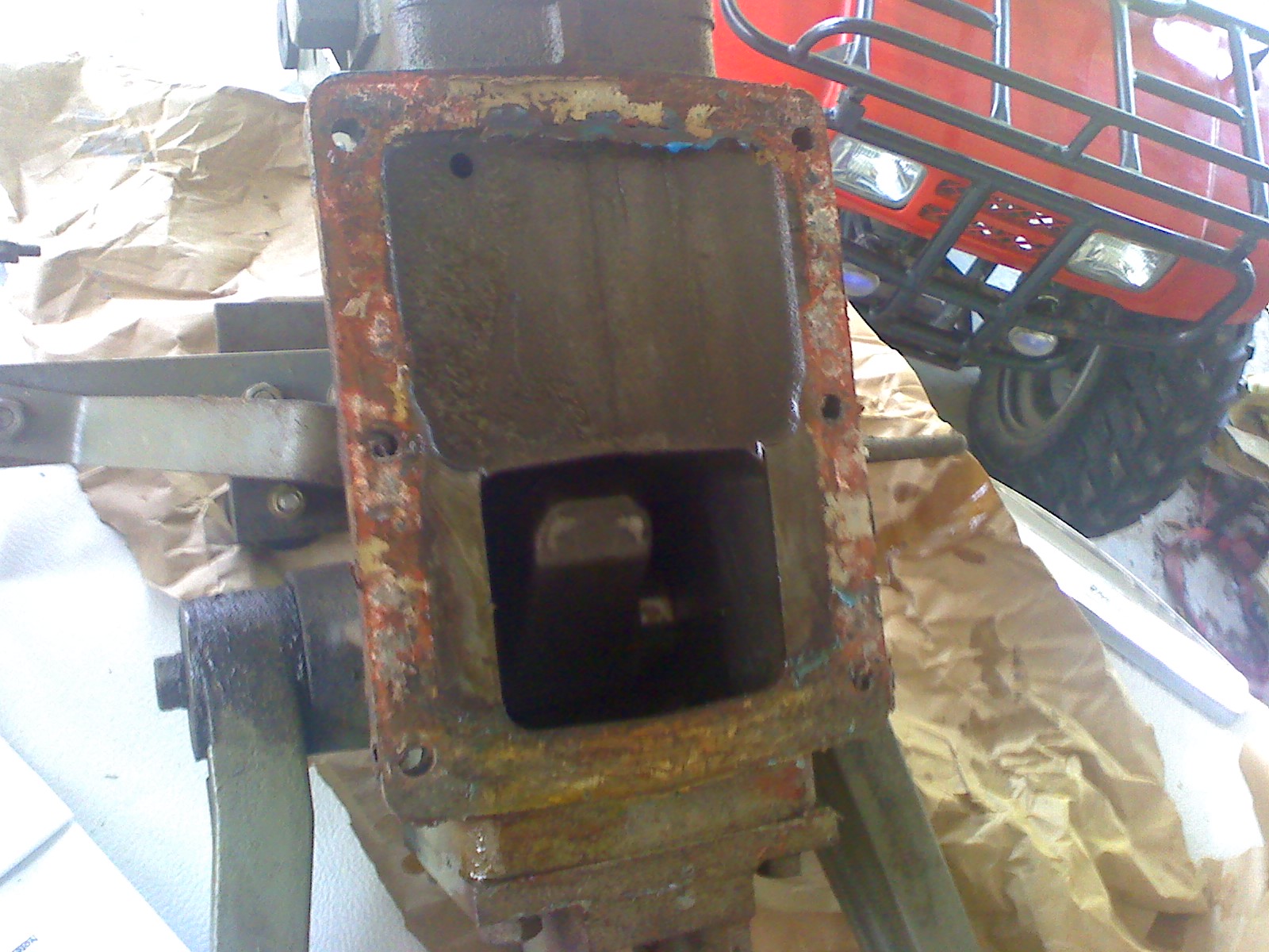

Winston kind of said this, but it is possible to get your piston out of a ym2000 without removing the whole top like i did. You can take the fron of the cyl head off and the rear and press it out. Mine would not do that though cause i had to do quite a bit of beating with a deadblow and finially a few hits on the edge of the caseing overhang with a chisel to free it up to remove it. I also had a leaky top seal to the trans that i wanted to fix.
Also i would of had to remove the ROPS to get at the back access cover but if would be possible to do it this way. If i did not have the ROPS and everything came apart it would be easy to do this in a half hour or so.

OK filled the tractor up with fluid and tested it last night. It is more responsive it seems. It also holds better than it did but still slowly, slower than before, decends when tractor is off. So slow that i could not tell, but i went insided and 15 mins or so later came back out and it decended almost to the ground from about half way up i guess. (rough estimates on height and time though)
So this leaves the valve to be the problem i guess, i have not locked out the cyl yet though with the knob. I also took the vavle off and put a new o ring on the bottom, but did not open it up to clean and check the inside as it looked super sprung and i was woried about parts flying and also reassembly.

Been almost 24 hours and its not moved an inch since i locked the valve under the seat and left my boxblade lifted. The valve has to be bypassing somehow? Its either worn out or one of those orings is worn or there is trash in it?
/ Clemsonfor's Hydraulics rebuild.
#13
Three days with the Lockout closed and not budged a half inch!! It would never do that before. The trouble is definitly in the valve.
#14
Took the valve apart and put a new oring from Hoye in there. The old one was pretty worn and flat looking. The new one looks like its 2 sizes to small compared to the old one. Long story short the ball bearing and cup fell out upon dissasembly and i did not see how it went in, so the first 2x i put it in wrong, and it was way worse than the Original oring!! FOR those who DO THIS, THE CUP FACES THE BALL BEARING AND THE NIPPLE GOES IN THE SPRING! Those that take this appart will realize what im talking about!! I had the cup on the end of it all and that was the problem. Anyway the new oring is no better than the old one, it still leaks down about an inch and a half in 10 mins or so!! This is driving me crazy. I have had 2 guys to say not worry about it including one at Hoye. I have gone this far and it bugs me! Hoye said about half of them leak like that. I dont want mine too, but i guess i will have to live with it.
Also when looking at the Hoye diagram, there appears a snap ring that holds that plunger inthe inner cylinder, well on mine it was 2 cresent shape pieces of steel round wire. You have to depress the plunger and pic them out one at the time. There tedious at first but i think there better than a snap ring to get back in. Well maybe not, i could not use a snap ring as the one i ordered from Hoye was not close to fitting!
SO to summerize im no different that i was 2 weeks ago, except im an expert on rebuilding and dissasembly of the 3pt valve on a ym2000.

I hate to hear your results. Would you happen to have a picture of ref #3 on the control valve? I'll call that the piston, probably not the correct name. Just guessing a real close tolerance between it and the control valve body is what controls leakage. I sent you a pm.

Maybe Winston, i figure thats what was leaking as that Piston thing had some rust on both ends of it some wear looking areas on the valve body.
Oh well, its perfectly fine, after all your implement is not really suppose to be in the air for days anyway, but that is how its designed, so i was trying to acheive these results.
