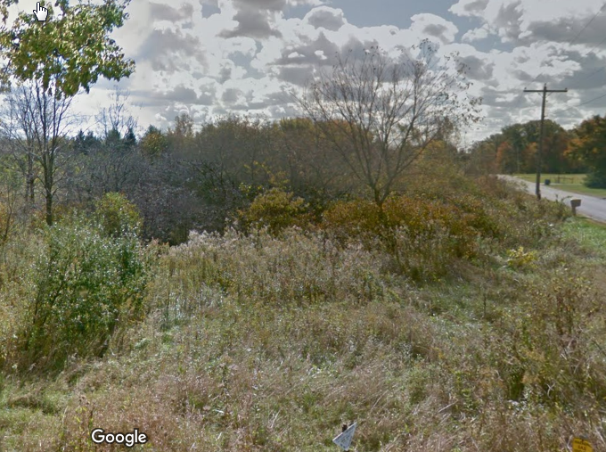

Save your tractor, rent an excavator or hire it out. I started down this path with my tractor. We had 11 acres overgrown with bradford pears, thorn trees, and generally thickets everywhere. I did what I could with the tractor, but then realized there are better machines for this work. I rented a John Deere 35d excavator with a thumb for $300 for an entire weekend. What took 15 mintues each tree with a stump bucket or pulling, took less than a minute with the excavator. I could grab the roots with the thumb and pull them out. I used the little dozer blade on the excavator to fill in the hole.
When I was done, I put the scarifiers down on the box blade to pull small roots out, and remove debris, then level with the blade. Below is before, and after:
