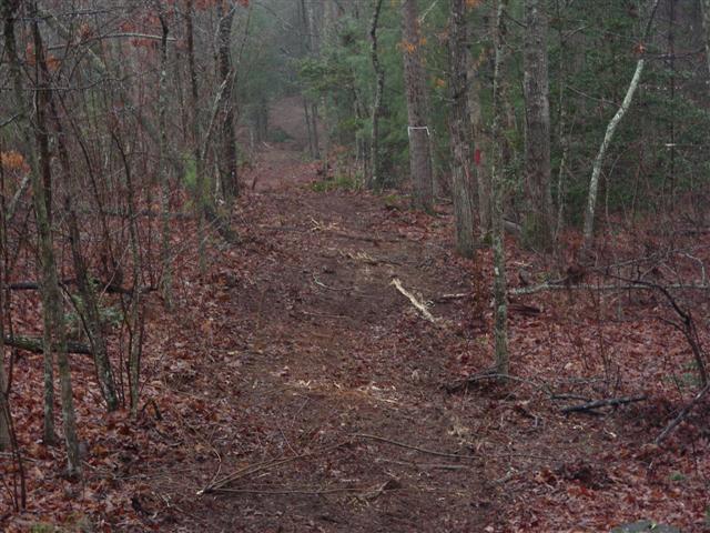

The picture of after the brush cutter.

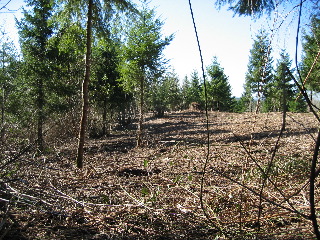

Steep terrain is not a problem as long as the ground is dry. I went up and down some really rough areas but my only problems came from the tracks slipping on the wet clay. Rocks are not it's strong suit but it doesn't break it. You can hold the head up a little so the rocks pass under and the head only cuts the brush. This would not give you as good a finish but it's better the doing it by hand. The attached pictures don't show how steep it is but in some places the RC100 would not climb the hill. It those cases I would go side ways until I found a better spot to climb.

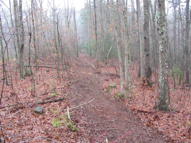

Another picture. This picture and the one before are of our west property line. The loggers removed all the large trees in the 20' band along this line about 6 years ago. It had grown up so thick it was hard to walk through in places. The line is about 1500' long and I cleared it like you see in about 1.5 hours. I did follow the machine with a pole chain saw and cut the over hanging branches. That took about another 30 minutes.
