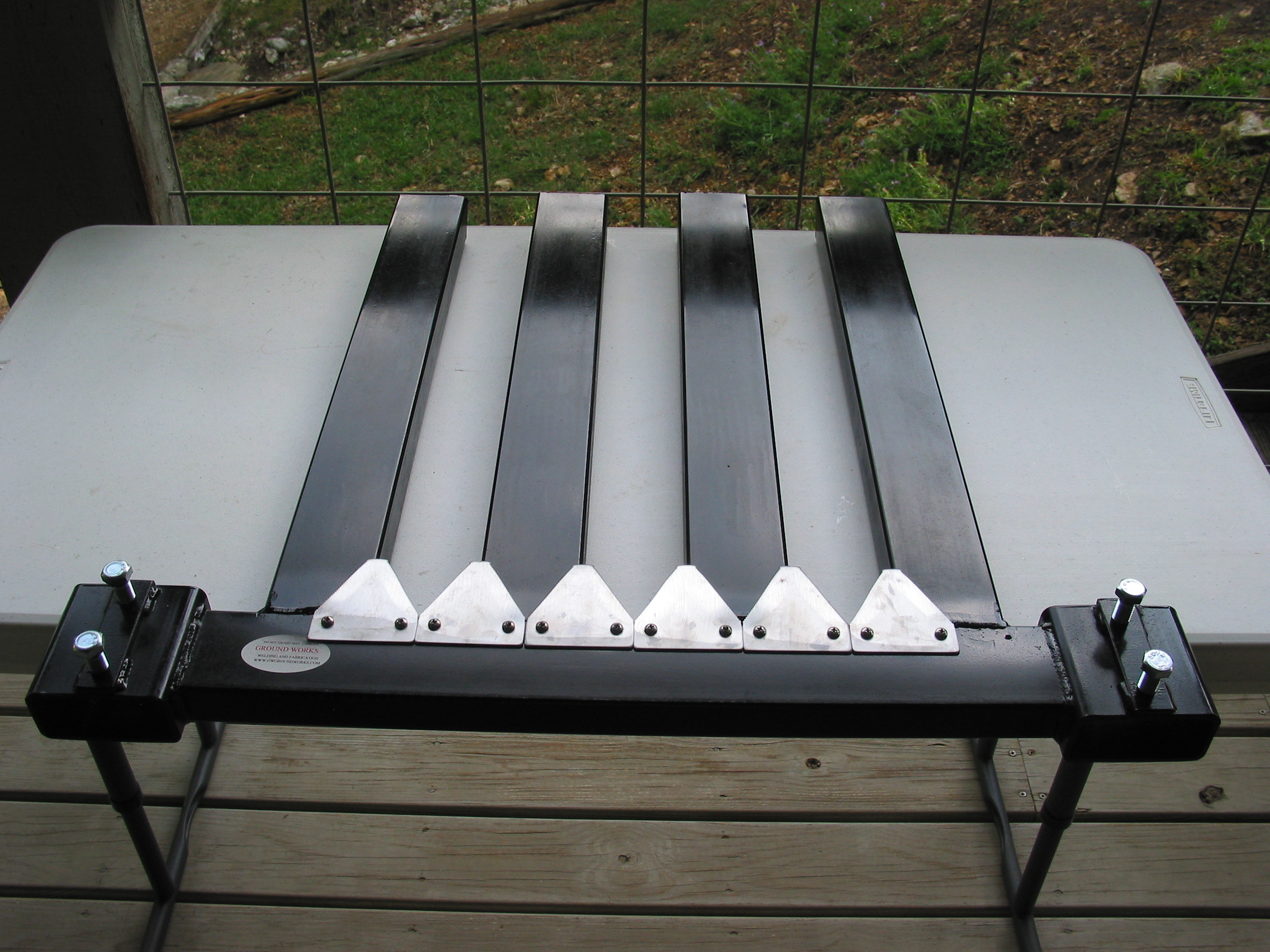

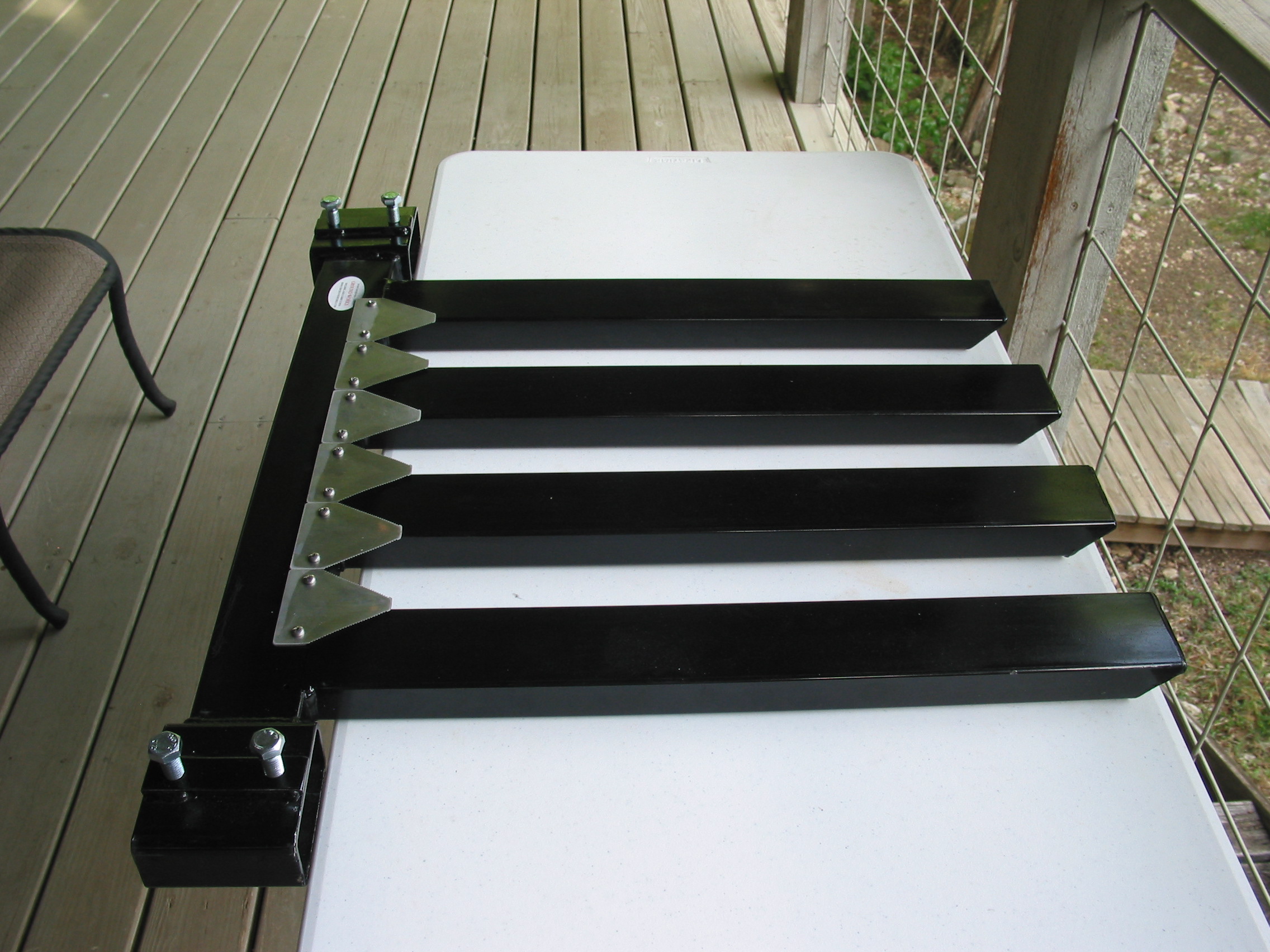

I ordered this "debris fork" which clamps between pallet forks. I modified it by bolting on some sickle bar sections. I'm hoping to push it into a pear until it is cut off at the base or torn out by the roots, tip the bucket back and haul it to the prickly grave yard. This might help prevent dropping pieces which will grow back with the first rain. I lay out piece of thick polyvinyl and pile them up. Like this they will rot and finally dry up without taking root.

Looks interesting. Let us know how it works.
/ Clearing Prickly Pears #3
Yep, that's interesting, and it'll be even more interesting to learn how it works. My limited experience with prickly pear has been that almost nothing works.:laughing:

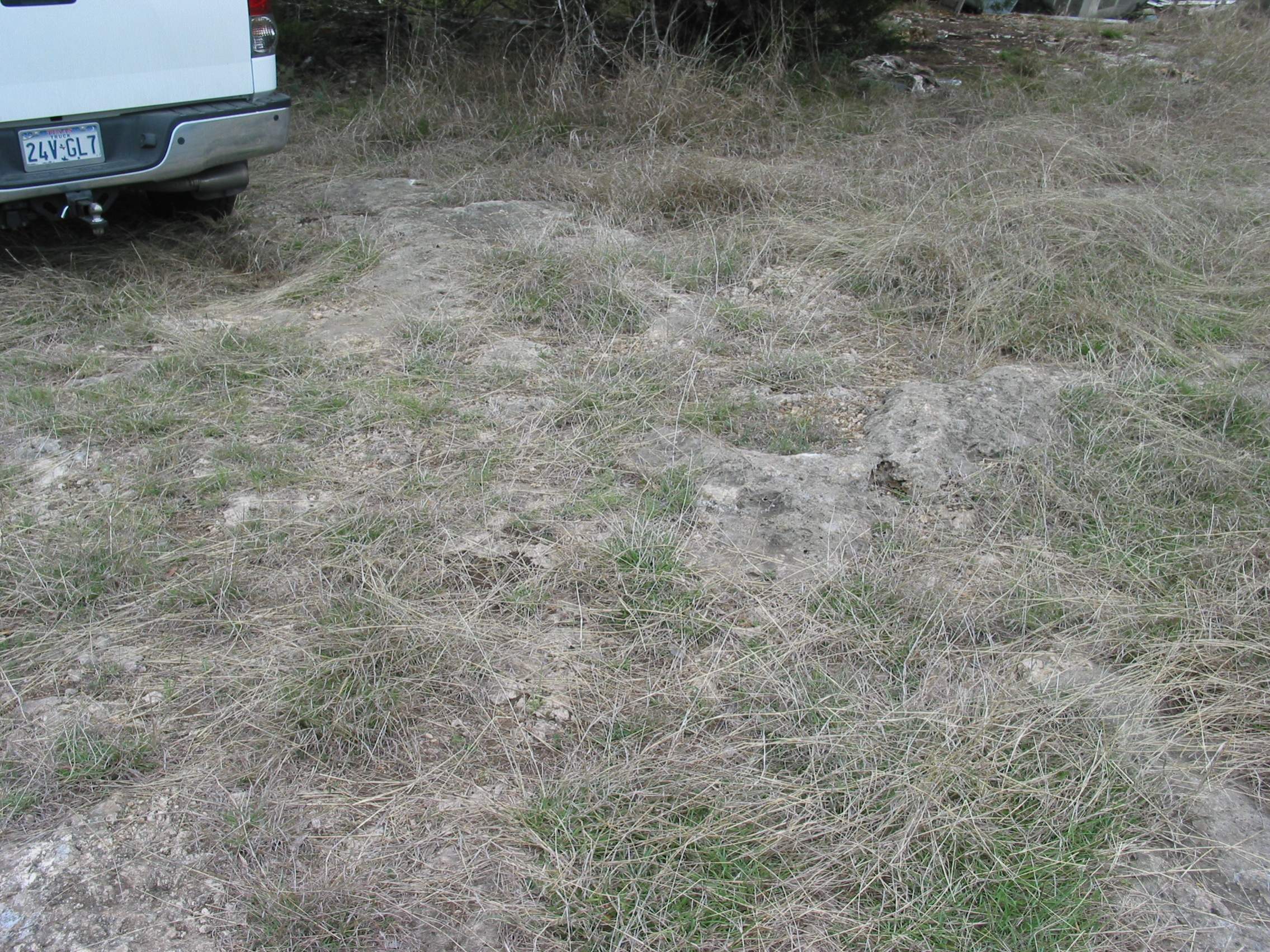

Here you go, no top soil. I don't see how they even grow, but they do it well.

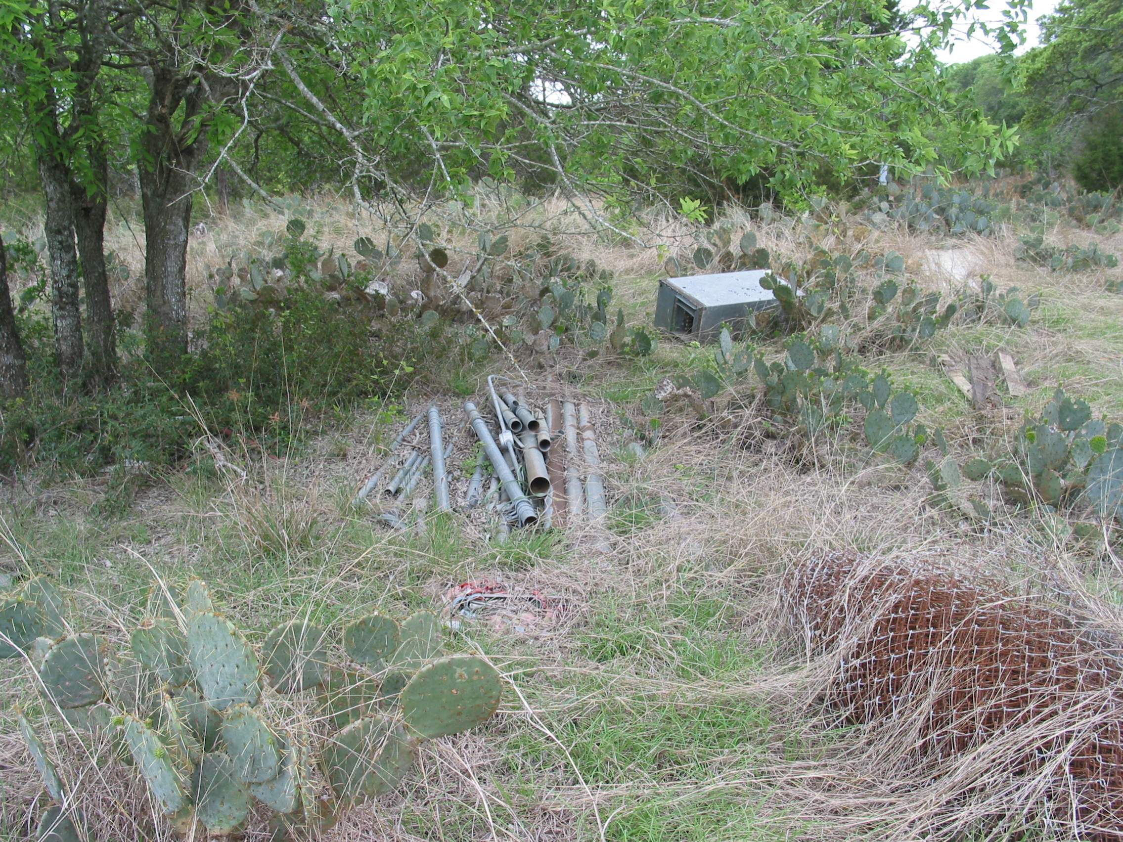

This is somewhat representative of 6 acres that I need to clear of trash, brush and pear. I want them gone so that I can work the area by this fall and cut it with a bush hog. Spraying would be an option if I had a year or two.
