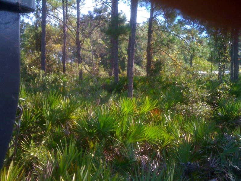

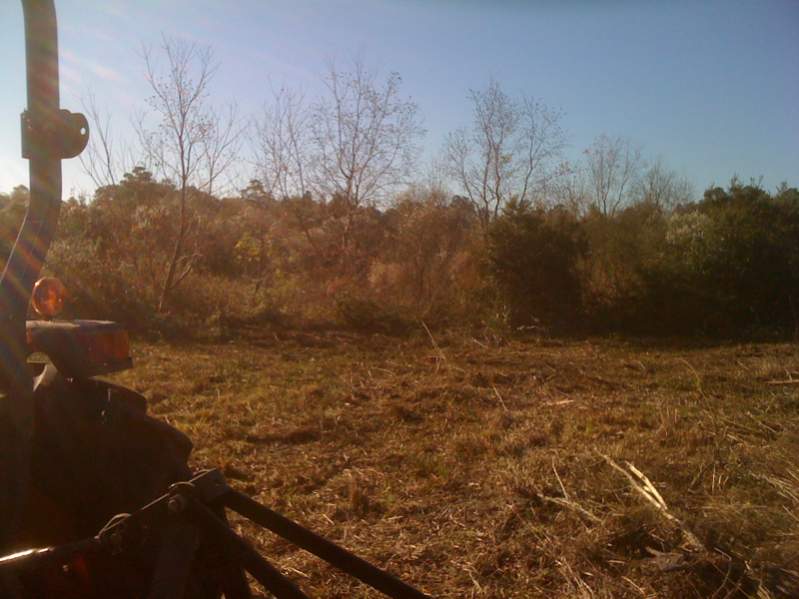

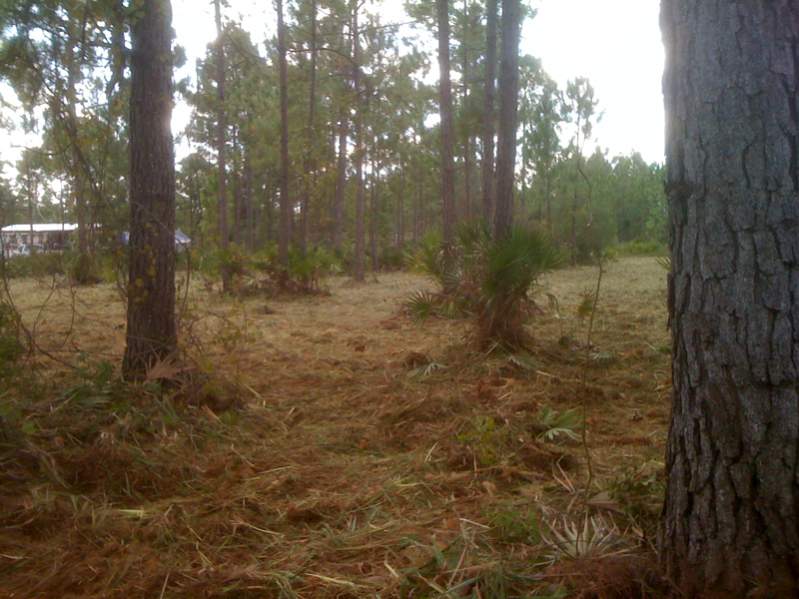

These are some pics the first two are of a 65 acre job that we used two tractors with heavy duty bush hogs ( RCR 2672 Landpride) it took 8 days
The second set is of a 3acre job that took 6 hours with one tractor
It takes about 2hours per acre

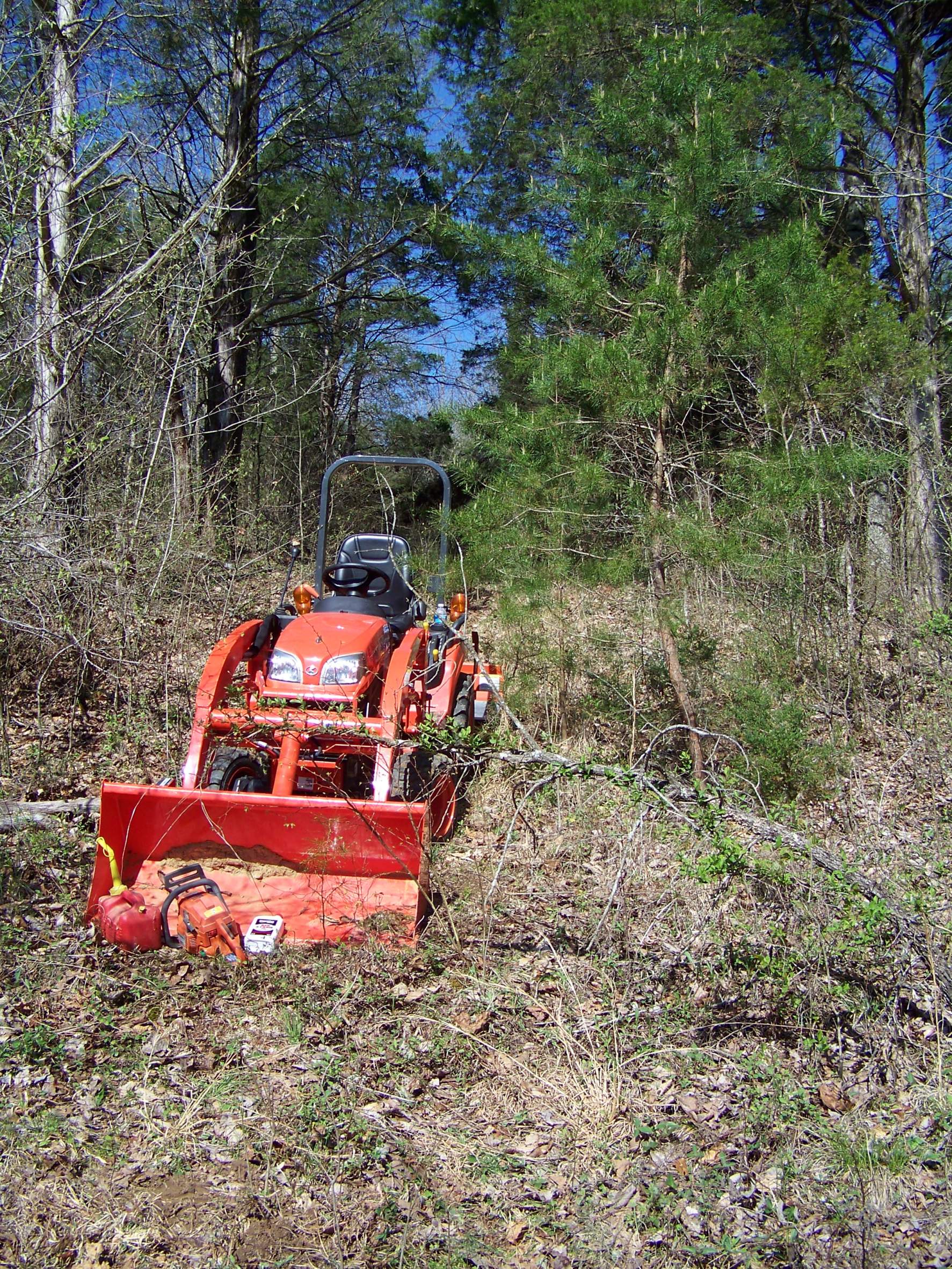

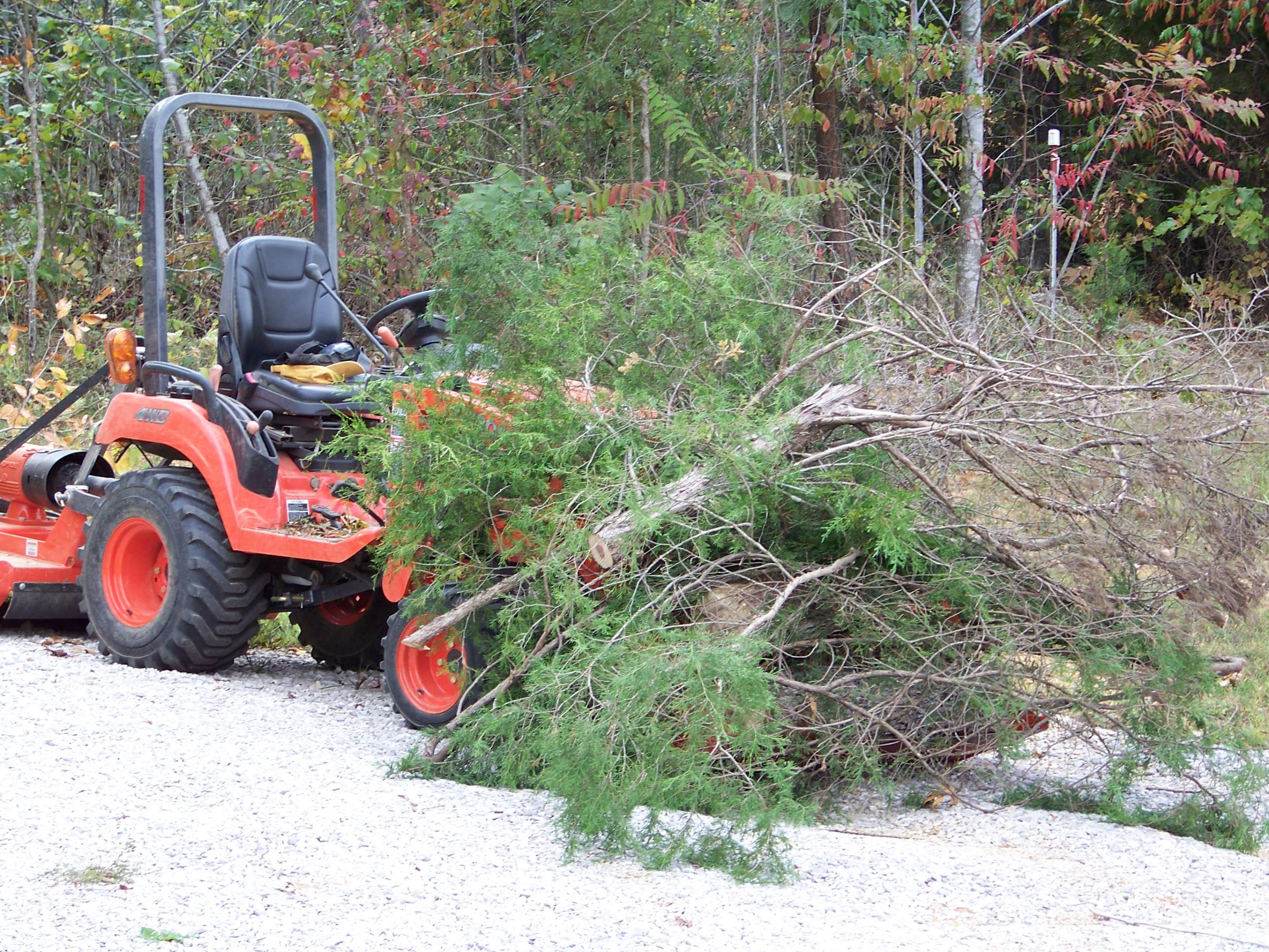

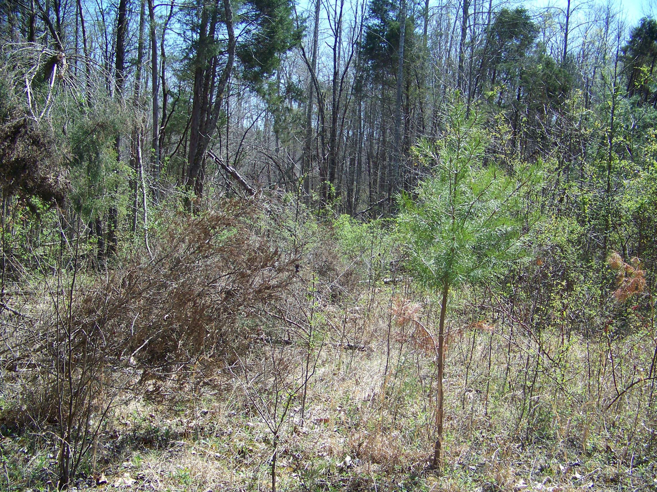

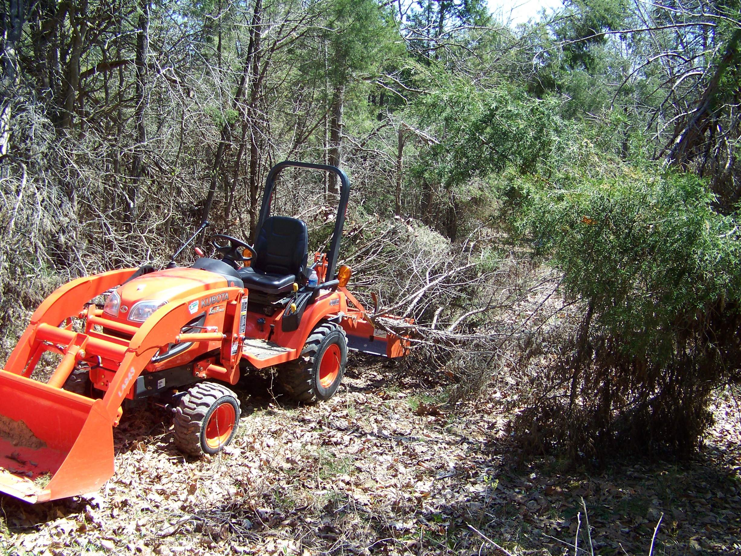

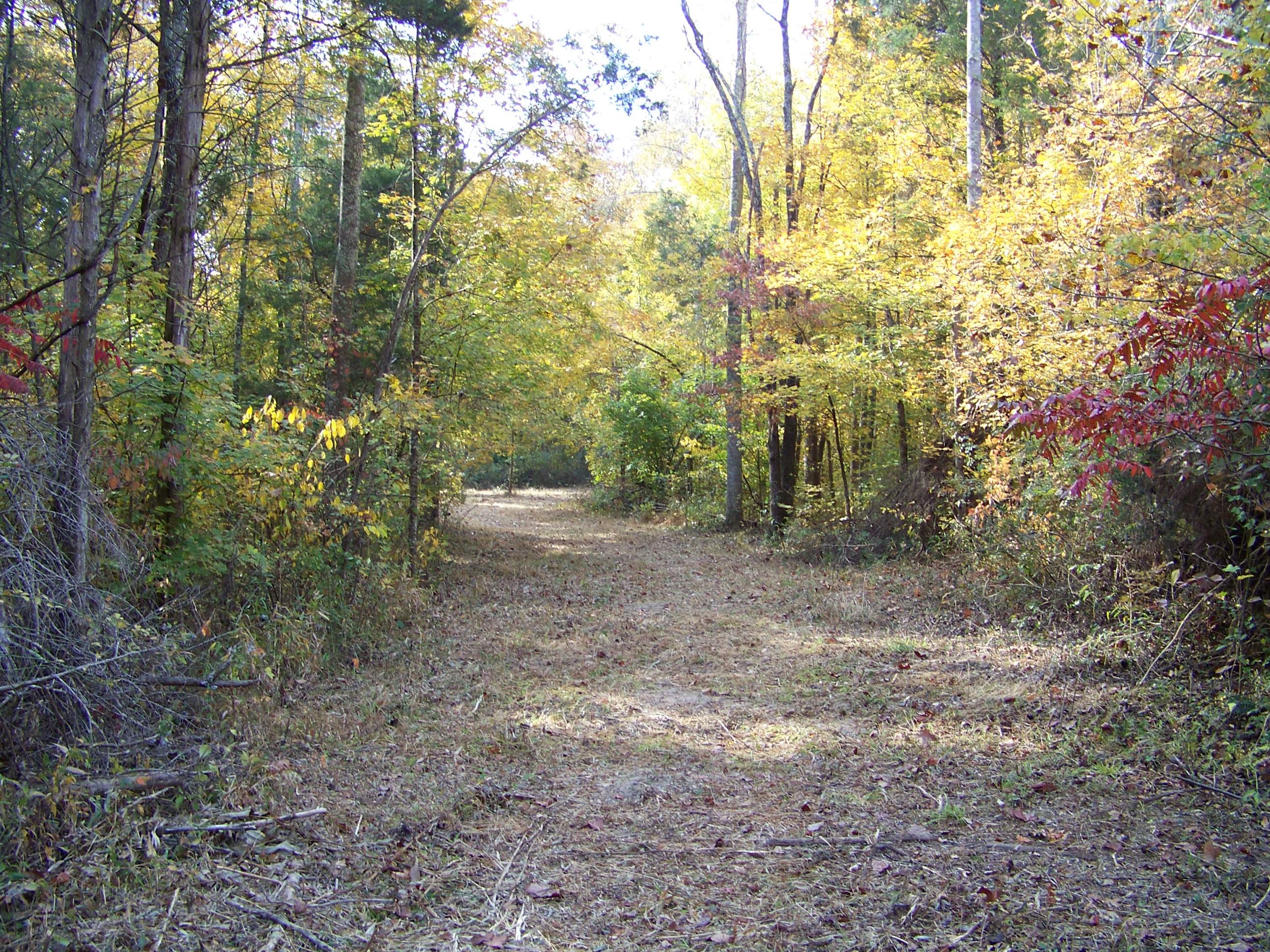

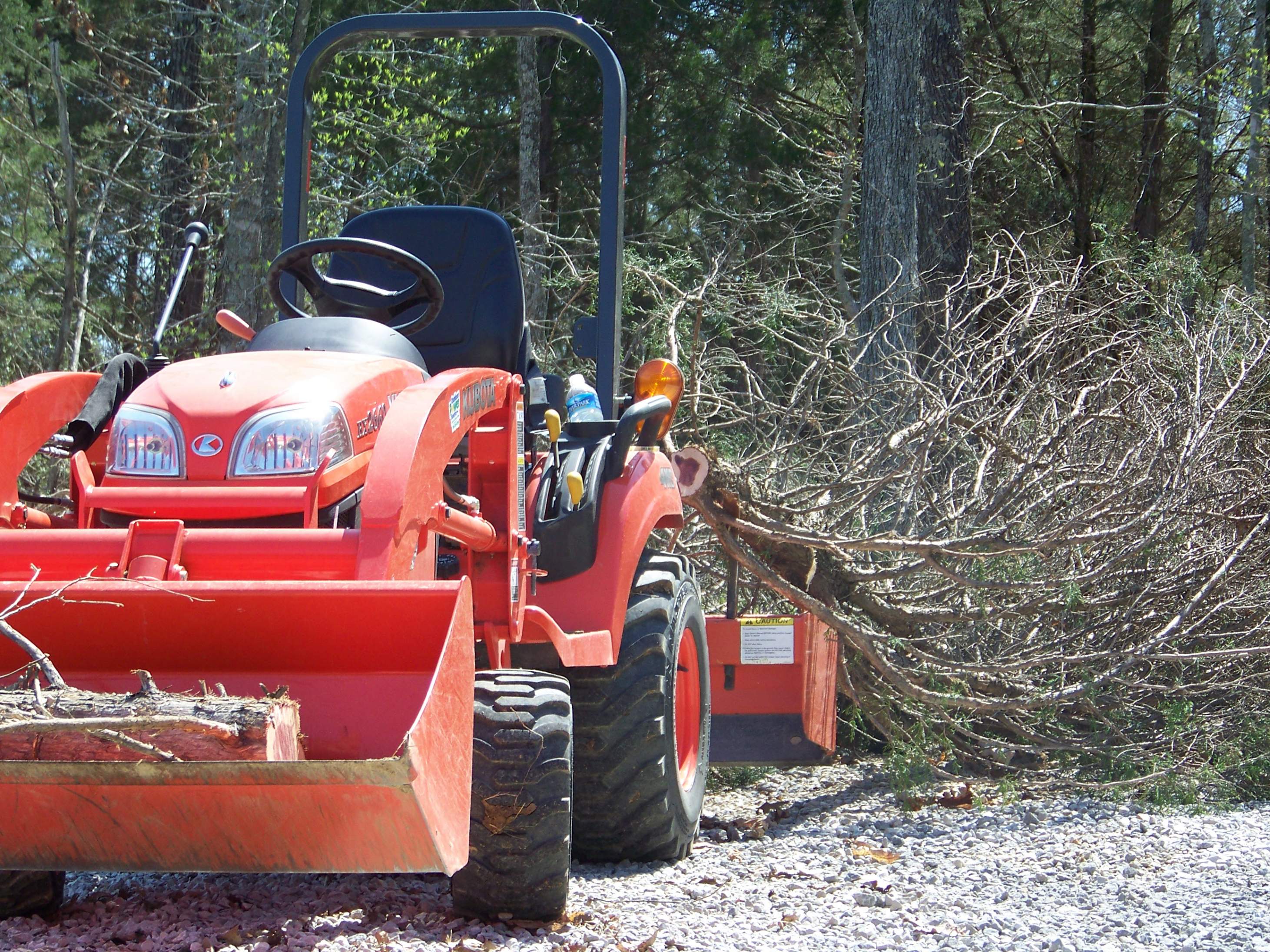

I'm not sure if you can clear 12 acres with 40HP tractor and a chainsaw, but you can clear 6 acres with a 26HP tractor and a chainsaw...;)

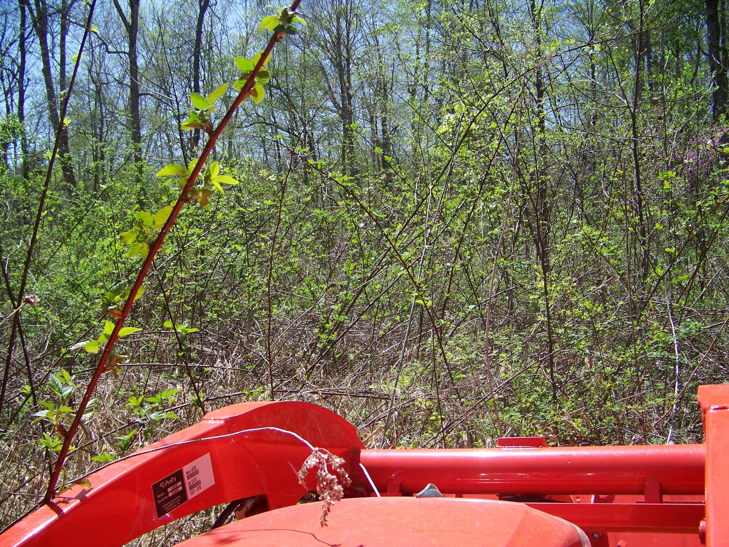

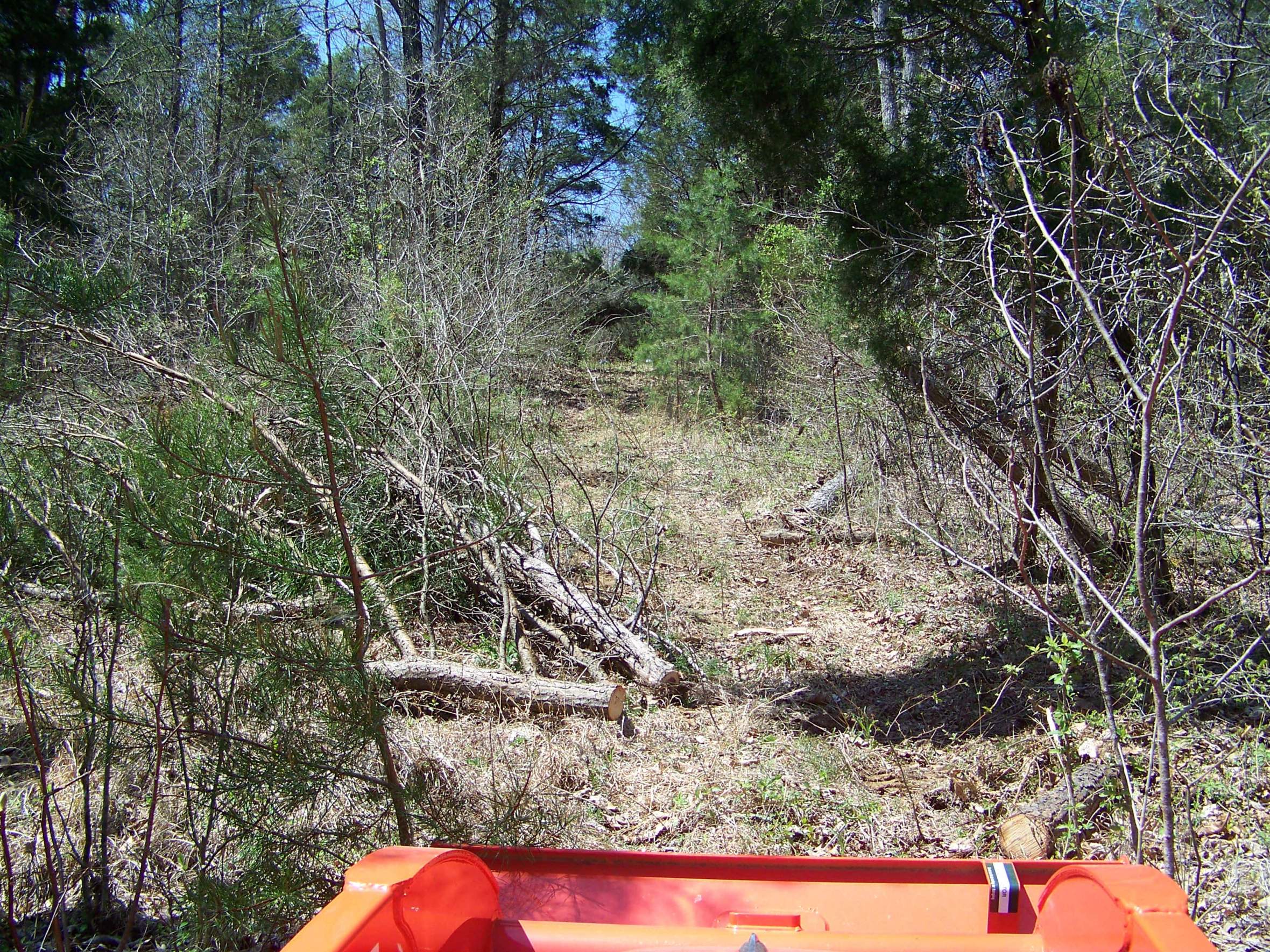

Plenty more pics...
