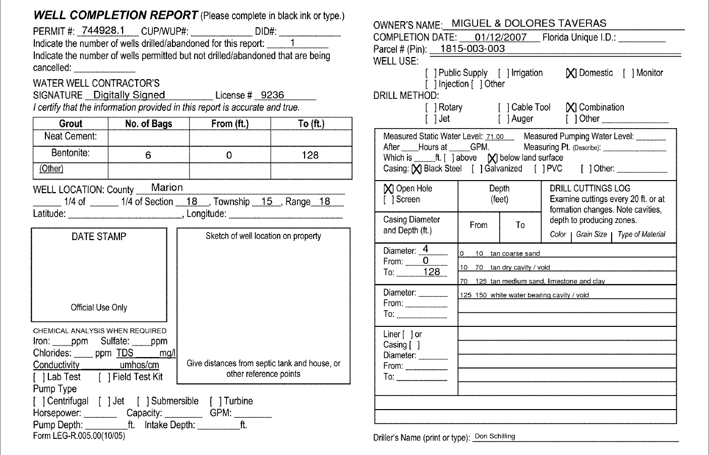

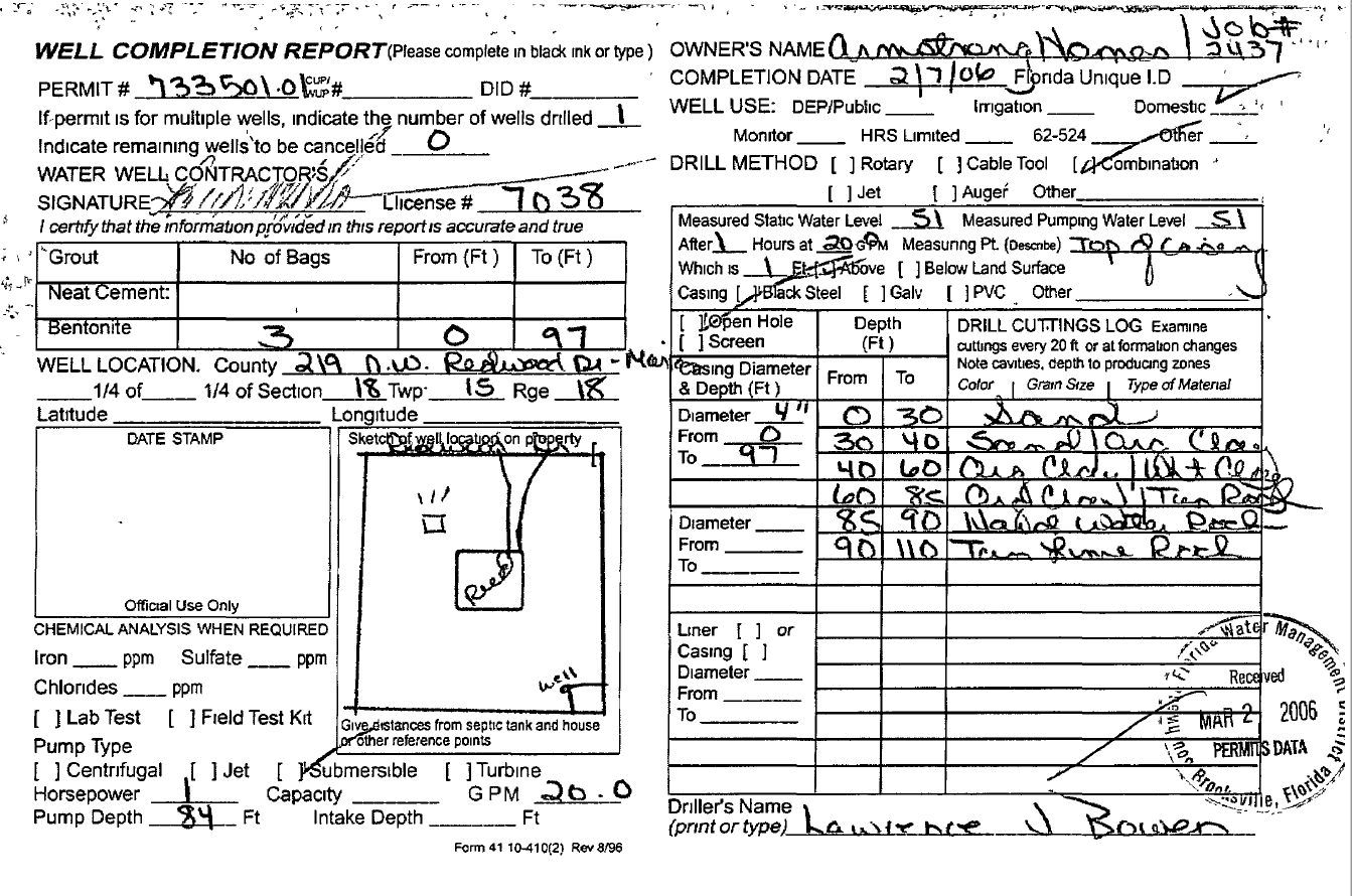

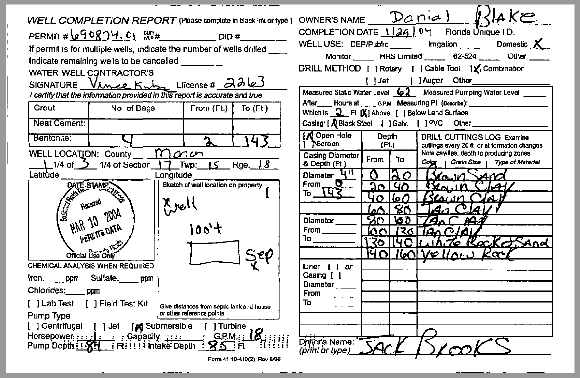

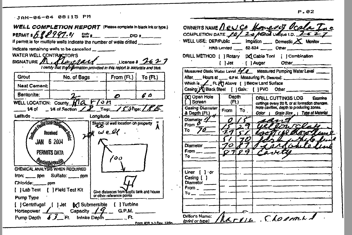

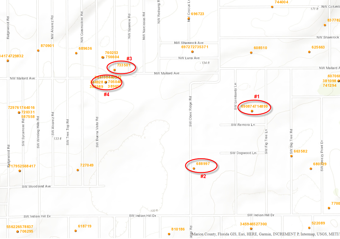

Yes, the Rainbow Springs well is far enough away that it might not be applicable to drilling on your property, Jason.
Mark's idea of checking for a state database of drilled private wells seemed more promising. Here's the link that you need if you want to do more looking around:
http://www21.swfwmd.state.fl.us/maps/pages/viewer_wcp.html
Since I was in there anyway I saved the well completion logs from four wells surrounding your property. All within half a mile. The "Measured Static Water Level" ranges from 40 feet to 71 feet.
Chris

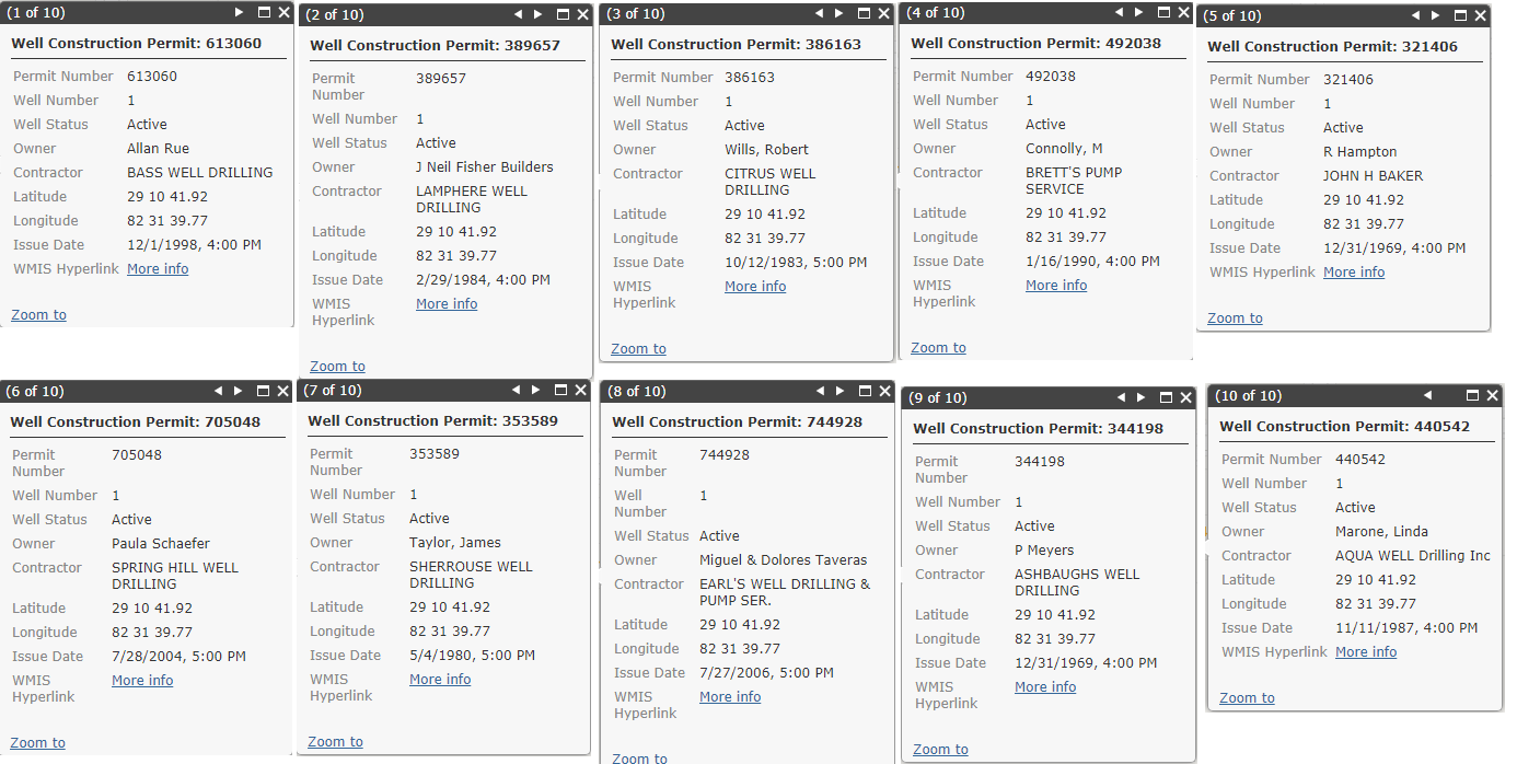

You're welcome, Jason.
If you're going to visit your neighbours, I'll give you a bit more info. I was curious about the 10 well drilling permits that show up in the details for the well that I called "Well #4". They date from 1969 to 2006 and were issued to ten different contractors. Those folks might have a story worth listening to.
Chris
