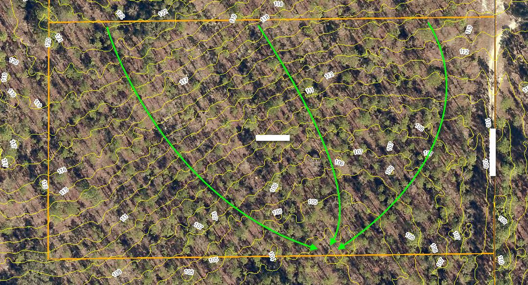

Mark's response (post #36) left out a few details, so here are the steps in great detail:
- Click the link to the Marion County GIS viewer.
- After it finishes loading, click "Parcel Search" in the "Basic Tools" menu.
- Input your parcel ID into the rectangle and click the "Search" button.
- After it finishes loading, at the bottom-left of the screen click the tab heading labelled "Layers".
- Click the plus sign to the left of "Elevation Information" to open up a sub-menu.
- In that sub-menu, click to select the checkboxes next to "Contour Labels (1 ft)" and "Contours (1 ft)".
- If you want to also see the satellite/aerial photos like in the picture that I uploaded, then in the same list where you found "Elevation Information" scroll down and click the plus sign next to "Aerial Imagery".
- In the sub-menu that opens up, click to select the checkbox next to "Aerials 2017".
By zooming in and out (making the magnification bigger or smaller), you should be able to get the exact picture that I got (except that I blanked out your parcel ID and another identifier so that I didn't give out any information that you had not already done). You can do that using the plus/minus signs at the top left of the image.
A contour map shows lines of constant elevation. If you walk along any of the lines you're not gaining or losing elevation. The numbers indicate height above some reference level. I'm guessing that in Florida that the "122" at the top-left of the image (north-west corner) means 122 feet above sea level. The reference elevation doesn't really matter, though. You're just interested in the difference between the numbers on your property. I see "122" in the north-west corner and "104" along the southern border (near the centre east to west).
Since the contour lines shows constant elevation, drawing a line that is perpendicular to the contour line shows "straight downhill" or "straight uphill" depending which way you're looking. In the following picture I've drawn three lines that go roughly perpendicular to the contour lines. It seems from your other thread that you're in a dry area, but if surface runoff was an issue the green lines congregating at one point show a place where it probably wouldn't be good to build a house.
