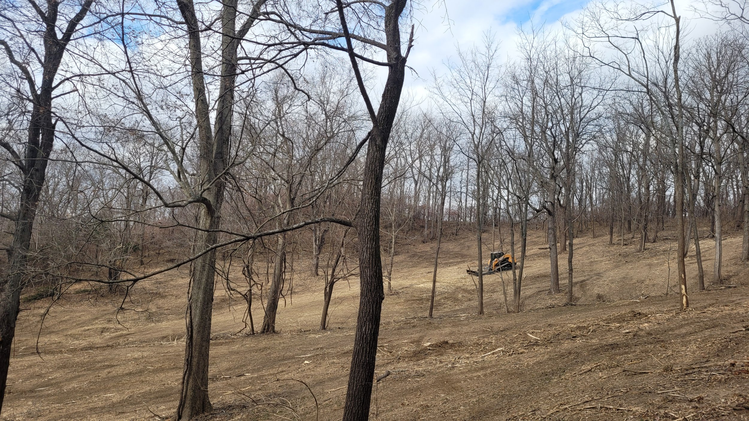

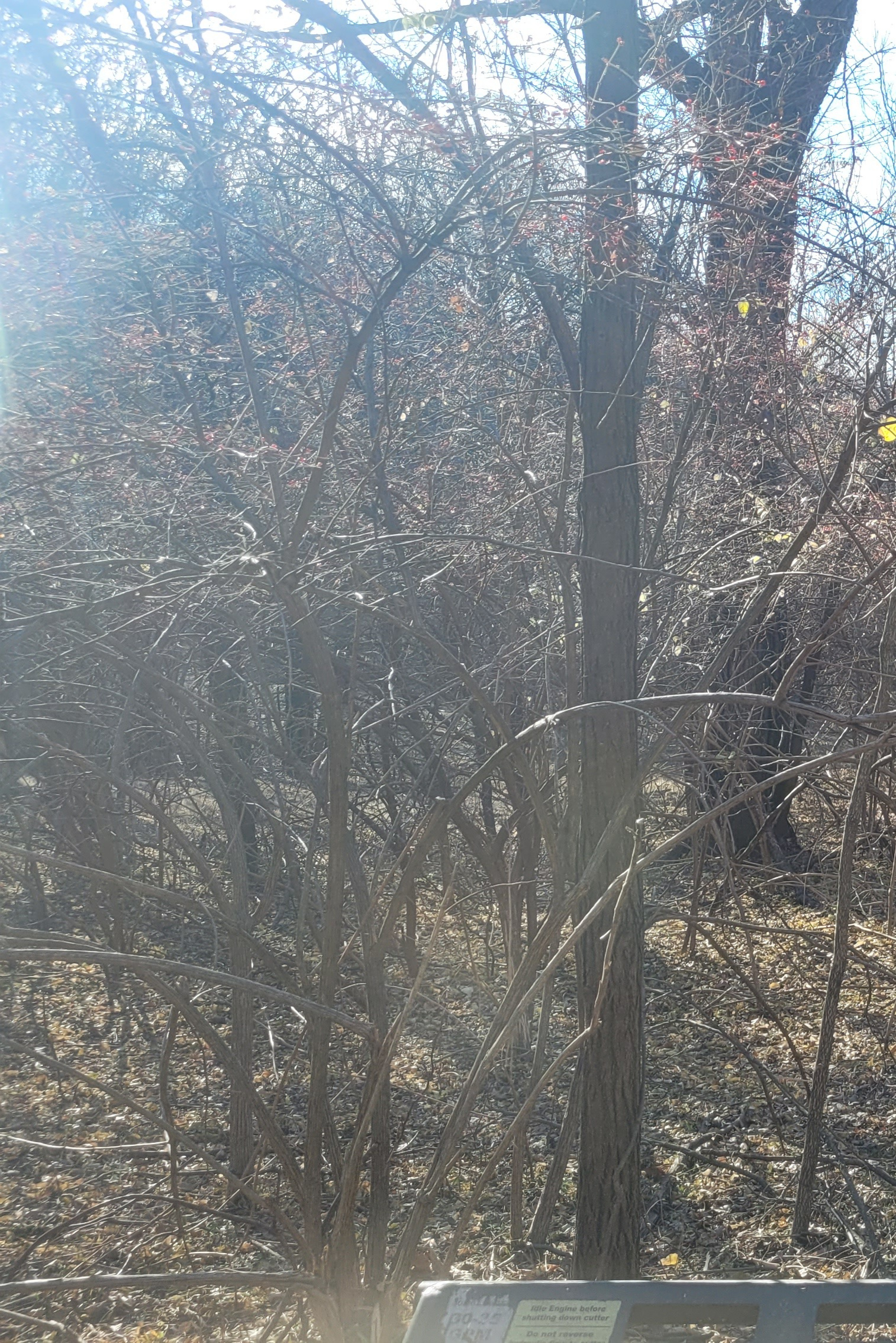

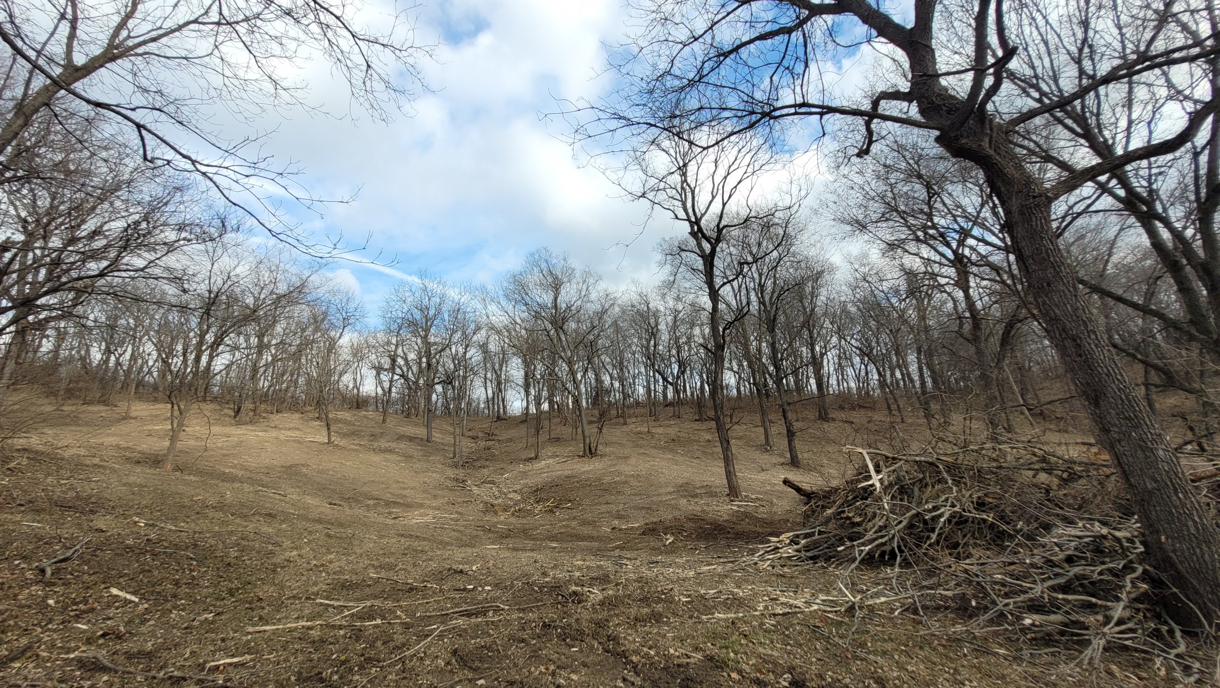

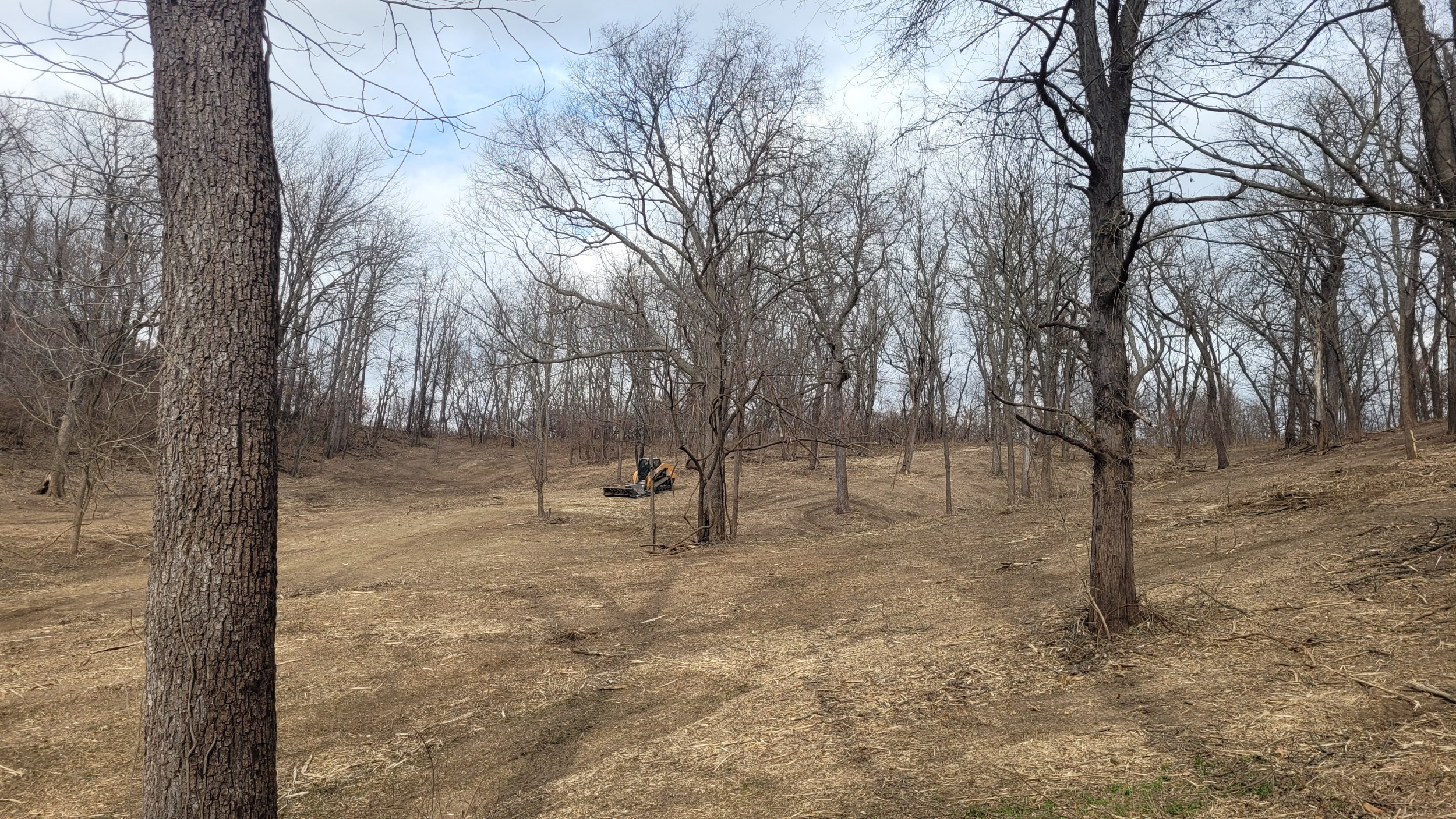

A few pics of a job I just finished up for a friend with something similar. Mostly softwood and a lot of smaller overgrowth in the 1 to 3" range. Everything around 5" and under was cut. 6" to 8" laid over and piled to burn. About 2 acres and took 12 hours to finish. The small stuff goes pretty fast. View attachment 728147View attachment 728148View attachment 728149View attachment 728150
Man, that looks amazing afterwards!!!! I'd love to own some land like that. How much did you charge him? I know, my land has very little on it like that to cut.

Nice work. The people who managed the op’s clear cut harvest obviously were focused on cutting out and getting out and not doing slash management. Also, the slash should have been dealt with by burning before the plantation was established. Now there is only one feasible slash cleanup method: mastication.

$1,380. I charge $115/hr. I run a CID extreme cutter. 84" high flow version with mulching teach on the blade housing.
I only do a few side jobs and don't do it for a living. It's really hard on a machine so I pick and choose my jobs and stay away from ones with a lot of larger mulching. If I can keep the larger stuff to a minimum I can clear a lot of land in a hurry. Keeps the landowner happy for what it costs and makes it easier on my machine. This cutter will walk right through stuff in the 3 and 4" range and can easily take down 6" material. 6" hardwoods get a little slow though, no issues on softwood.

Not bad...I think it would be very feasible for my land to be cleaned up within that time frame.
