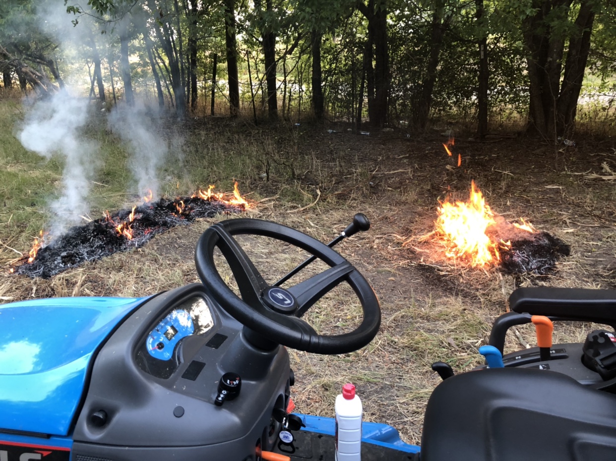

Little morning therapy
Good to know the thorns burn quickly and completely.

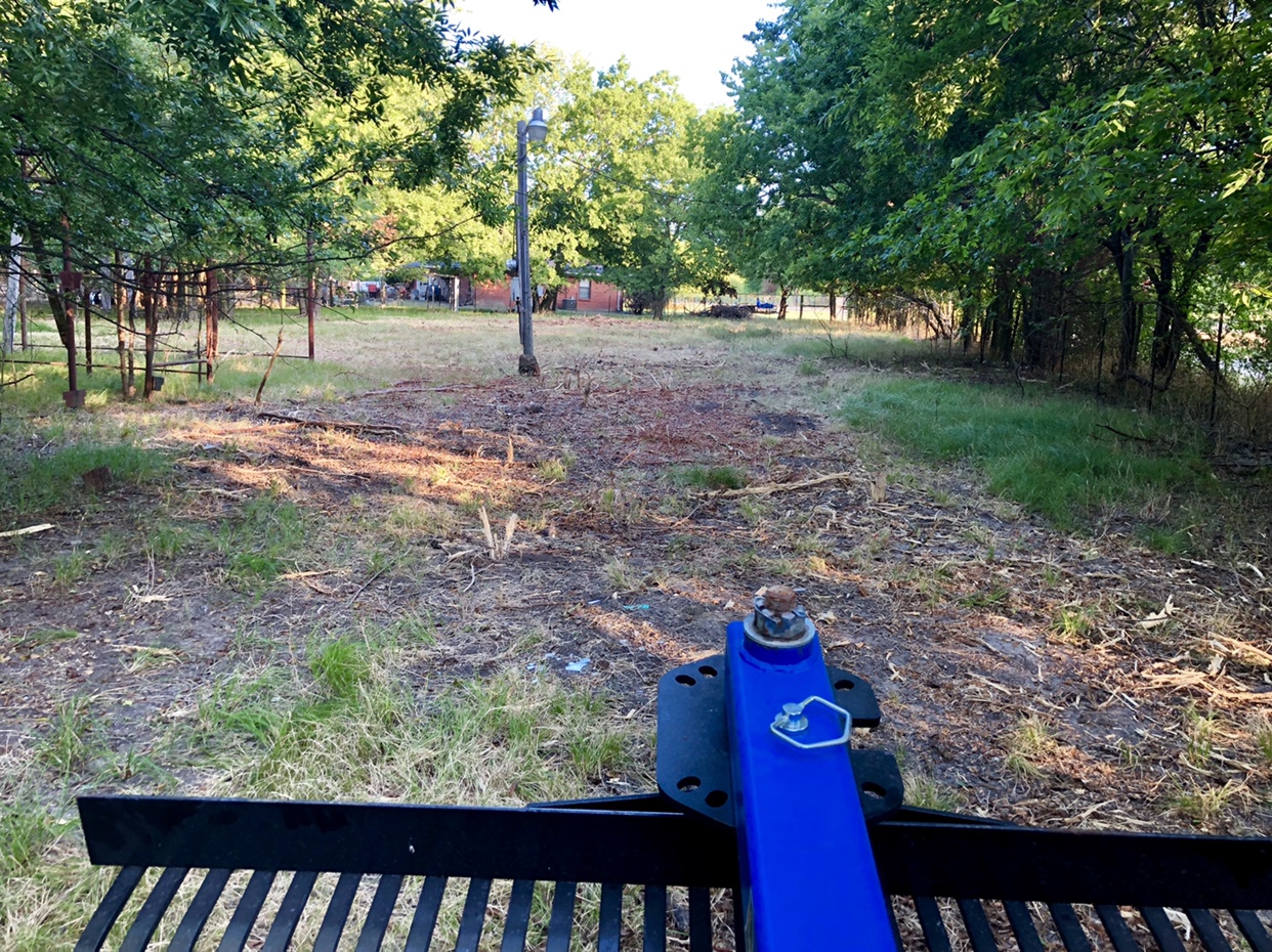

Update: 9mos post forestry mulcher. Very pleased with the results. I haven't been able to find a single shoot coming up so far. I did find about a dozen missed trees that have now been sprayed with Remedy.
I think between spraying the cut stumps and having the browsers they've been mostly knocked out. I'll reserve complete satisfaction for one more year :)
   / Cleaning up 5 acres #20
Looks much better than when the mulcher finished. Hope you have good future results. Jon
