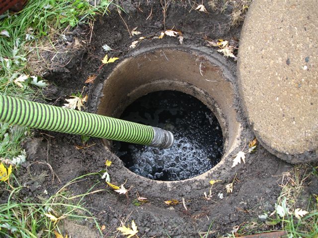

Well, my septic was pumped today. Verdict after 2 years, no scum and only 6 inches of sludge (barely).

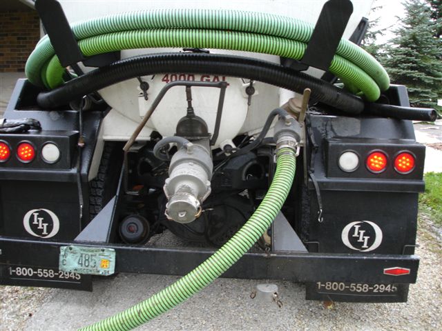

I see your pumper has heated valves on his truck. I have heated valves and heated pump on mine. The antifreeze circulates from the engine to water jackets built above valve to vacuum pump back to coolant system. In winter I plug in block heater and circulator pump at back of truck. It does use up the electricity. plowking

I did not notice, never even thought to look or ask. The fellow who did the pumping was very good and helpful.
He suggested pumping every 2 years. My wife wants it pumped every two years. Me? I want to inspect it every two years, pump as needed and then save some money. I tried to convince my wife that pumping every two years is a waste of money, "like flushing it down the toilet" :D .

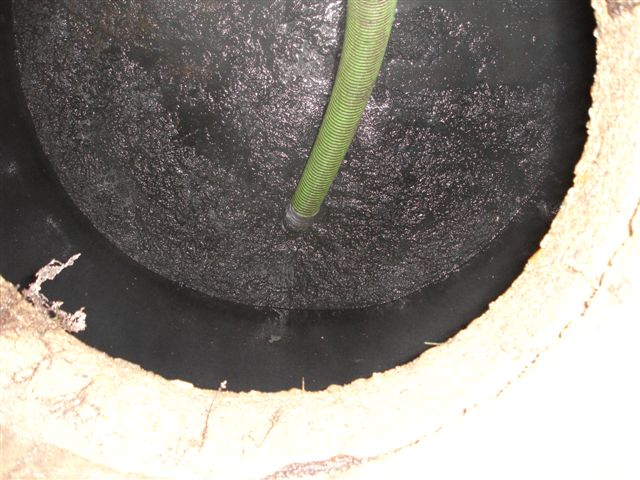

A lot of people don't realize that the tank sits full all of the time with a thick layer of floating scum on top and the mudlike sludge on the bottom. The scum can be dark colored or it can look (and feel) like mashed potatoes. Many folks lift a lid and see the mashed potates near the top and think that it is full to the brim and needs immediate pumpage, not so.
These two layers get thicker over time at the expense of a shrinking center clear zone. The clear zone is in the middle where the incoming sewage drops it's solids and the lighter scums float up to leave a clearer effluent to pour into the drainfield. So, the longer you wait, the less efficient the tank becomes since the active volume of the tank is the clear zone and a smaller clear zone means the sewage spends less time in the tank.
Sewage is so cool. Onsite treament is even cooler. My tank pumper charger by the gallonage of the tank (almost always a 1000 gallon tank here in WA)and will always empty it. They can't only pump the sludge and scum since there is no way to know until the mashed potatoes go away.
