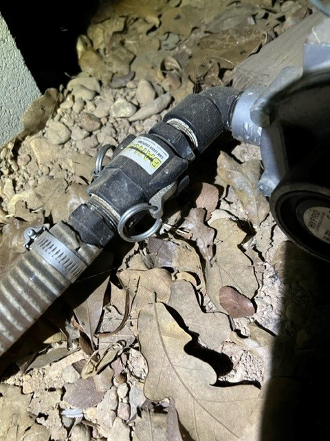

I have a 100 gallon pto sprayer and primarily spray roundup which I am aware is very bad for pumps unless you habitually clean the pump after spraying. I realize that many individuals run clean water through the tank/pump and they place motor oil, vegetable oil, antifreeze, etc into the pump for storage.
With my particular sprayer, it is very difficult to remove the hoses from the barbs that are connected to the pto pump. I am wondering if any of you have rigged up some type of quick disconnect or something similar that allows you to easily place oil into the pto pump without having to go through the trouble of having to disconnect the hoses from the barbs.
Thanks in advance, and pics are appreciated!

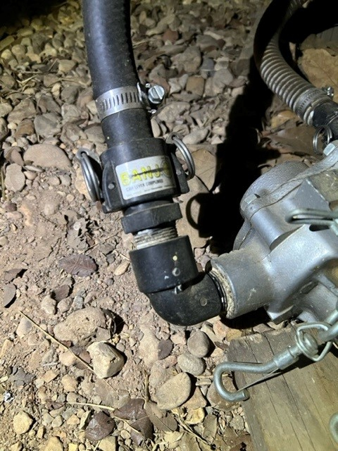

Trook,
I had the EXACT issue. I installed camlocks on my hoses, now it is a breeze to clean everything. The part look like this: (bought better ones locally)
https://www.tractorsupply.com/tsc/product/gator-lock-camlock-quick-coupler-2-in-part-b?cm_vc=-10005
Hopefully, the pictures came thru. Showing both sides of the PTO pump. With these, it is super easy to connect / disconnect the pump completely. So, now you can hold the pump without any hoses attached, dump it out, clean it, and in my case after cleaning I fill it full of RV (non toxic) anti - freeze spinning it by hand to make sure it's full.

Follow-up: I just recalled something. That is/was, the inlet and outlet hoses are different diameter. So the camlock connectors are not the same for each side. In my case, I simply called the place where I purchased the sprayer and they shipped me the correct camlocks. I did use Teflon tape on the threads.
Also, 5030: had said "If your pump is not stainless but cast, it's on borrowed time anyway. Roundup will eventually destroy it"
Been thru (2) blue cast pumps, latest pump is "Hypo silver series" roller pump. I never sprayed Roundup using my cast iron blue pumps, but they still went bad. However, at that time, I did not have the camlocks which made "really cleaning out the pump" almost impossible. I say this because I was NOT willing to un-screw plastic fittings to isolate the pump and instead tried to rinse the tank then run clean water, then add the RV fluid. What a pain ! Plus the amounts of RV fluid I needed to fill all the hoses and pump... Just did not work for me. The cast iron pumps really really need to be cleaned out well otherwise they will corrode and fail.

Actually called 'Banjo' fittings.

Thanks, Spike!! This looks like the best solution I have seen so far.

What type / model of pump do you have ? As 5030 said, and I could not agree more, if you have a cast iron roller, just be prepared to upgrade if you spray a lot of roundup. It is very acidic. But try the banjo camlocks. Makes a HUGE difference, good luck.
